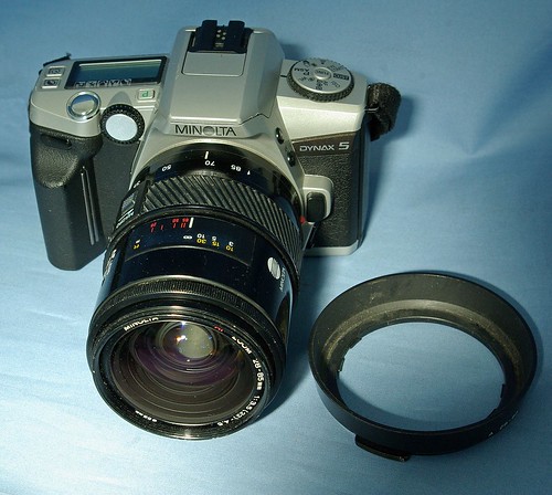

I wanted to give my 'Gift ' Minolta Dynax 5 an outing again but I could not get the back door open to load the film this time.
I pressed the Release button and pulled but it would not open -- I tried with and without batteries -- I ended up loading my Dynax 40 instead which does not have that dreadful back lock device .
Minolta Dynax 5 by Peter Elgar, on Flickr
Done it !! I had to press release hard at same time lever back gently with small screwdriver in a slot in the polycarbonate back and it opened! i have now lubricated the catch with minute amount of Vaseline and it opens much easier now !
