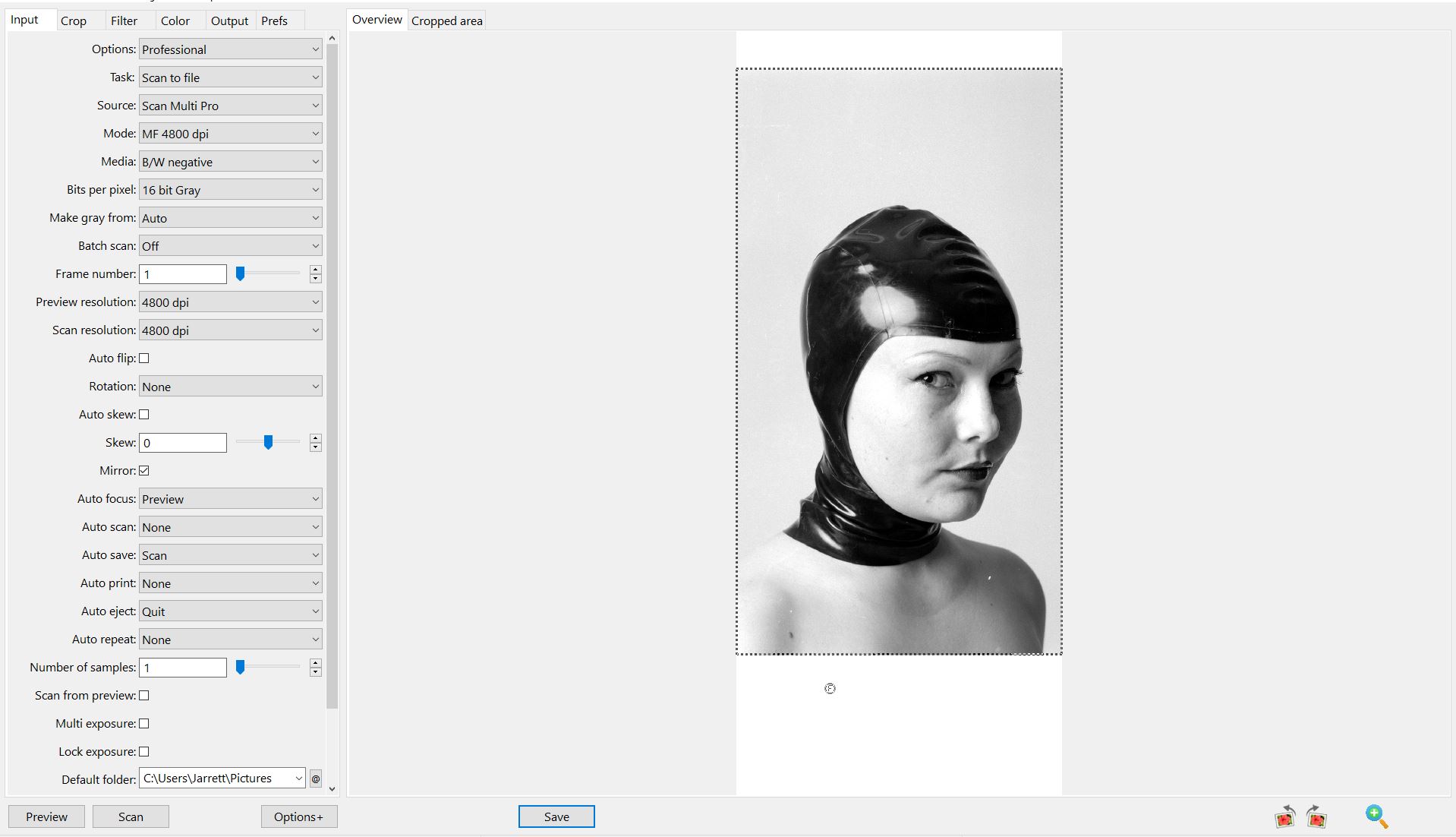

I'm having issues with my Minolta scanner. When I scan at 4800 dpi the photo is cropped, but when I scan at 3200 dpi everything is normal. I restarted the scanner and the computer twice. Does anyone have any solution for this?
I'm using Vuescan on windows 10. I have the original software, but I can't get it to work on Windows 10 so I'm using Vuescan.

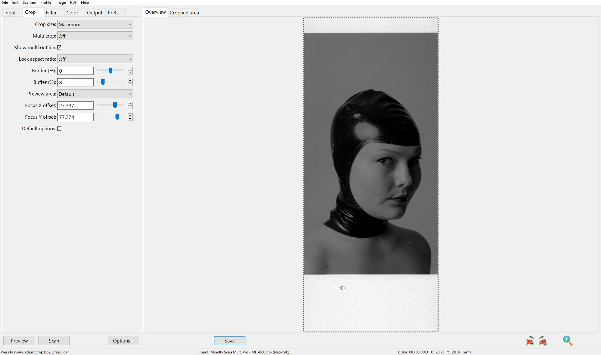

What setting are you using under the "Crop" Tab?
MattKing
Apr 24, 2005
52,037
Delta, BC Canada
Did you try setting it to "Maximum"?
Can you show us the settings under that Tab?

It seems I got this wrong because of Vuescan's menu options. I saw the option for 4800 for medium format so I thought that the scanner would give 4800 for 120. But it seems like this option should be disabled for 120 in the menu. I had to dig through the menu and found that 3200 is medium format and 4800 for 35mm.
