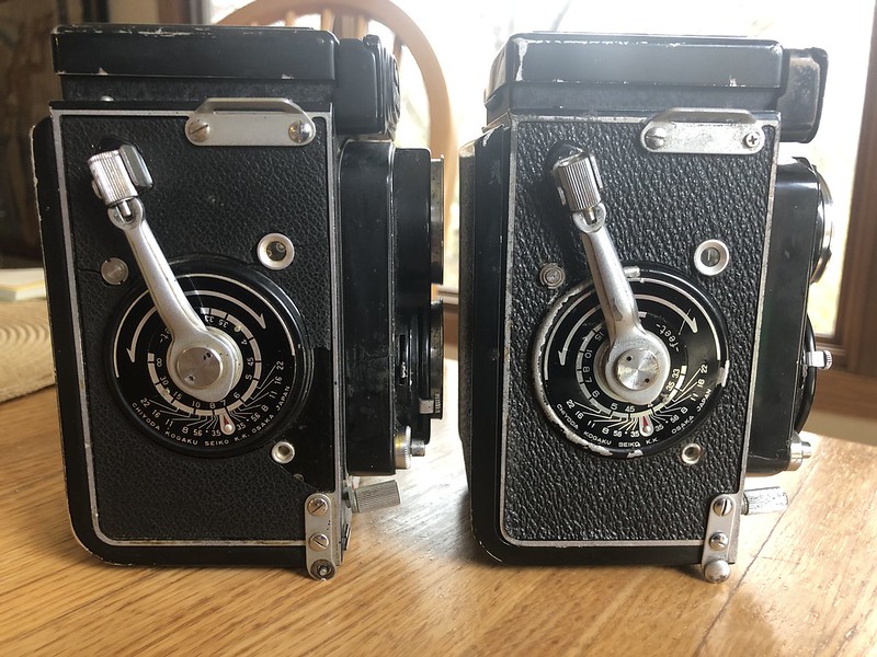

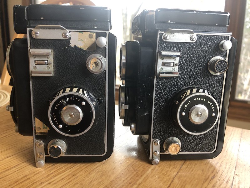

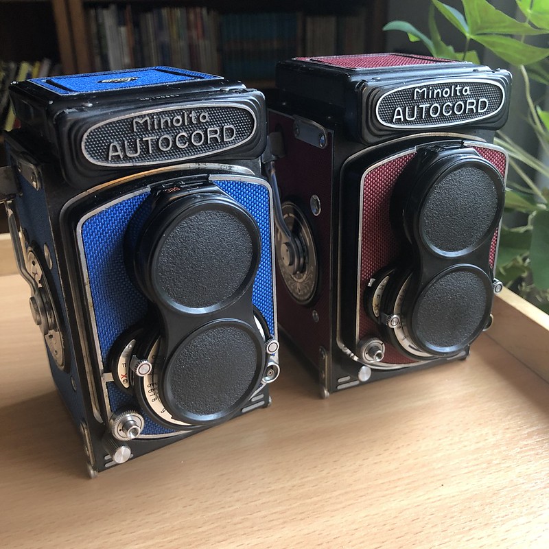

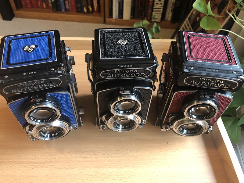

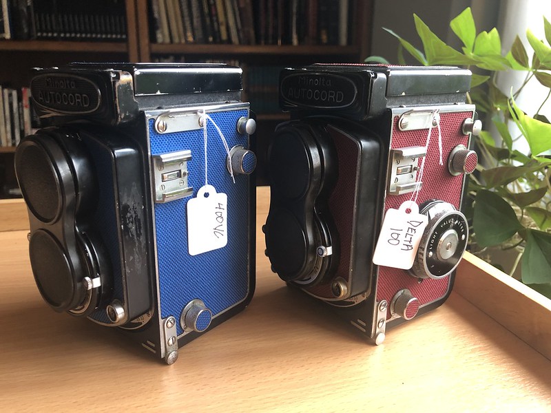

Couple of weeks ago I picked up two Minolta Autocords (each a metered L-MX model) off the Bay.
Autocord on the left was in rough cosmetic shape, but it fired. I put a roll of film through it, and concluded that the shutter speeds were off as the exposures weren't all that great. Also, every control lever was a bit stiff to move, including focusing arm (which was bent), shutter/aperture dials and film advance.
Autocord on the right was in better cosmetic condition, and while all controls were smooth, it wouldn't fire.
Sent them both off to Karl Bryan, who indicated that each was fixable. So, I had him do his magic. I also had him install new "leatherettes" purchased through Camera Leather (these are in fact not leather, but from their "textiles" line).
Got the cameras back a few days ago. They look gorgeous. All controls are smooth as butter now. On one of them, the meter was no longer working, so Karl removed the meter on the side (as well as the side plate) and converted it to a "non-metered" model (though the sensor cells were left as-is).
And here they are with my other L-MX Autocord.

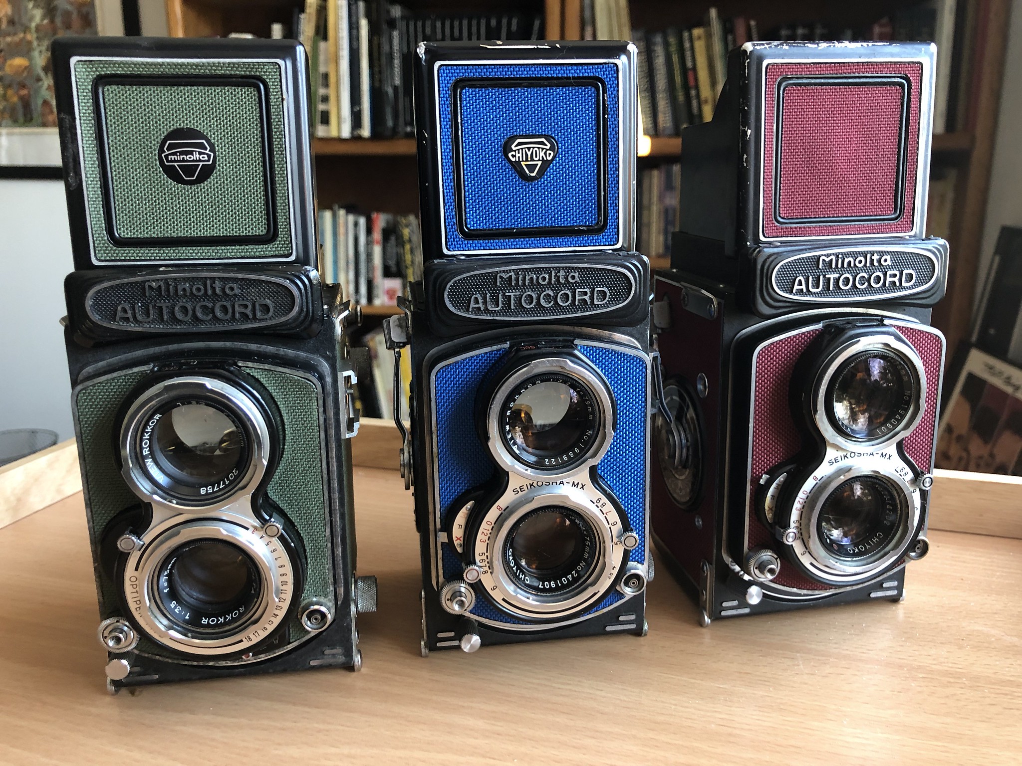

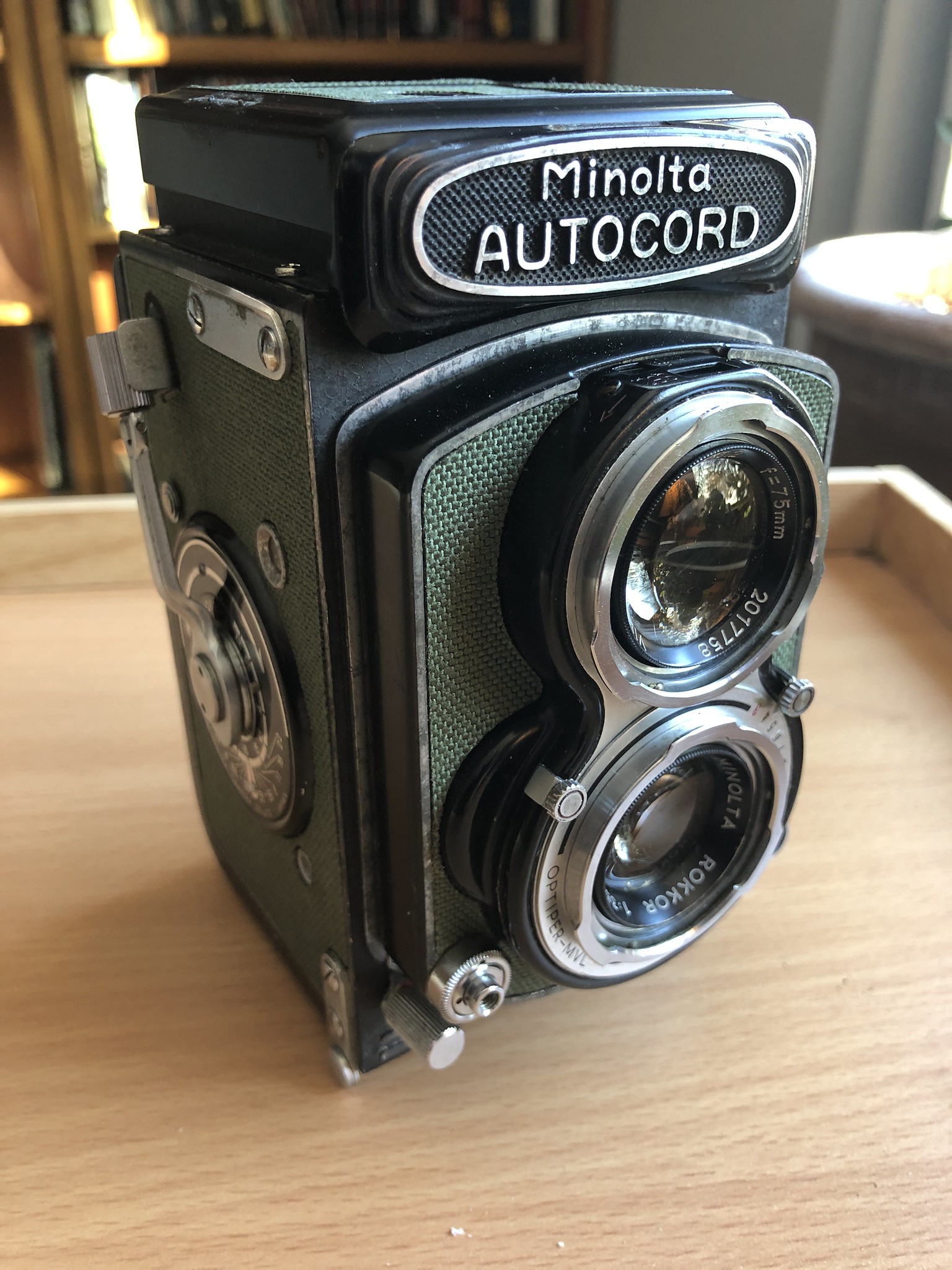

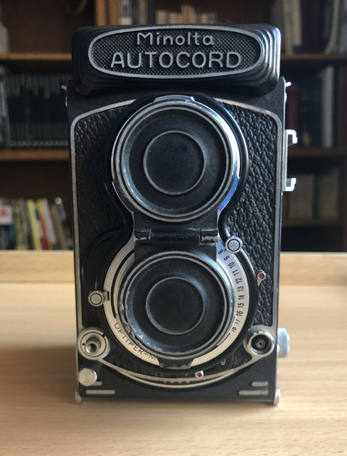

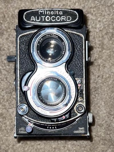

Well.... I guess three Autocords wasn't enough. Picked up another one. This time, this one appears to be an RG-2 model (with an RG-3 viewfinder top).
Here are the "before" photos...

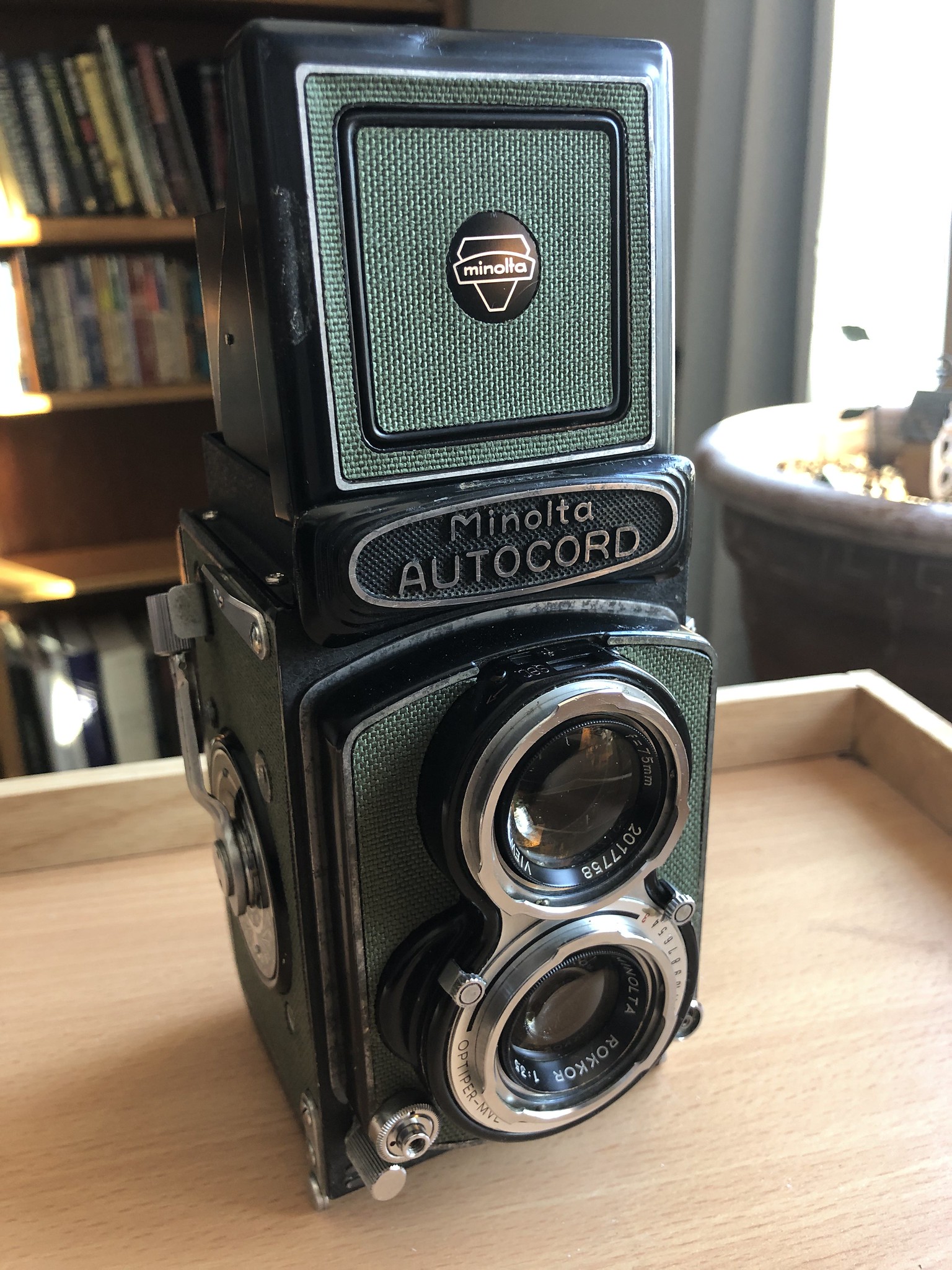

I once again sent it off to Karl Bryan, who essentially overhauled it and got it back into tip-top shape. Also had Karl install a new fabric covering in Parade Green from CameralLeather.com. Received the camera yesterday.
Am quite pleased with the results...

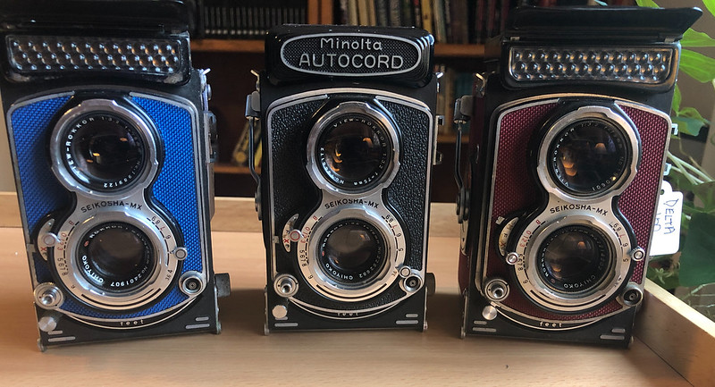

And a photo of all three Autocords I've had Karl Bryan work on to date...

Might be the green I have on my Autocord. I like the feel of that fabric covering from Cameraleather. A little tooth from the weave and the acrylic topcoat (and I hadn't noticed that the fabric weave is a close match t othe background of 'AUTOCORD' name badge).

Yes, looks to be the same "Parade Green" covering. I believe there are two (or three) other "greens" to choose from, but I went with this one because it was a bit more subtle. And yes, I do like the feel of the fabric coverings. In retrospect, I'm sorta wishing that I had taken the time beforehand to repaint certain parts of the bodies, mainly the hood and the back plate, including stripping the old paint and putting on some new coats. Sort of difficult to do now with the possibility of damaging the new coverings.

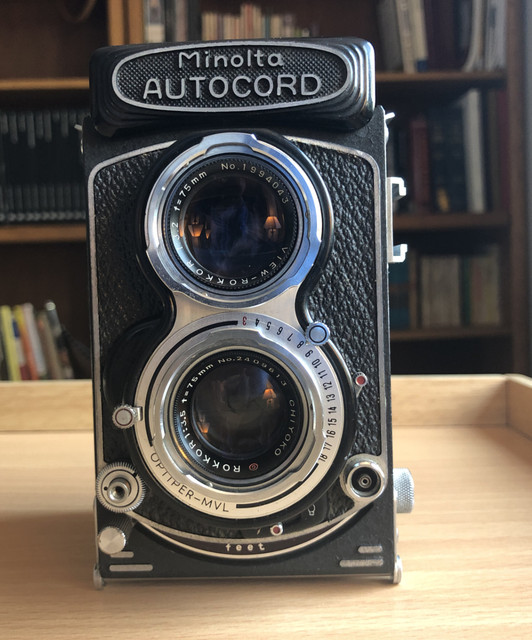

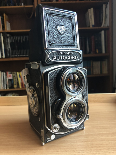

Well.... that didn't take long.
Another Autocord arrived today fresh from a Karl Bryan CLA. This one appears to be an RG-2 version with Optiper MVL shutter and Minolta Rokkor taking lens. Leatherette on this one is still in decent condition, so left it as-is. This is my first Autocord that has a working self-timer! Also came with a Minolta lens cover.
BTW.... there's two more in my possession to be sent off to Karl. :cool:
