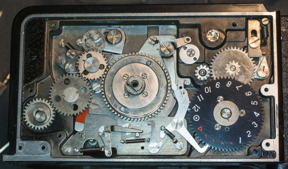

Anyway- film in camera? Than you have a jammed or broken mechanism inside the wind side. There are small levers that should drop/be pulled into a locked position when the wind action is completed; sounds as if yours is not going into place. If the winding is going ok, sounds as if you can still use the camera but just remember to not wind until after a shot.
The interior of the camera- the levers you need to be concerned with are to the bottom and right of the main wind drum.
Just wanted to say that your photograph helped me fix my autocord. Thanks!
