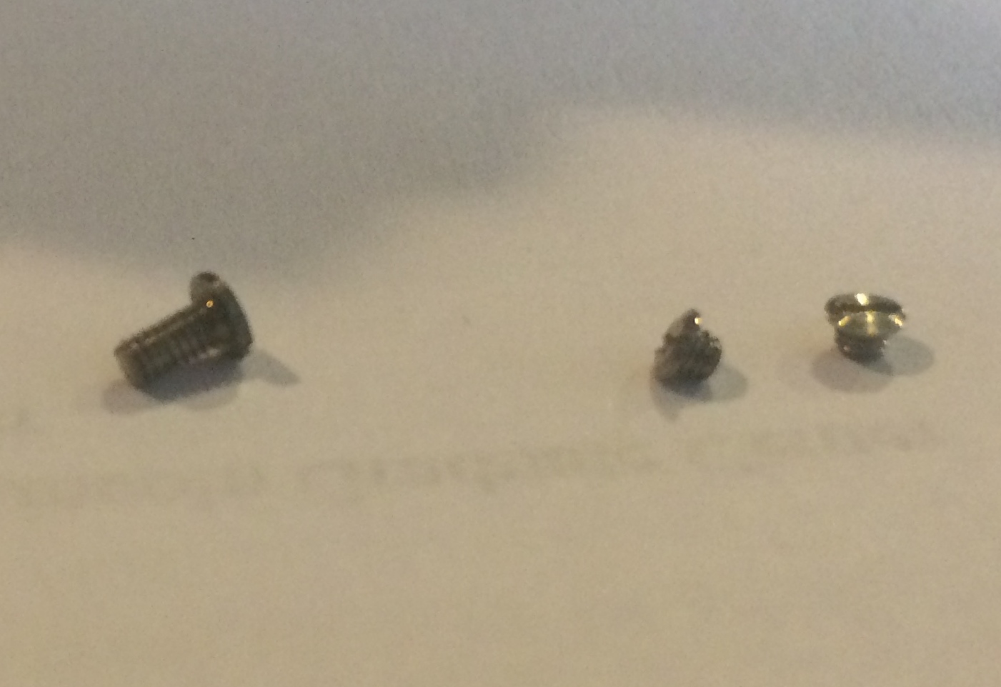

I recently acquired a Minolta Autocord tlr from a yard sale, it's the first film camera I have ever used. Unfortunately after shooting a couple rolls of film through it I realized that the shutter was stuck at 400 and an aperture blade was mis-aligned, so I completely disassembled the camera and cleaned it. It took about three days to do the whole thing. Now it is all reassembled and seems to be working perfectly.
The only problem is I ended up with two tiny screws that I cannot figure out where they came from. I have re taken it apart again and cannot figure out where they came from so I’m hoping maybe somebody familiar with this camera may know. I’ve attached a photo, the two screws are on the right and a screw from the body on the left for size comparison.

Just a guess, as I do not know the Autocord: the smaller ones look like being intended for thin sheet metal like a cover, scale etc.

"big screws"? They look to be about 1mm long by2-3mm across the head. Something to hold sheet metal together but not mechanical.
