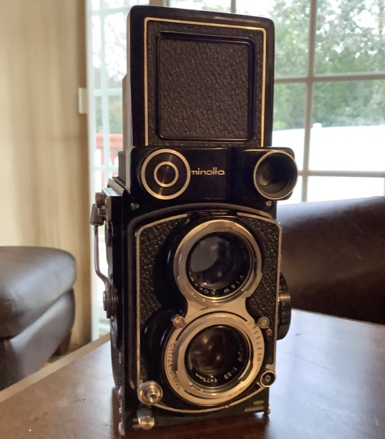

Just came back to film photography and found an old Autocord given tome years ago. Glass looks good, focus arm is intact and is functional, although it feels a little dampened. Sport finder and film counter do not work. Shutter sound like it works, and meter tests ok. Looking forward to using after finding someone to perform a CLA and whatever else is needed.
all comments / advice is appreciated.
thanks, JDR
Film counter will only work if there is film in the camera. Or you can use backing paper only as a tester. The wind action happens in the bottom chamber while the silver gear in upper chamber, left side, is actually driving the counter forward.

Just out of curiosity.......when the camera is empty what should the film counter say? (0 or 12?). BTW, the Autocord is being packed and sent to Karl this morning.

It should reset to 0. Opening the back allows a spring-loaded pin to come out. It may be sluggish if the grease in the reset mechanism or pin dried up. By the way, Karl Bryan did a great job on my Autocord a few years back. He also installed new leatherette for not much money and it was well worth it. In both Autocords that I have owned, and from what I've heard from others, the leatherette has a tendency to unglue, dry up and flake off.
Also the wind lever needs to be in the rest position, about 11 o'clock.

Thanks Dan. You’re right. I sent tithe camera to Karl and emailed him to let him know. I mentioned the issue and he said likely to be a spring tension adjustment or some other issue. Whatever it is he’ll take care of it. Karl’s stellar reputation is well deserved. Having shot 35mm all my life, I’m anxious to work with a larger negative.

Well!I got my Autocord back today and you were all correct. Karl did an amazing job, CLA, fixed the counter and other things that I wasn’t aware of. Now the focus is smooooth with minimal damping. The viewfinder is clean and bright. Very reasonable and quick turnaround. Awaiting the film that I ordered then it’s time for a road trip.
