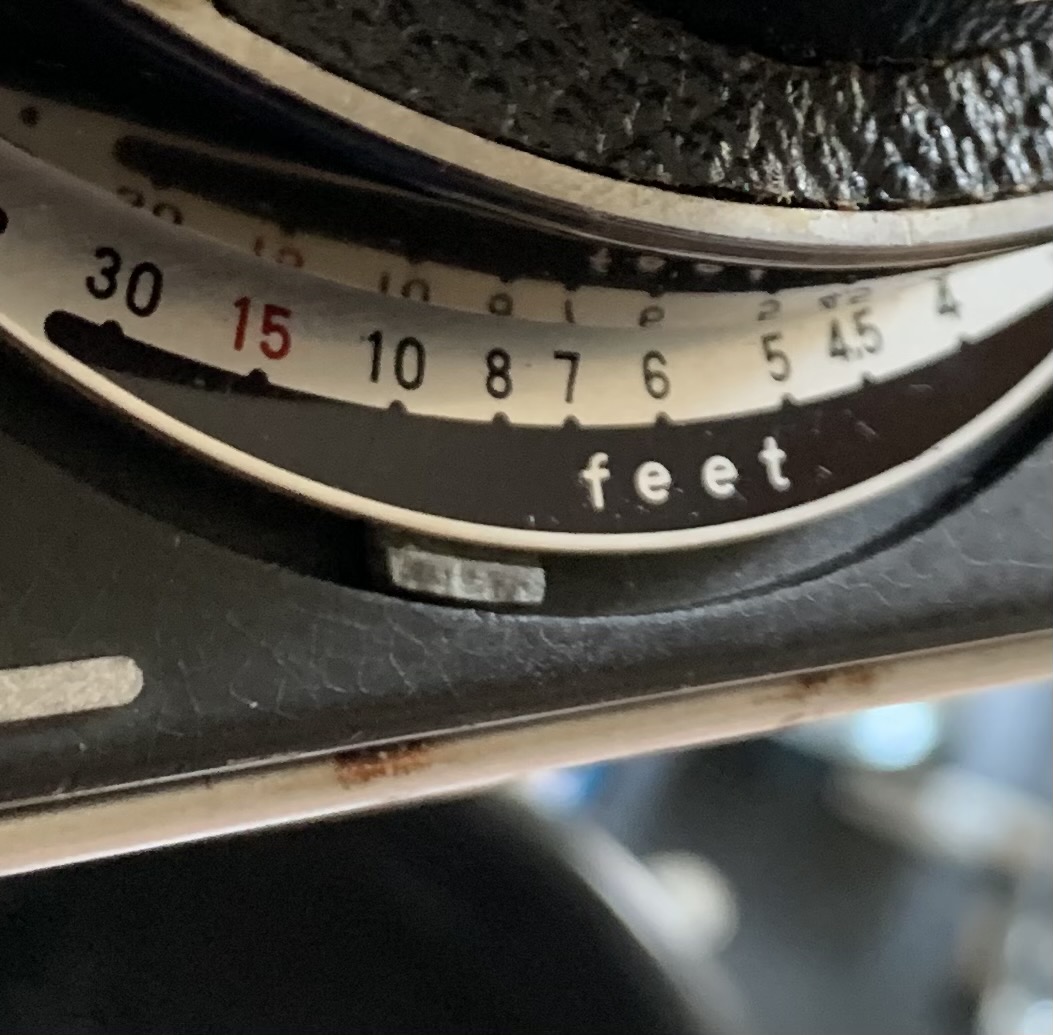

Sure. Not really looking to try anything elaborate repairwise, but you never know. I've been focusing with my fingernail (or a toothpick) since it broke!
If you remove the focus scale, you get access to a much larger area. Can even try gluing a tab on the lever.
Just be certain to cover the two screw holes that hold on the scale. The holes go all the through to the film chamber so need to be sealed. Simply putting the scale screws back in without he scale will take care of this.
Hmm thanks; I was wondering if it was safe to use the camera without the focus scale. I imagine going without it would increase some dust risk?
No risk. When you focus close and extend the lens board. you'll see the brushed silver walls around the sides and top. And at the bottom; the silver part is basically a tray that sits just inside the lens board. So any dust needs to travel up the tray walls and then go mess things up. Focus scale doesn't affect this at all.
But to repeat, you need to seal the two holes, one at each end of the scale. they are drilled through to the film chamber. A good way to save the original screws is to use them as plugs.

Well that's really good to know! I appreciate it. I'm going to keep the camera for at least a few more rolls, especially since I just read about the Rick Oleson split-image screens that might go some way to counterbalancing my poor focus skills.
