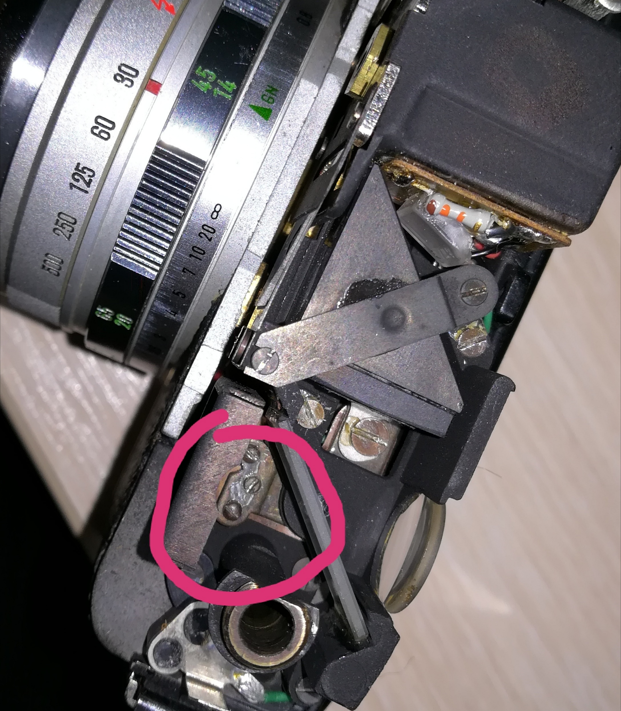

Hello everyone! I have a Minolta Al-F in really good condition. Everything is working smoothly. The only problem is that the rangefinder isn't adjusted. There are three screws. I can adjust it for near object but for away object and infinity it does not get adjusted. I can adjust both vertical and horizontal for near objects. For infinity the both aren't get correctly. Can you help me? Should it be like this or i am doing something wrong? I don't have this problem with my other rangefinder cameras. Thank you :smile:
