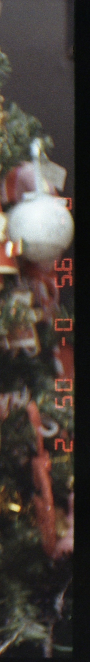

I was so excited about, uh, repairing my camera that I went and bought one of these. It's the thing I was probably most excited about with the 9000AF. I've not had a chance to really use it in anger though outside of the data stamp with exposure info.
Right side of the imprint, about the full height of the negative. Colours of the might not be representitive of a good exposure, this is a roll of colorplus200 I decided to try pushing to 800iso after noticing my 9000AF still wasn't functioning properly and removing it to put into another camera.

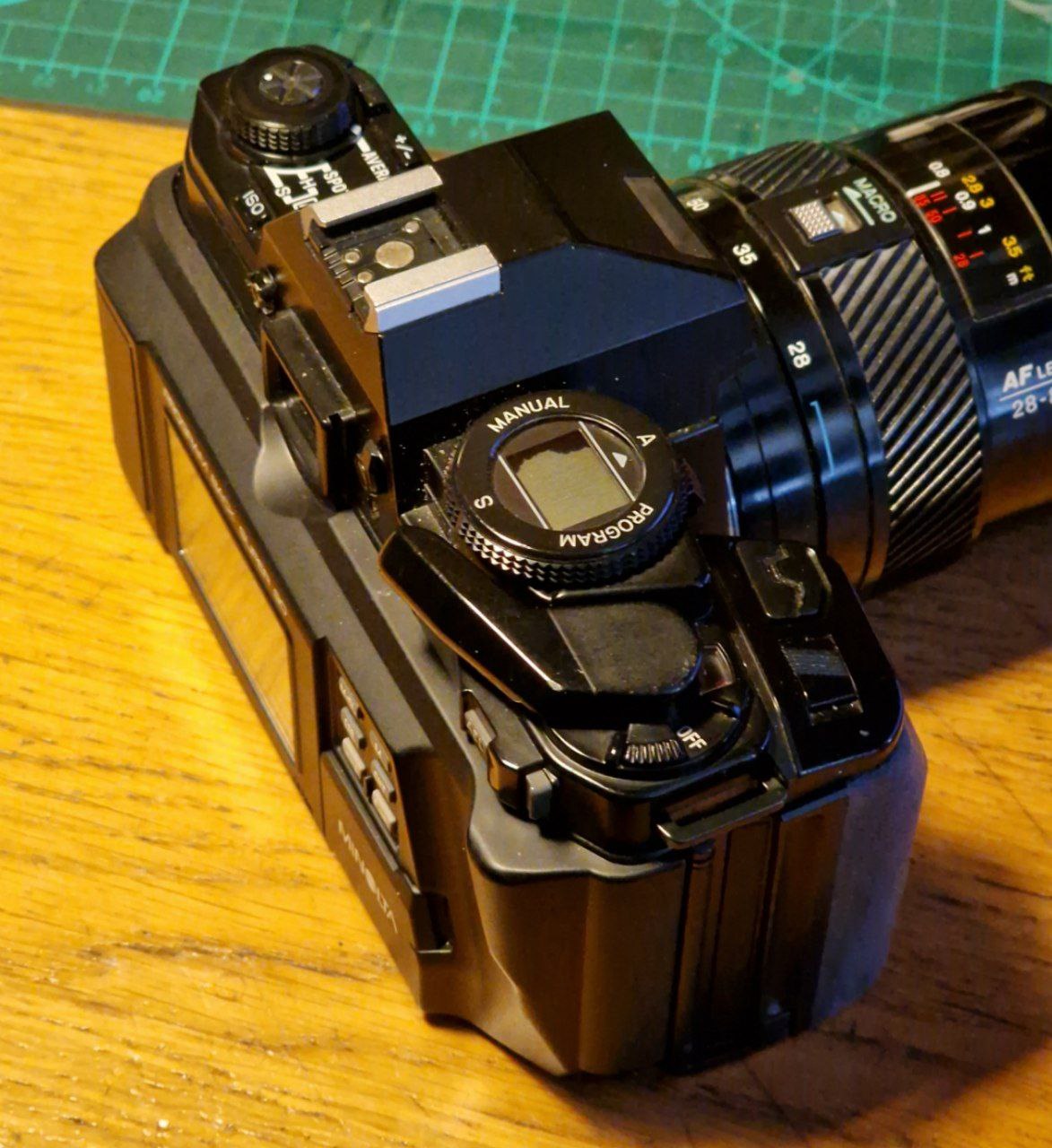

my lovely chunky camera. i guess you'd describe this camera's style as greebled

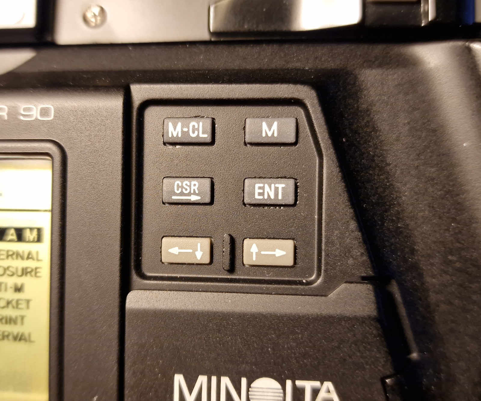

close-up of the data back's buttons with chipped edges on the shell around the buttons. or maybe it's the mould not fully filling rather than chipping
I think i'd have to use it more to give a proper review, but the first impression was that it's quite chunky and makes the camera a little more awkward to handle without the motor winder on - like I feel my thumb wants to ride up higher and i'm fighting to keep the thing afloat with my little finger. Although my not 100% faithful recreation of the old front grip out of sugru could be contributing. It's also a shame that it loses the little window to see what film you have loaded in it. The plastic is a different style to the rest of the body and accessories, with a gritty possibly glass-filled feel to it. There's also some chipping around the buttons that were probably there from the factory. Maybe an artifact of this being a low run item?

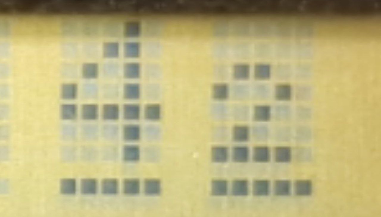

The LCD is a little on the pale side. Seems this is a result of age though and there might be ways to improve it. But yeah the user interface really is kinda weak. The big problem with it is that it overrides the two jog sliders on the main camera body, so you have to use those little rubber TV remote buttons on the back to adjust aperture or shutter values. With the pale LCD its also a little hard to see exactly what you have selected. The in-finder LCD and top LCD do reflect the selected value... sort of. The back operates in quarters of a stop but displays them as like...
big 4 with a smaller 2 next to it, LCD style
with the 2 meaning 2 quarters of a stop more than 4. But this isn't reflected in the other LCDs so you'd just have to try keep count if you're looking through the viewfinder as you change values. It also means you've gotta mash them buttons quite a bit and I don't believe there's any setting to change the increment value.

I'm complaining about it a bit, but I still think it's very cool. I especially like the graph showing the exposure value distribution of all the recorded spot meter readings. I'm not sure if any other camera does that. The UI isn't really too complicated either and you can figure out most things (maybe not the bracketing) without a manual. But you should still probably temper expectations if you get one.
