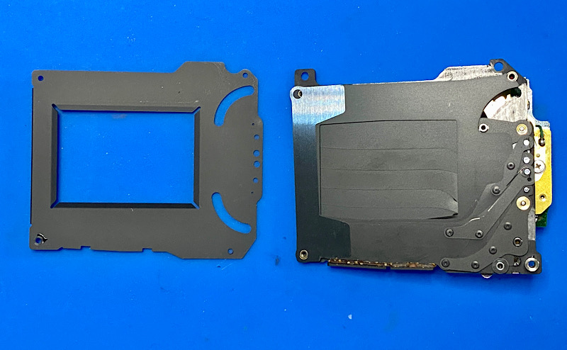

Here you can see the shutter unit from the rear and the front shutter curtain.

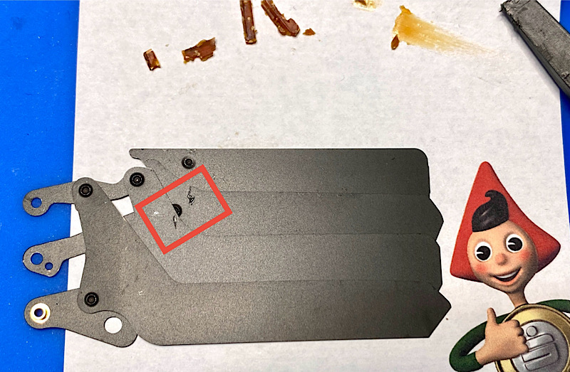

The two arrows point to material that is sticky and can be found in traces on the rear shutter curtain, which is folded under the bottom frame of the shutter unit.
Further disassembly.

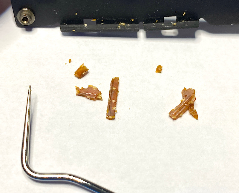

The reason for the sticky contamination is clearly visible: a damper in the lower part of the shutter unit that has decomposed over the decades.
Here you can see the sticky dirt on the rear shutter curtain.
The remains of the damper are sticky, but the consistency is viscous. This means that the damper can be easily removed in this state with the pointed probe.

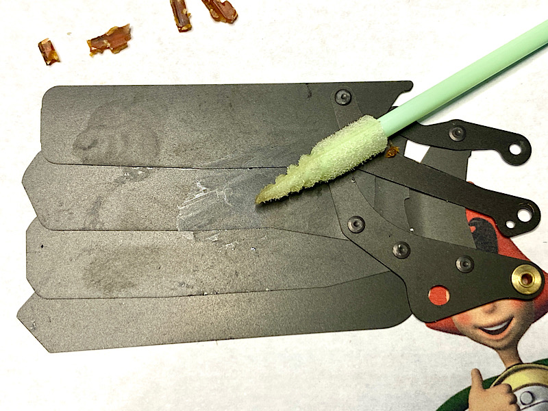

Cleaning attempts on the rear shutter curtain, which can also be done with the camera assembled
To do this, the shutter must be cocked so that the rear shutter curtain is pulled up.
For cleaning with cleaning sticks I use isopropyl alcohol, Zippo lighter fluid and acetone in order and at different places.
Isopropyl alcohol …
… Zippo lighter fluid …
… and acetone.
Of course, you shouldn't use plastic cleaning sticks with acetone, like I do here … 😳
Zippo lighter fluid on cleaning sticks worked best, but isopropyl alcohol and acetone also did the job.
Since there is no plastic in this part of the shutter and the shutter unit is mounted on a die-cast alloy, the sparing use of acetone should be safe.
Sticky dirt can also be seen on the front of the rear shutter curtain, which is accessible when the shutter is cocked and the mirror is lifted.
Alternatively, I would try putting one drop of Zippo lighter fluid directly on the shutter curtain. This should spread the Zippo with a few shutter releases and at least neutralize the stickiness.
But the lighter fluid should not act directly on the rotting damper so as not to liquefy it, which would aggravate the problem.
The front shutter curtain can be accessed when the shutter is released (from the back and from the front, with the mirror raised).
The current consistency of the damper: viscous and sticky, but not liquid.
Fine springs are hooked onto the closing curtains.
Unfortunately, you only have this much control when cleaning the shutter when it is removed.
