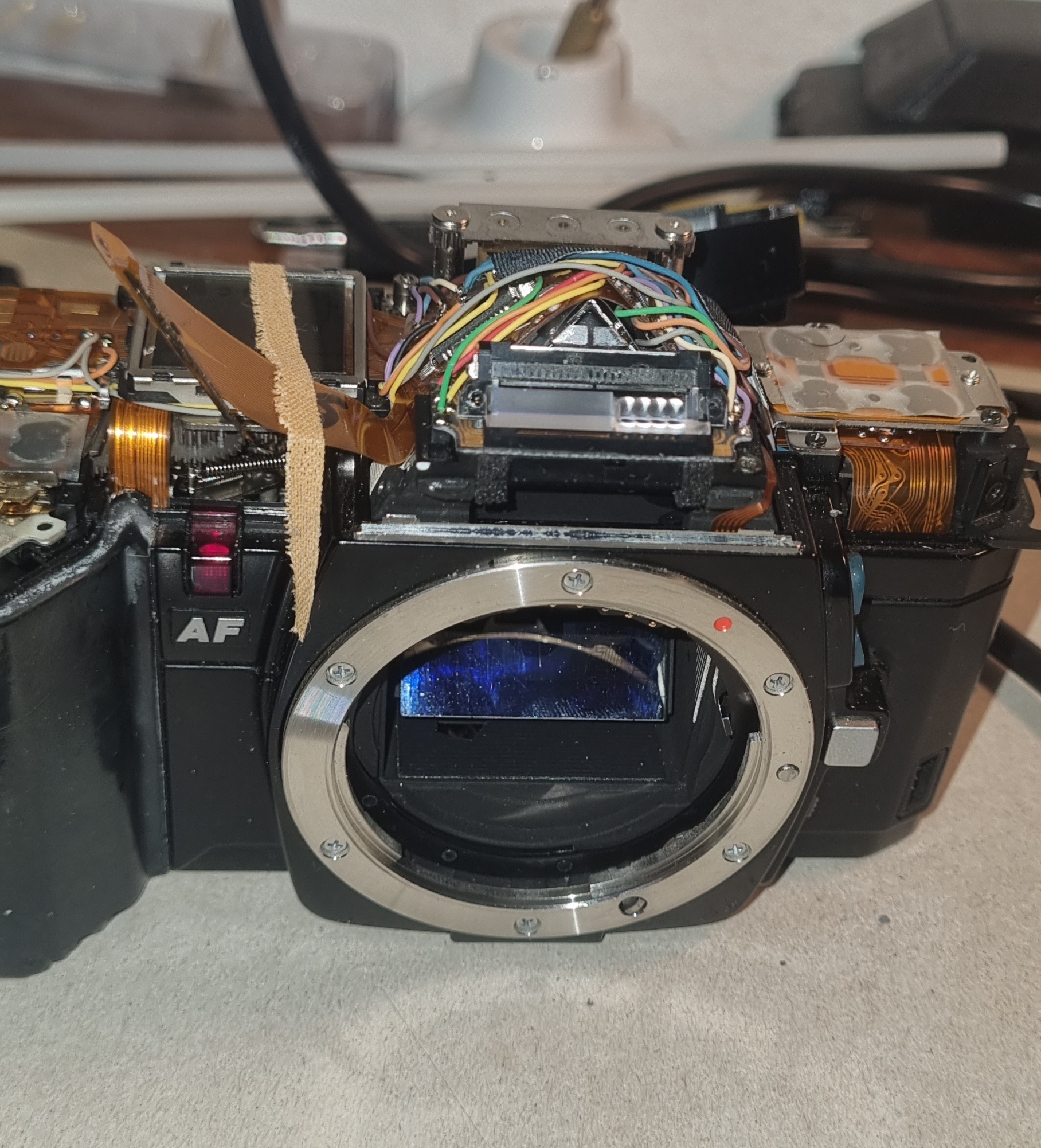

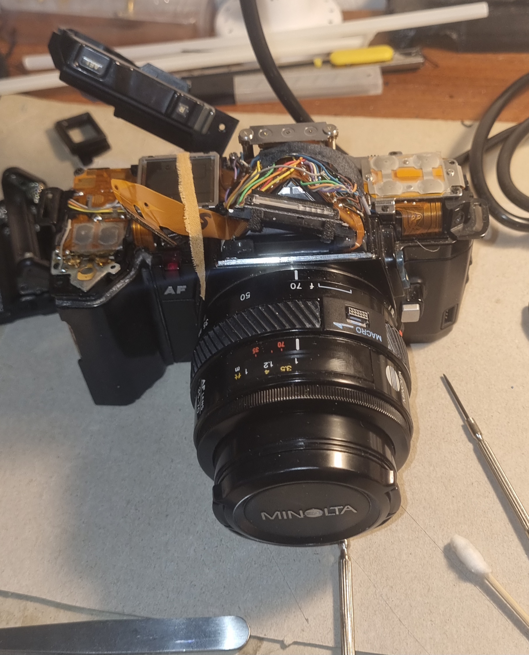

Greetings, i recently bought my first 35mm SLR, an early, crossed XXs, minolta maxxum 7000, probably an 1985/86 model, it works... fine, but the viewfinder didn't display anything, no lcd panel and no arrows, upon dissassembly the two tiny mirrors fell out, what i need to know is how do they go back together on the camera, i can see the tiny screen working, and the tiny arrows, i need to know how should i align it inside the camera

Post pictures of what you are doing, so we can help you figure out the issues at hand.
well, i do have the service manual pdf now, i managed to get it, what i also found, aside from the mirrors, there was a loose wire (blue, right side of viewfinder LCD holder, behind white and purple) that i managed to reweld, and she started doing maxxum things again, i just have to align the viewfinder now, but it's all working now, now what i do not enjoy is asking for help hoping for some valuable insight and being told to "buy another one", y'know, that's why we have huge piles of trash laying around worldwide, these cameras are getting to their 40s, and they were really packed tight with electronics, they will, as all things, need service, imagine losing valuable time that i could spend learning/fixing to read "just buy another one", but well, i do appreciate any more insight, things to look for as i go, and things to learn, if you have knowledge and are willing to share it with me, please DM me, i would aprecciate it very much
