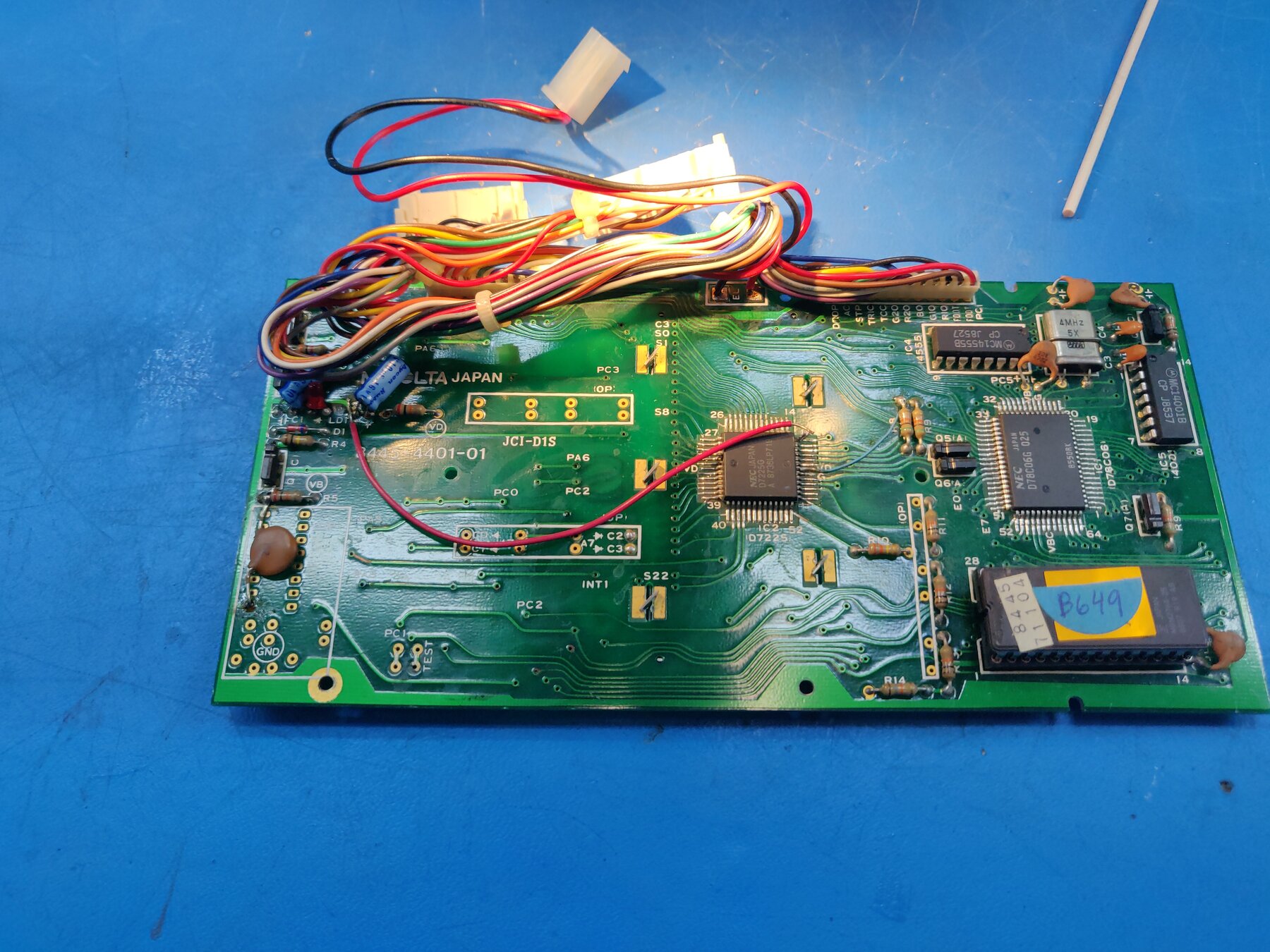

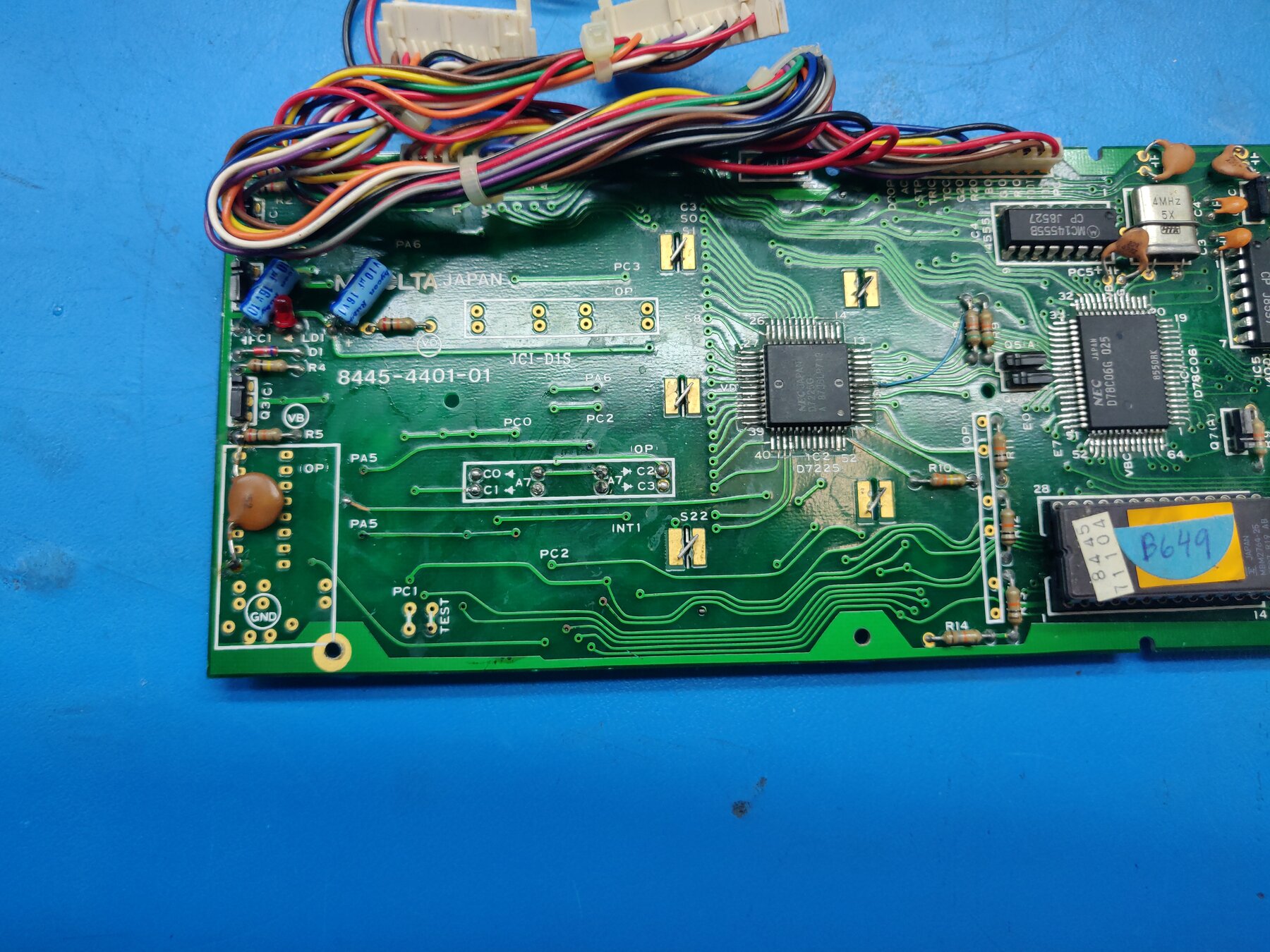

I open the control up and removed the control board. What a mess. Corrosion on the button contacts, a couple traces in bad shape. I clean up the board, removed a wire hanging across the board after figuring out it was bypassing a bad via. I fixed the via instead. I cleaned all the crud off the button contacts and put the thing back together. low and behold, it now works, focus tube fires, the exposure tubes fire, nice.

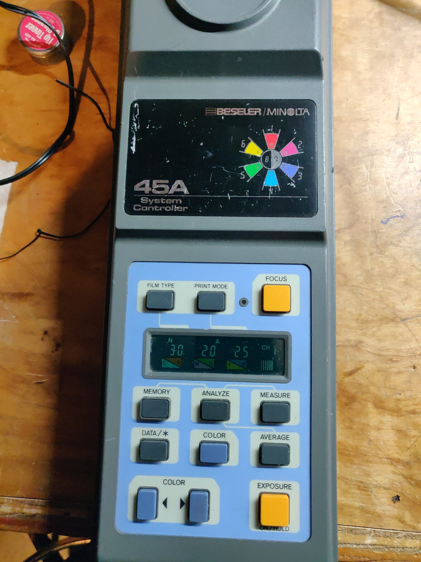

I take it apart again and that it uses an EL backlight. The inverter was working, so I remove the EL panel and set it aside. I ordered an EL panel from Amazon and it came today. I cut it down to size, seal the edges with CA, and make some solder tabs for it. I slide that under the display, solder it to the inverter power pads and power up. Now it has a working back light.

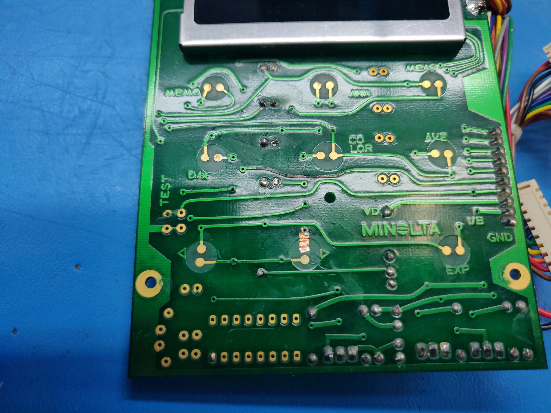

I found one of the button pads was too corroded and was very flaky pressing. So scrape the remaining button off the board and cut a piece of copper tape to take it's place. I solder it and glue the edges and put things back together.

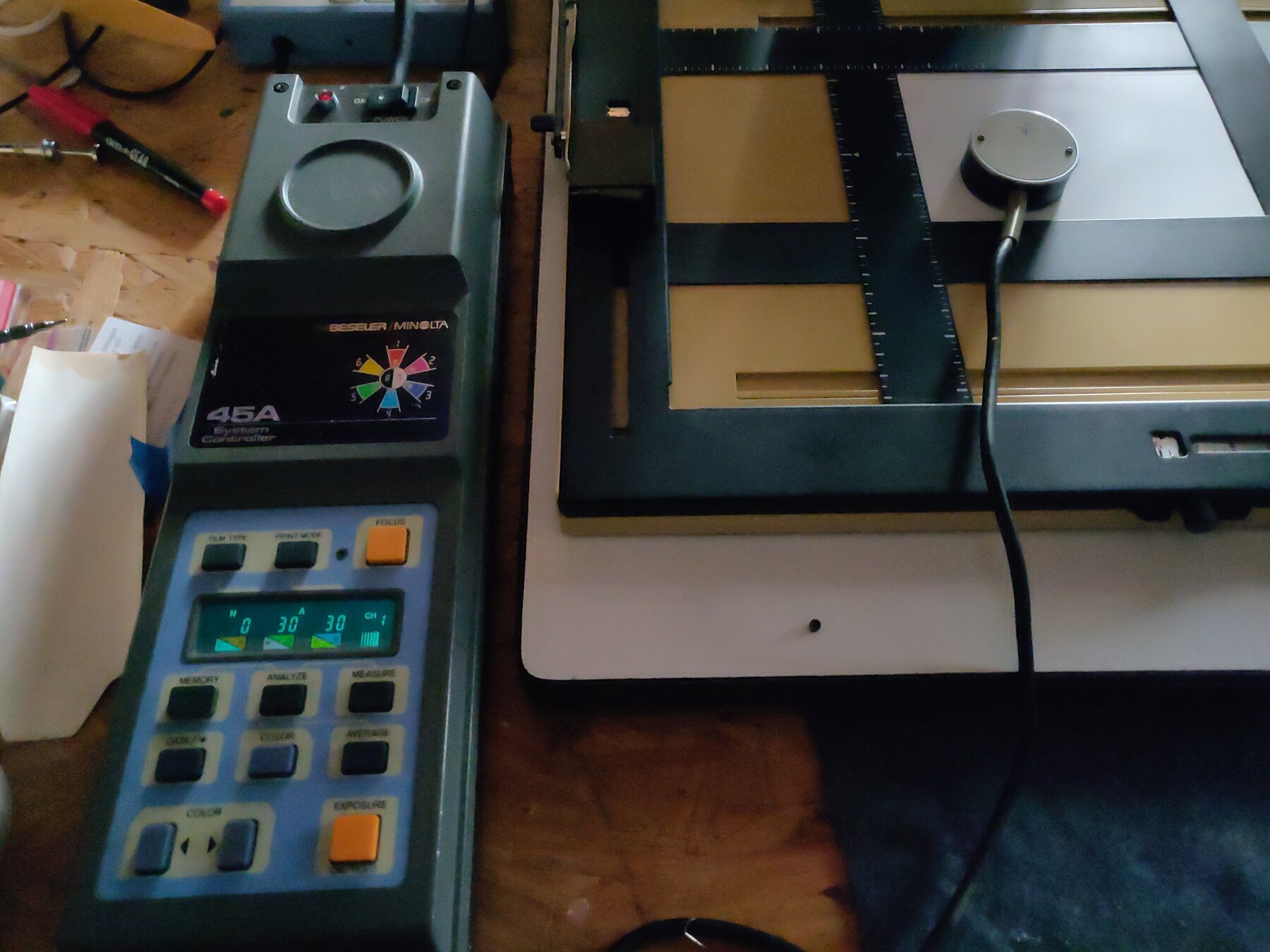

I have tried the basic functions and everything is working. Some functions I have not gotten to wotk yet, but might be because I don't know how to make them work. I'll go through the manual and see what I can learn.

This morning I tried the probe, figured out enough to at least see it works and it does.

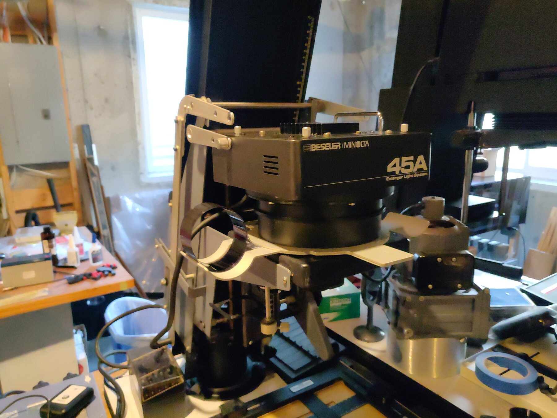

Looks like the 45A is working fine. I have it set in place on my D5, I need to make some brackets so it properly fits the lift arms, it was so close. The only issue I ran into was the screws got the brackets were rusted in. I just drill them out and re tapped them for the mounting screws the D5 uses.
