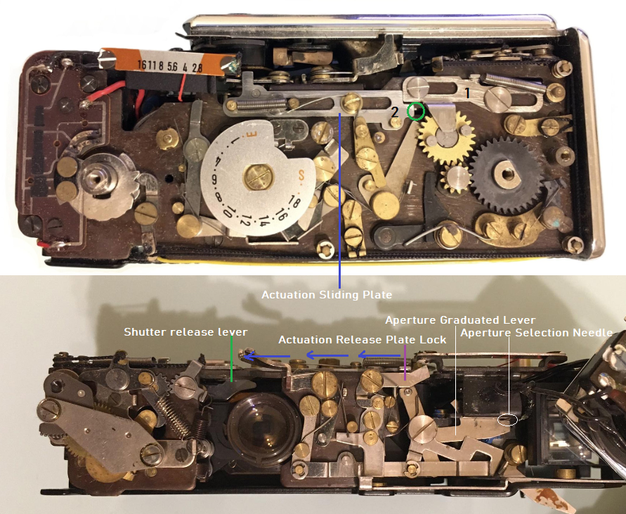

Hi,
I disassembled an MG-S, a few months back, and I'm puzzled by why the aperture mechanism would prevent the actuation of the shutter. When you press the release button, a series of linkages pulls a lock which releases the actuation sliding plate. The release of this sliding plate will allow the aperture graduated lever to spring up and stop on a pre-selected aperture setting, just a moment before the sliding plate completes its travel and hits the shutter release. The action of changing the aperture should not, in theory, be able to prevent the release of the shutter.
My guess is that there's something wrong with the aperture blades or maybe the spring of the graduated lever is out of position and it somehow de-synchronized the mechanism.
Here's what I call the "Aperture graduated lever".
