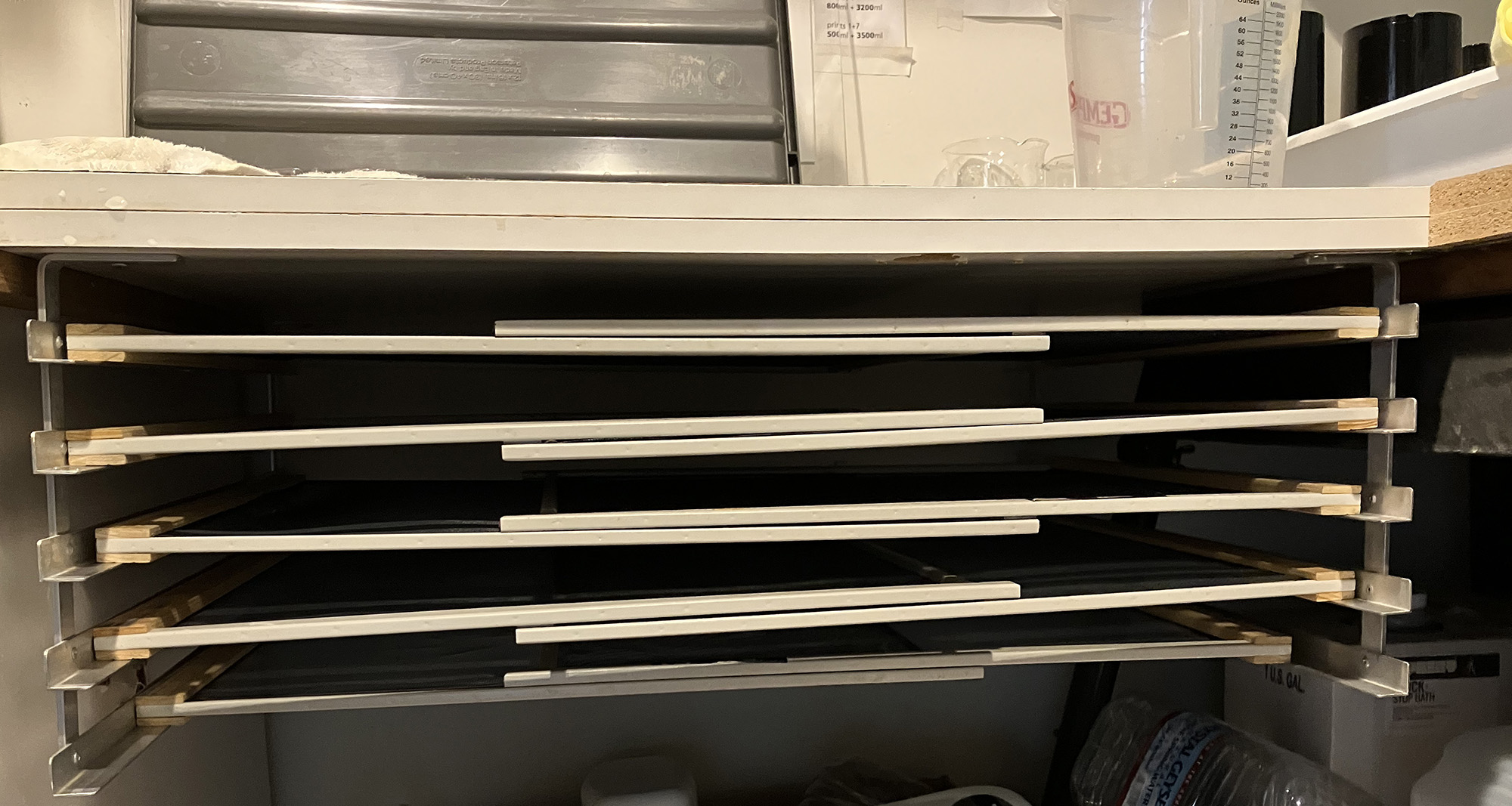

I made a simple drying rack that hangs under my wet table. (I have no sink or running water.) It consists of aluminum strips from the hardware store screwed under the table and supporting L-shaped aluminum channels, all put together with pop rivets. The screens slide on the L channels and can be stored horizontally when not in use. That holds 5 screens. When I have a big batch of prints to dry, I drag out a cheap sweater drying rack that will hold about two dozen more prints.

I use one of these Elfa frames and a set of fiberglass window screens bought at Home Depot as a drying rack. Inexpensive, simple, lightweight, and can be put on casters so it's easy to move as necessary. They come in various heights and widths too.

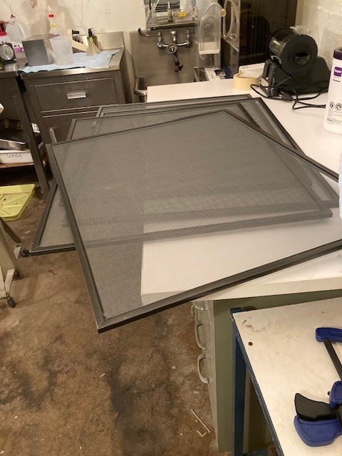

I use window screens for drying. After using print dryers and blotter books, this has been cheap, easy and reliable. The aluminum frames act as spacers, just enough space for circulation and to keep fiber prints relatively flat. You can stack them anywhere. Rack and spacers not necessary.
I agree. At different times of the year the temperature & humidity of my darkroom and house vary a lot. So i put the screens in different places to dry. I also agree that racks and spaces eat a lot of darkroom space....
A rack takes up less space than trying to strew 6-10 screens around the darkroom with space for air to circulate and dry the prints.
Stacking them on a work table works fine too. It all depends on your space available. In my case the only space i have is under my sink...which is far from ideal. After all though, the topic was "minimum equipment"( "requirements for a knock-down darkroom er, printing station? ). & in my darkrooms, a rack has been far down the priority list.
No sink, but a work table. Home-made rack holds 5 screens will dry 10 8x10 prints.
