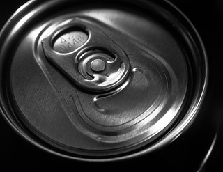

I do all my macro either with DIY reverse mounting ring, extension tubes or just holding the lens reversed in front of the camera.
Works fine and auto extension tubes often retain controls, making accurate metering possible. I converted mine from a tele converter by removing optics. Metering with reversed technique? I meter the scene, reverse the lens and open one stop up as a starting point. Then bracket some. Tripod is your friend, although all of these - except the beer can - were done handheld.
Here are some examples:
