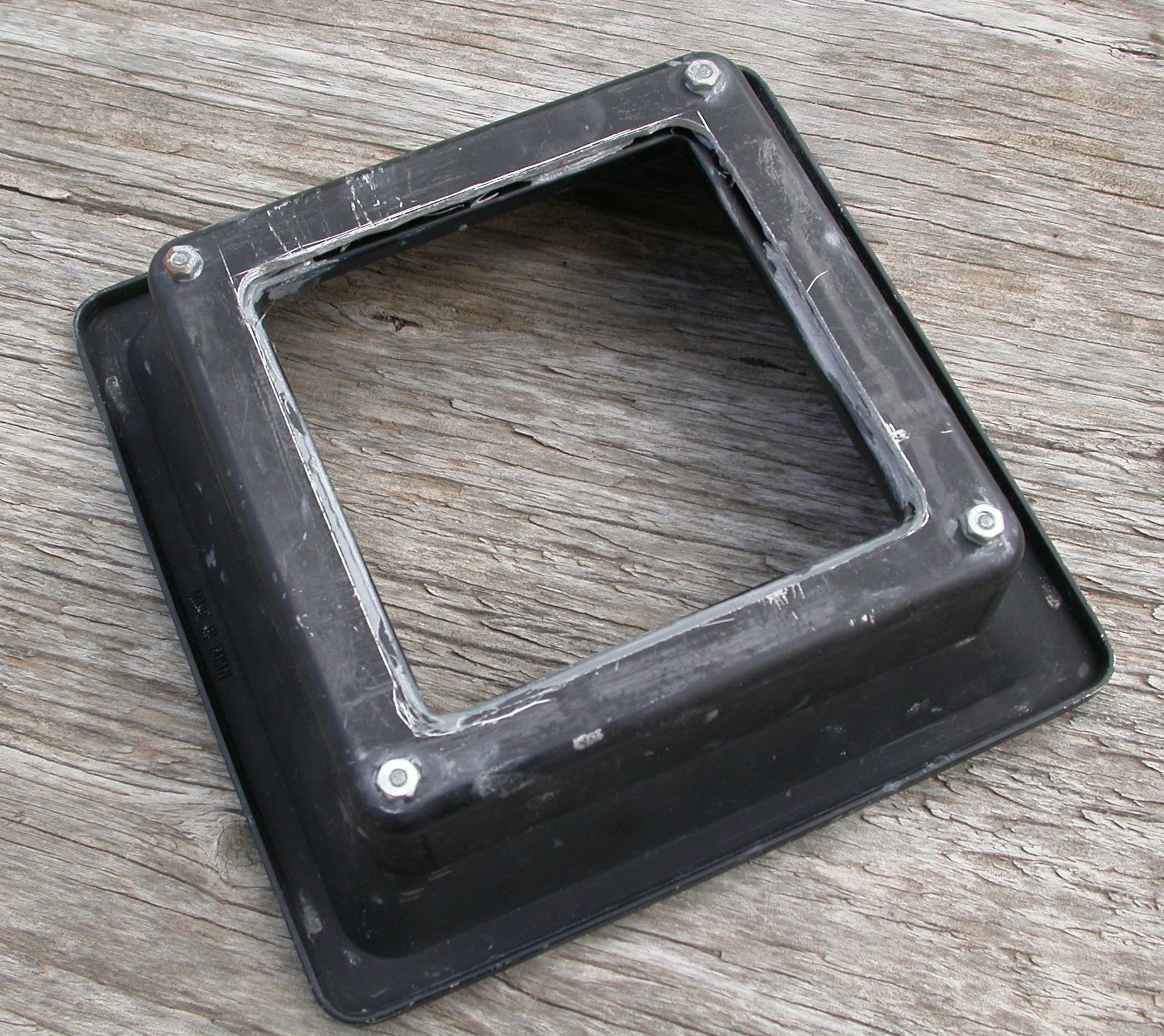

The original boards for the Miniature Speed Graphics were made of Bakelite and are next to impossible to find. It is not a difficult job to make new ones for additional lenses out of ply though. I have a soft spot for MSG's they are such pretty little cameras.
I suspect you will find that the flange for the lens has been bolted onto the lens board, The lens boards are quite thin so their is insufficient thickness for a screw to get a purchase even if you could find a screw small enough. That is what I have used in he past, small machine screws through nuts to secure the flanges, when I have made replacement lens boards for them.

The lens should just unscrew from the board. It will be the flange not the lens and shutter that is screwed to the board.

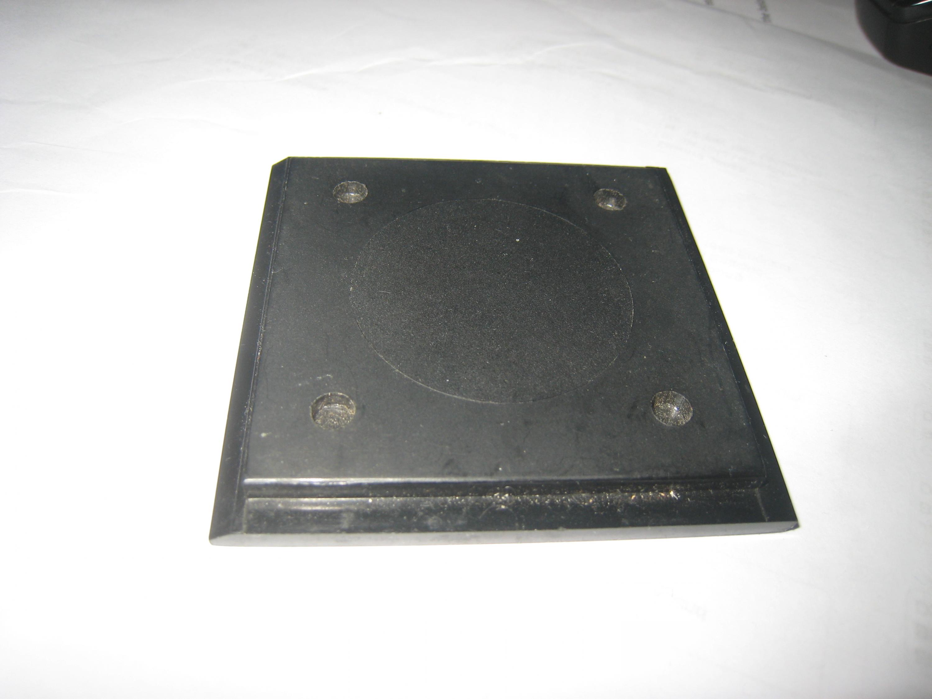

Yes it is. The Miniature Pacemaker board is a completely different animal it is a scaled down version of a 4x5 Pacemaker board. The Miniature Speed Graphic board is like a scaled down version of an Anniversary Speed Graphic board only made of Bakelite not wood.
Roger Hesketh
Nov 30, 2005
16
Whitey here is a picture of the rear face of an undrilled one. The front face is just shiny black.They are a smidge under 2.5 inches square.

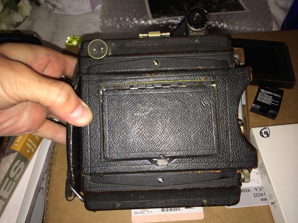

Here's the back btw with the ... Spring? Back?
yes, that's a Spring back.

As for the spring back, Stone, you are in need of something I did not have with me at the beach, a roll-film adapter that fits under the back. Adapt-a-roll 620 will work, but you have to have a 620 reel to take up the film (you can load from 120). I don't know if there is a Calumet version for these cameras as there is for 4x5. Or you can change the back to a Graflok, which will take the "22" and "23" holders. If you need sheet film holders, I have extra.

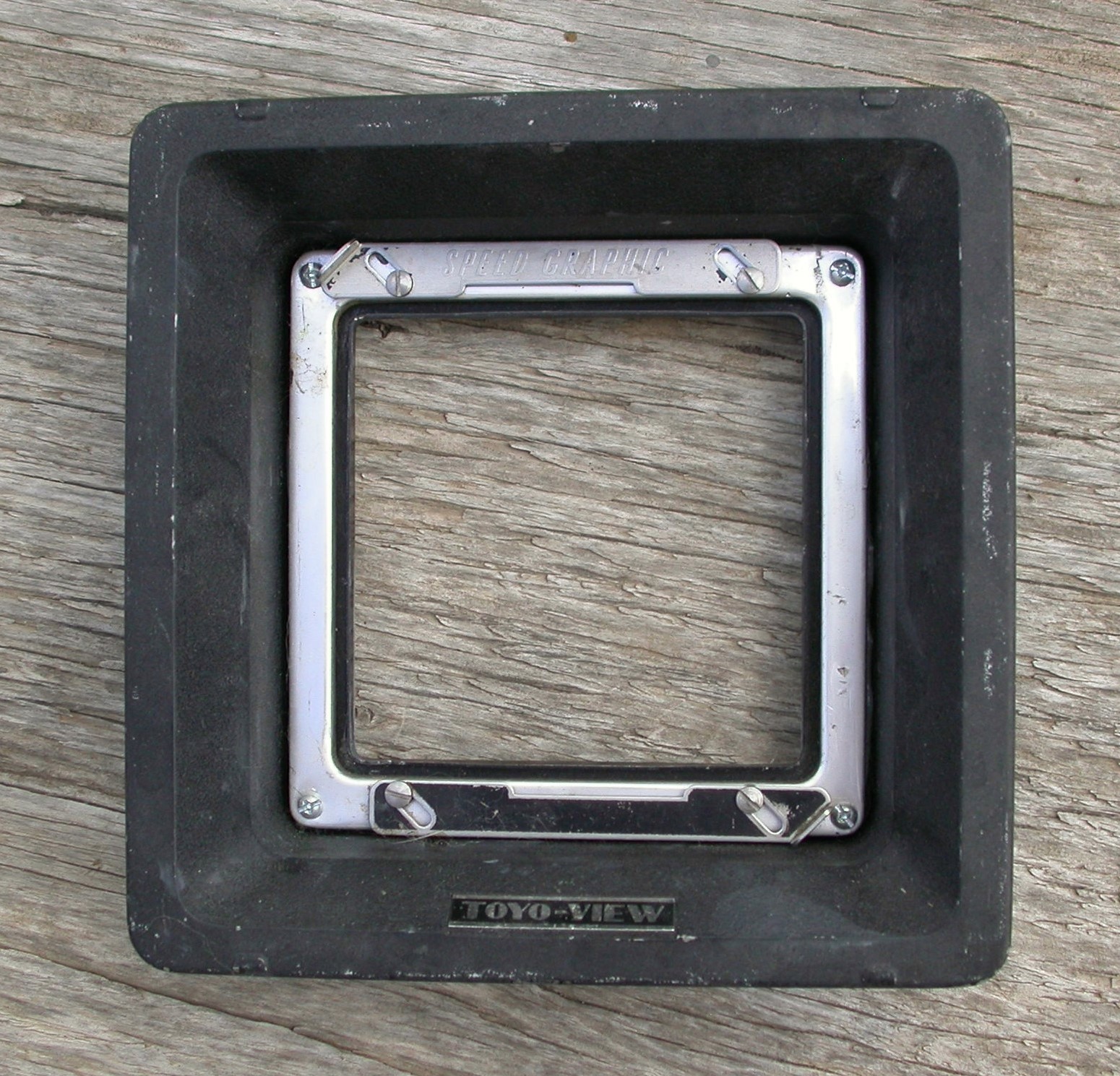

Whitey, factory issue boards for all Pacemaker Graphics are stamped metal with a lip that fits in the front standard's light trap. If you saw a Century with a bakelite board, you saw a Century with a bodged homebrew board that didn't fit properly. You may have seen a Century with a black anodized aftermarket metal board or with a black carbon fiber/resin (epoxy?) aftermarket board that fits properly and thought black = bakelite. The carbon fiber boards come out of eastern Europe. All of the reports I've seen on them were very favorable.
