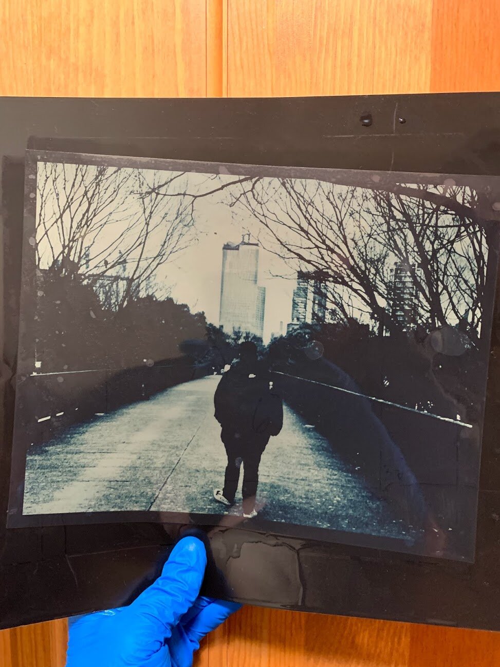

I've been messing with shooting Arista Ortho Litho film for quite a while and about 90% of what I produce exhibits a very strong tintype effect, especially when viewing from the non-emulsion side. The tin types are also particularly colorful and depending on developer technique it can be a rare blue color. The brightness is decent enough, but black levels are very subpar. I've tried painting the emulsion side with a few different paints, but the paints tend to either crystalize in weird ways within the emulsion or the brush lines are very visible. I've had some reasonable results with using a simple chisel tip sharpie and then putting it onto a black background to sure up the black levels (ie, no "light leaks"). However, this process is very time consuming of course. Has anyone ever messed with something like this? An example of the kinda effect that I've seen is attached. The image is an orangeish negative but turns to blue when on a black background. It seems to be a much stronger tintype effect than any other film out there, and seems to even beat some tintype specific emulsions (not to mention capable of very consistent results). Getting a proper black level seems to be the only missing piece.
