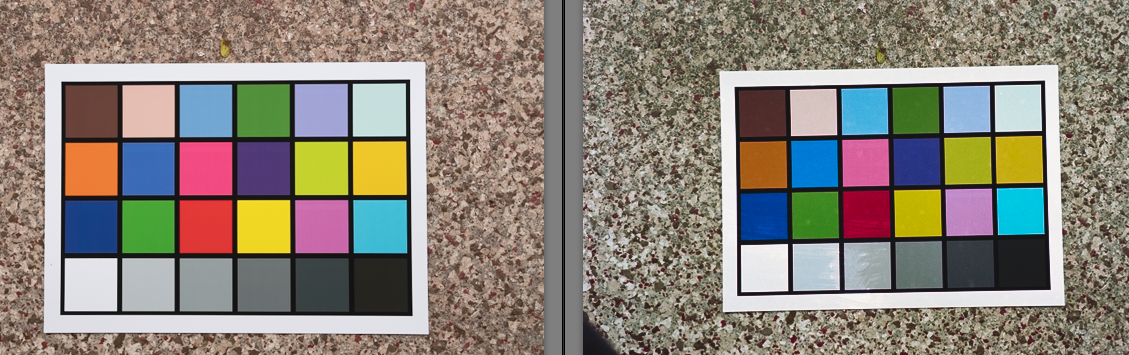

Mixed up a batch of QWD (Quiet We're Dreaming) ECN-2 chemicals and ran some test shots through the Chromabox, results were pretty good IMO, way better than I ever got processing cine film in C41. There was still a tiny bit of remjet left but the prebath got rid of 99.9% of it, better than I could ever get it when manually wiping it off.
Two shots of the same colour target, digital camera on the left, Kodak vision 3 250D on the right. Cine film DSLR 'scanned' and inverted using negative lab pro and all of the 'auto' settings (no manual colour correction). The patch colours in the digital photo are more accurate but I think the ground is a little too red, I kinda prefer the cine film to be honest.
Another random shot from the same roll, very bleak overcast morning. Some weird light leaks to the left of frame but otherwise good results.
Overall really pleased with how the machine worked and how the chemicals did, now that I have the ECN-2 I think I'll be shooting cine film a lot more than I was, which is good because I still have about 1/3rd of a bulk roll left in my fridge (and I might buy another one when I've used it up).
