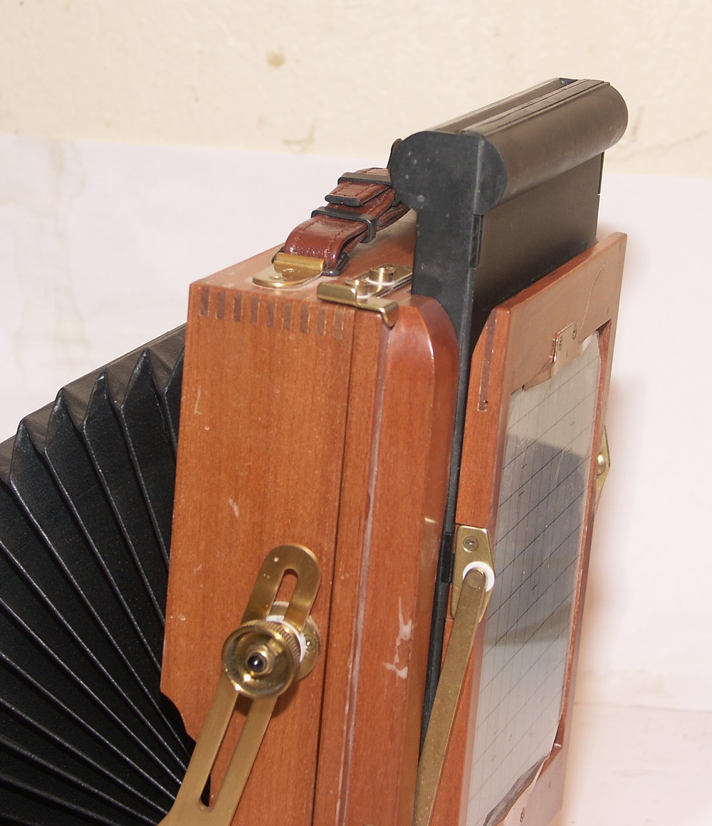

I've been currently using the Type II Mido 4X5 holders - load just like regular holders, but are thinner, so need an extra clamshell adapter. I have a dozen of em plus two adapters, and don't ordinarily use them, but wanted to make sure all worked properly. Actually, one holder was set aside with a known defect. You have to be more careful than with ordinary holders. There is not a lot of saved weight, only about 30%, but they're only half the bulk, which is nice. I never did get along with the earlier vinyl sleeve Mido system, so sold that.

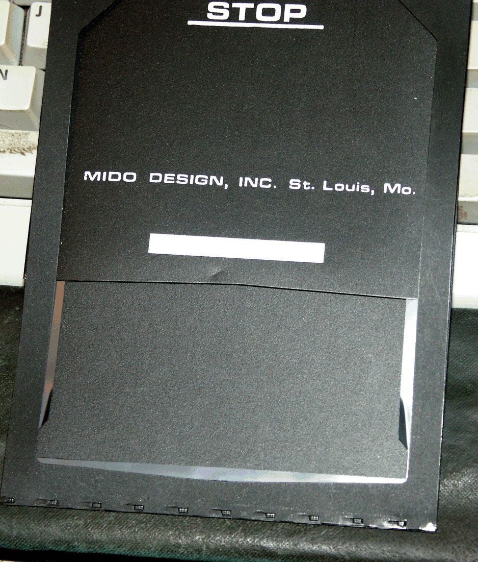

If you don't have the instruction sheet, you can compare your holders to this photo of the second version:

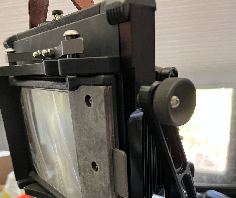

I think I see the problem. Here is the TOKO adapter on my field camera.
Does the top part of the holder prevent it from sliding in all the way? I don't see the holder in your photo.
Yea, it might work if I switch the orientation, but now the holder is in a box to its future owner :smile:
