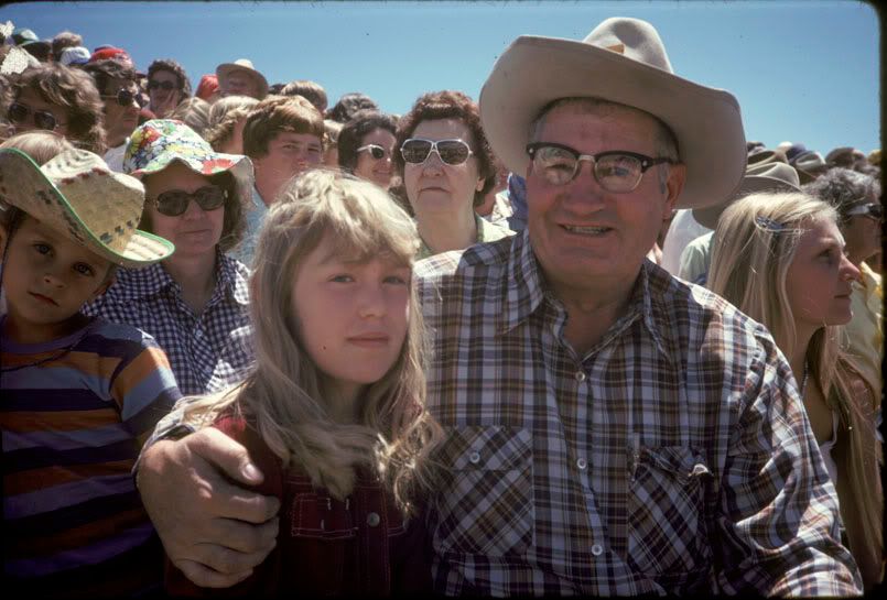

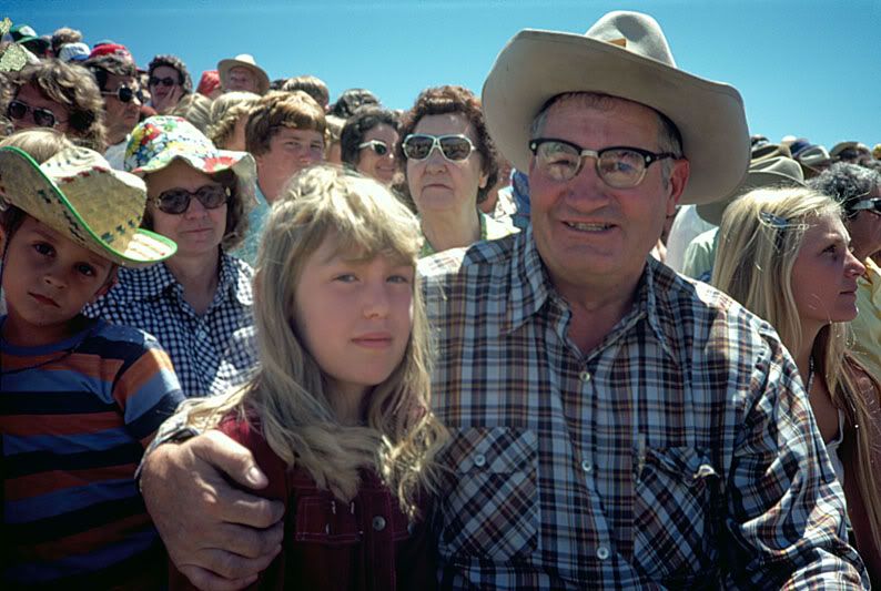

OK, my scanner is finally here, and here is the first scan compared to a scan of the same slide done on a Microtek 4000tf. Both at 4000ppi, autofocus, rough color correction, blah, blah, blah, no sharpening. The Nikon is at SuperFine 8x like everyone says you need to get good results. The slide is an old Kodachrome mounted and used in the correct holder for mounted slides. These two scanners should be of the same level from nearly the same years. I will withhold my comments so as not to bias anything.
Microtek full image:
Microtek crop image:
Nikon full image:
Nikon crop image:
To my eyes the Microtek looks slightly sharper. Over all dynamic range of the two scanners appears to be the same.
Don Bryant
Don,
Strange. To my eyes the Nikon scan is clearly sharper than the Microtek?

The different contrast is throwing out problems with perceived sharpness, but it does look like the Microtek added a little sharpening too. The muddy blacks with clogged up the detail reflected in the sunglasses is the big point I was trying to make. For a first scan and rushed corrections to make them close to matching the Nikon seems to be a clear winner. If I cut some 100% crops of the flesh tones, you'll see even more reason why I think the Nikon is better, the Microtek looks all grainy, but I don't think it is really grain or they should both show the same problems.
I believe the film is Kodachrome 64, but unfortunately as you can see the subject is not in focus and there really isn't any object in focus so it is going to be a little hard to determine it's over all "sharpness" until I scan some other films.
I've had more than a little bit of experience using the Microtek software so I had a good idea about what I was doing, the Nikon software is the first time I've ever used it, and I haven't really read through the book yet. So there could be some things that slipped past me in the Nikon software. It was scanned with the default Kodachrome setting in NikonScan 4.02. And I can't wait to see what I can get with other images and wet mounting.

Don,
Sandy King
Okay, I've just opened the images on a different monitor ( I have a two monitor system) and the Nikon scan does look sharper on my LCD compared to my CRT - wierd.
Don
Marco B
Jan 13, 2005
2,736
The Netherla
Don, are you actually looking at the full images, or the 100%, pixel per pixel, crops (the glasses detail)...
Comparing the full size images is useless, as it will tell you nothing about the quality of the scan. Even a very poor scan of the cheapest scanner will look good if the image was scaled down from let's say 2000 * 3000 to a mere 400 * 600 pixels for display on the web...
You can ONLY compare 100% images, that show each-and-every pixel scanned. Any other comparison is useless (this is an error I unfortunately all to often see happening on the web).
And yes, the Nikon result is FAR superior, even withstanding the poor focus of the original image... just look at the details of the reflection in the glass (you can even recognize the front guys block patterned shirt in that reflection on the Nikon scan :wink:, something wholly impossible with the Microtek scan), and the overall glass frame and clip on the left...
