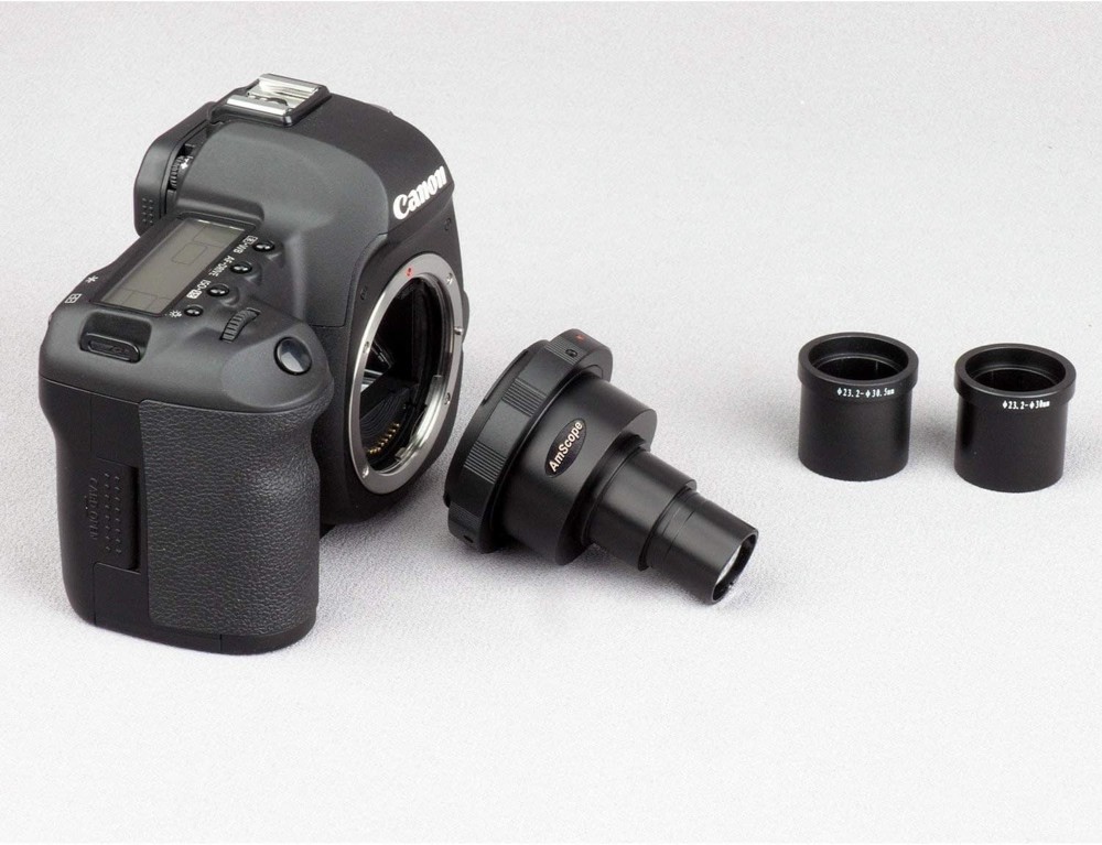

I want to photograph my stuff. There are mobile phone adapters, to allow you to put your mobile phone directly and stably against the lens, but I have something better than that, I have a Cannon EOS Digital Rebel XTI 400D. I want to use that.
I see on Amazon there are adapters for telescopes, and compound microscopes many using 23.3 eye pieces, but I have a stereo microscope using 30mm eye pieces and that I am having trouble finding adapters for.
Here is an example
Does anyone else do this, anyone know what to do, or where to find this type of accessory but for 30mm eye pieces?

Yes, I am aware of the existence of those. However, in interest of saving money and getting good quality, I feel my Cannon 400D would be better. Certainly better camera than any usb eye piece camera I can afford.
"Celestron" does sell a lens mount for the cannon EOS-F models, like mine, and I did find a 30mm T adapter. At long last, so ill probably go with those.

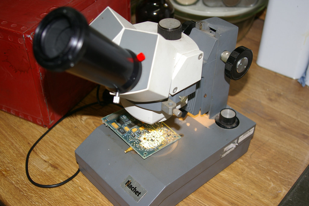

I modified a T2 tube with three small screws to clamp over the eyepiece of the microscope at work.
microscope hardware IMGP2037 by Mike Kanssen, on Flickr.
This arrangement should work either with or without the microscopes eyepiece.

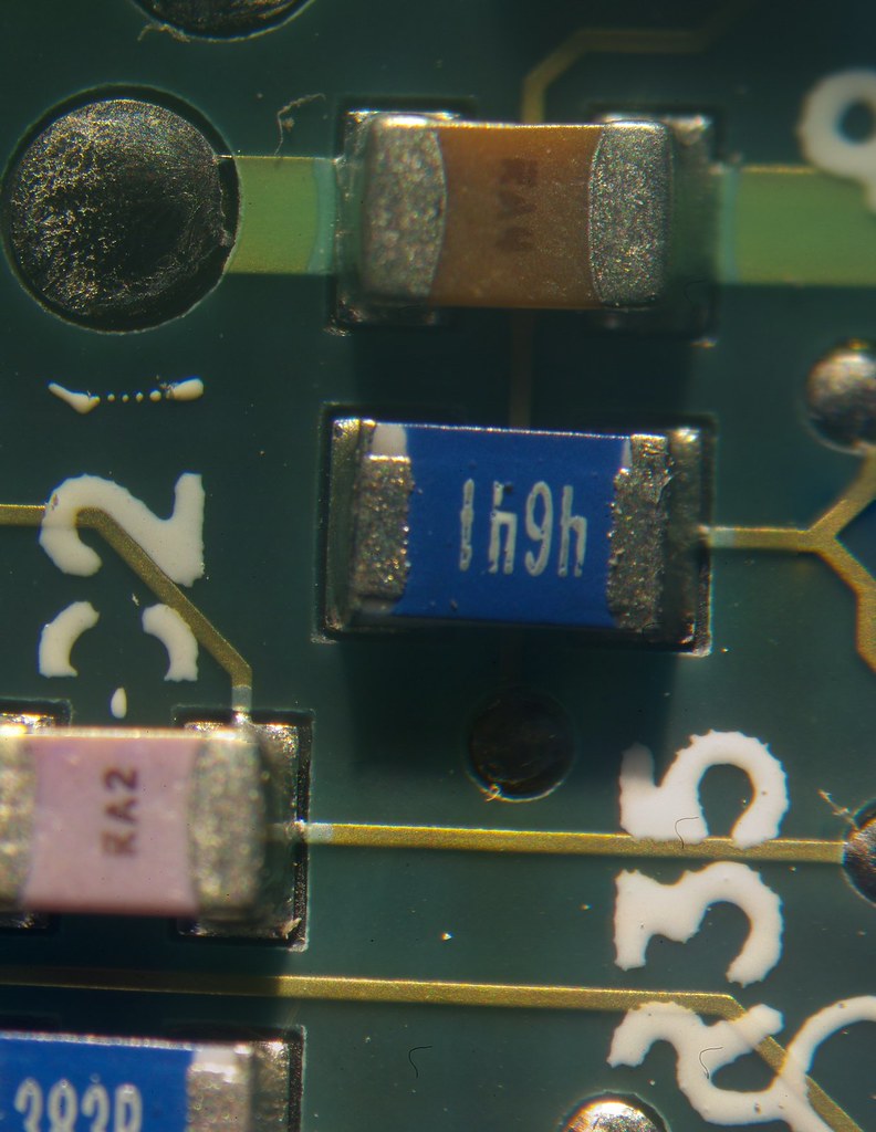

Results were quire reasonable (much better than my digital microscope)
PCB detail from an old (1990s) mass spectrometer by Mike Kanssen, on Flickr
