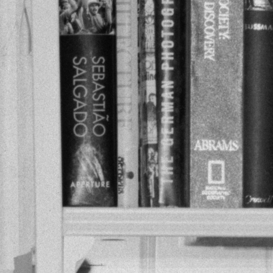

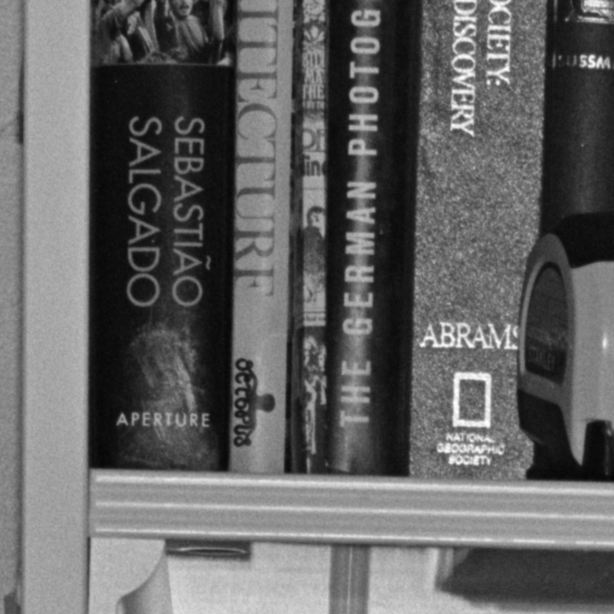

I had some pretty odd results with HR-50, if it's of interest to anyone. Resolution and grain seem slightly worse than Copex in ideal circumstances, but especially in HR-Dev it feels like it performs much more 'normally' in terms of contrast and shadow detail. No edge effect either. However, for whatever reason, Copex's performance at infinity was much, much better. With three different cameras and lenses, shots at infinity on HR-50 all looked very slightly out of focus. Something to do with the thickness of the emulsion maybe? Also, HR-50 stained my reels and fixer black, which was less than great.
Anyway, here's a comparison (very unscientifically not shot on the same day but at least with the same gear). Full scans are 11000px wide, so what, 7800ish dpi?
Copex in Caffenol CLCN: Scan00391.jpg
HR-50 in HR-Dev:Scan00330-Pano.jpg
Henning Serger
Aug 31, 2006
2,196
Agfa Copex Rapid is a microfilm, HR-50 is not.
Therefore sharpness and resolution of CoRa are higher, which is to be expected (tested both films in my resolution test and got exactly the expected results).
But I've got finer grain with HR-50 in HR Dev compared to CoRa in the dedicated SPUR developer. Was also expected, no surprise. I've got sharp results with HR Dev, too.
And I have also never had any problems with staining.

The hr-dev caused the staining?
With the reels, I can't be sure, but the developer turned dark grey whether it was HR-Dev or HC-110.
Best regards,
Henning
That sounds about right! And I don't want to exaggerate the reel staining - it's just a noticeable bit inside the film channels. Nothing horrible.
