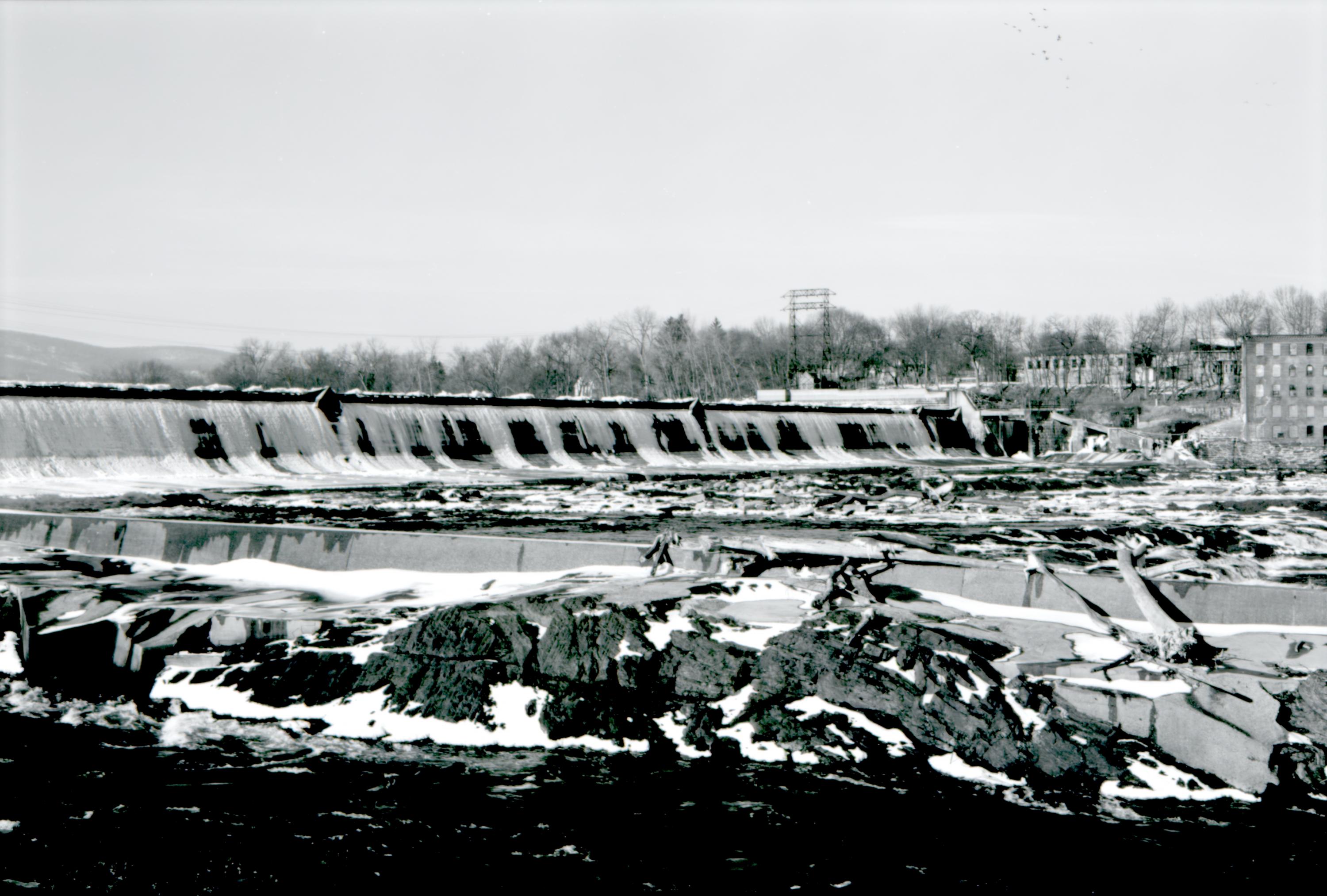

I got results like this picture. This is a scan from my Epson 3200. I rated the film at ISO 20 and shot it handheld. I would have gotten better results with a tripod. As it was, I couldn't stop down for depth of field and I was getting like 1/60 second shutter speed at f3.5. It was just a test roll to get the feel of things.

Even continuous tone conventional panchromatic film can be difficult to obtain. Where are you getting that film?
I have about 200 feet of 35mm microfilm (unmarked container) I have been using in the last few years. I rotary process it in T-max developer at 16C for 4.5 min or in dilute 1:100 Rodinal at 24C. I rate it around 6 to 24. I was able to get a pretty good range of tones out of the film by giving lots of exposure and little development. (35mm film with 18mm Carl Zeiss lens)

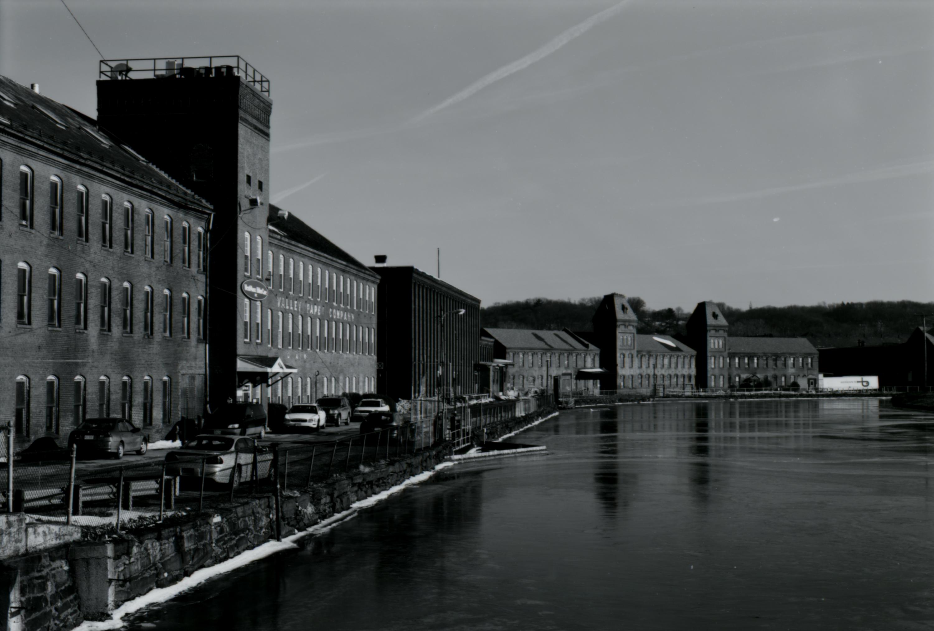

Here's another picture I took, of our frozen river. Both of the pictures that I posted are unsharpened out of the scanner. What I find is that I can sharpen the heck out of them, without seeing any film grain. With other films, my sharpening is limited by the grain. With this film, I can sharpen until the edge effects get annoying.
