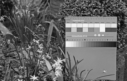

Here an example of Fomapan Creative 200 (T200) on E.I. 100 in W665, 9:45 minutes 20C. Zone V exactly on 0,72 log D.
Leica M7 + Summicron 2,0/50mm.
