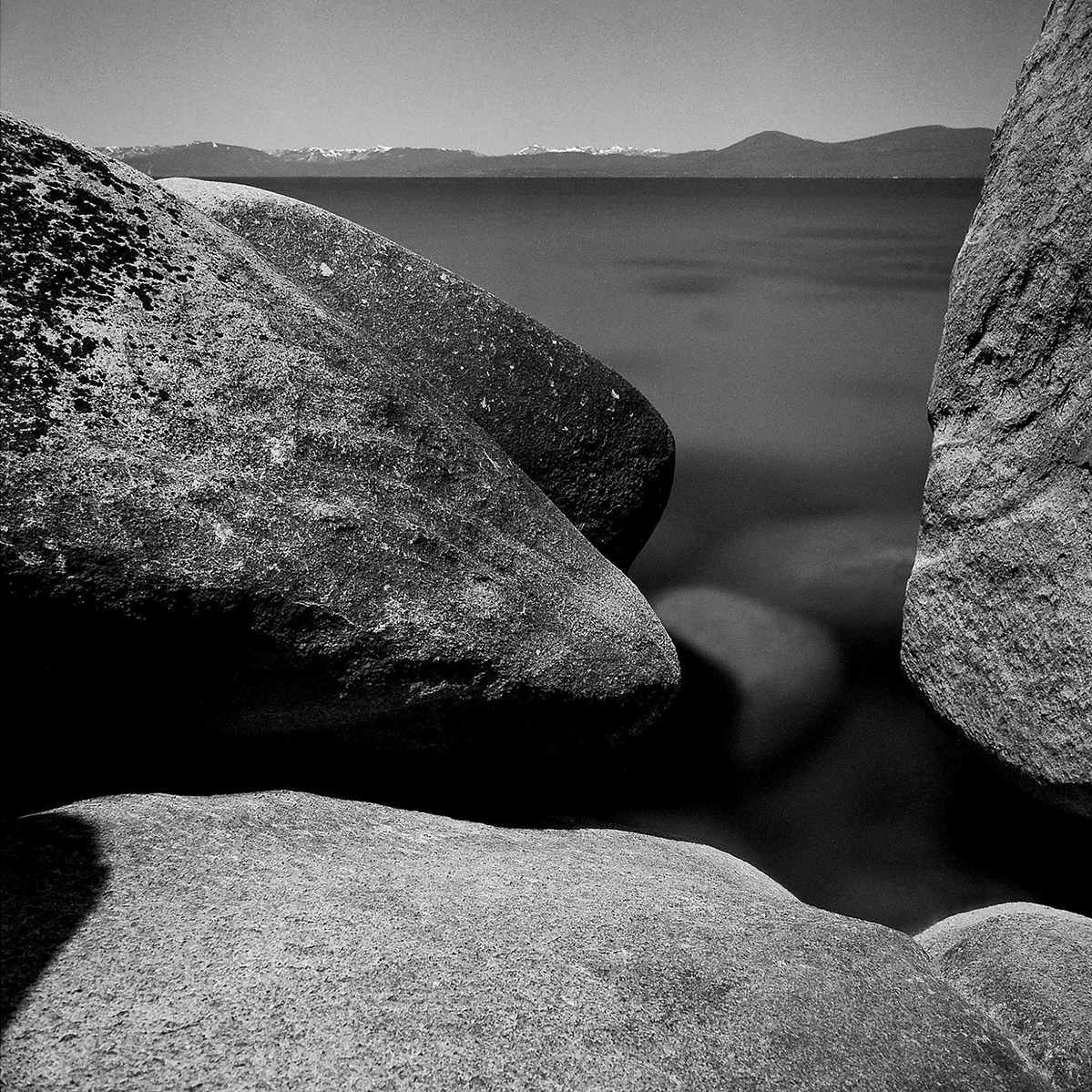

I think I shot the attached with a polarizing filter and a 10 stop ND with my Hasselblad, it was in full sunlight for 2 minutes I believe. The last thing I was thinking about when making it was if it were a "Michael Kenna" or not.
Forgive the dust!
Heliopan ND3 + Red 29, Tri-x 400, bright sunny afternoon (all if my memory is correct).
