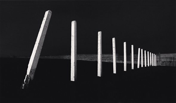

Q1: How would achieve the light tone of the water? Is it done only by dodging?
Q2: how to achieve this high contrast? It seems that the light is only on the poles. In my Michael Kenna's Retrospective book the reproduction is even higher in contrast. Was this done by careful masking to burn everything except the poles?

Are you sure that these are optically enlarged darkroom prints and not digital prints (lambda, inkjet) from scanned negatives? I suspect it is the latter and in that case the answer is digital editing.
If they are true darkroom prints, dodging first (sea, poles) and then burning with high grade might do it.

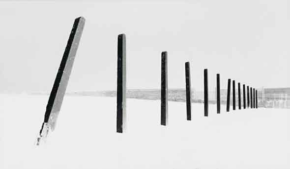

kenna is known to use very long exposures at night or before/after sunrise/sunset.
Now imagine some moonlight on white posts. But just to throw you off the trail, they could be posts shot on IR film. Or to confuse you even more how about its the negative inverted, the book printers made a mistake and the proof readers missed it, or maybe decided it looked cool like that. Posts in snow.

Dodging, Burning and some Bleach followed by toning with selenium toner. For the second image if the poles were painted with bright white paint like a greek house and the ground is not white sand but dark volcanic sand or dark soil moonlight (especially full moon) with some contrast enhancement like bleach might give you the look. The light of the full or almost fool moon is very unique and this Image seems to be the result of it.

Nothing exotic in the notes. Just things like red filtration, plus dev of the neg, lots of dodging and burning. But the devil is in the details. Everybody
knows the ingredients of a Caesar Salad, but they sure don't all taste the same. Some films will plus develop better than others. Some papers bleach
highlights nicely, some don't. I have a hunch what Kenna might be doing, but really don't know or care. Why not just ask him? Won't make much
difference. It's the sense of taste that counts. Just getting high contrast images like that post and snow scene is easy: underexpose and overdevelop.
TMY is a good film for that purpose, though Tri-X was probably once Kenna's choice.
DREW WILEY
Jul 14, 2011
14,775
8x10 Format
... and yeah, I also think it's an inverted image.

There is nothing special about his materials. I believe he uses Tri-X and prints on MGIV glossy last I heard or saw (sorry Bob!). I have never seen a print of his on matt paper. He does do a lot of dodging and burning in the darkroom though.
The first photograph is pretty much all dodging and burning from what i can tell. The post photograph is probably pretty straight.
I don't know why people are saying he uses digital.

In the first shot, it's done by blowing out the highlights (whether intentionally or unintentionally, who knows?). If you get the right light, which will last maybe 10-20 seconds at most, you should be able to get similar results on that second shot. But that's theoretical. In all likelihood, it will be very hard to duplicate either, so I wouldn't worry about it, and move on to your own stuff. It's all about getting that fleeting light just right.

I think that there's a lot more complexity being assumed regarding these images than really was the case.
In the Golden Gate image he might have simply dodged the bottom and then done a high contrast filter burn on the bottom. Pretty rudimentary.
On the image of the posts it just looks like it was shot at night. Either illuminated by some moonlight or even something as simple as a light on a nearby path. The image then being printed high contrast. Again nothing complicated.
There are usually multiple ways to achieve a certain look. The more skilled and experienced photographers can usually find the easiest or more direct route.
