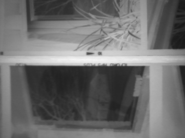

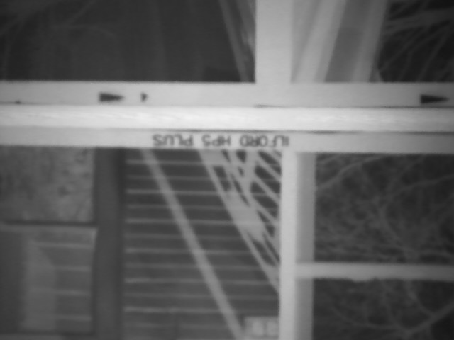

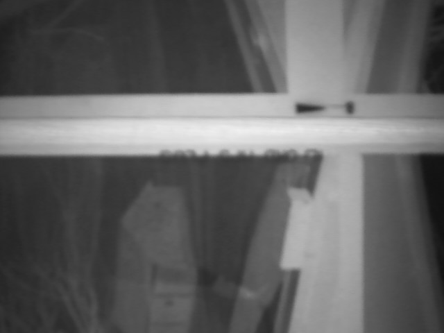

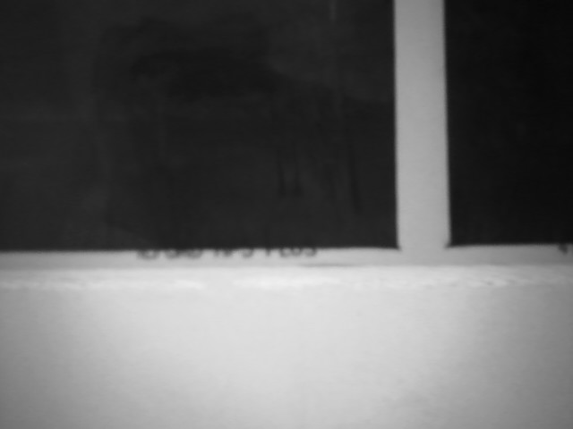

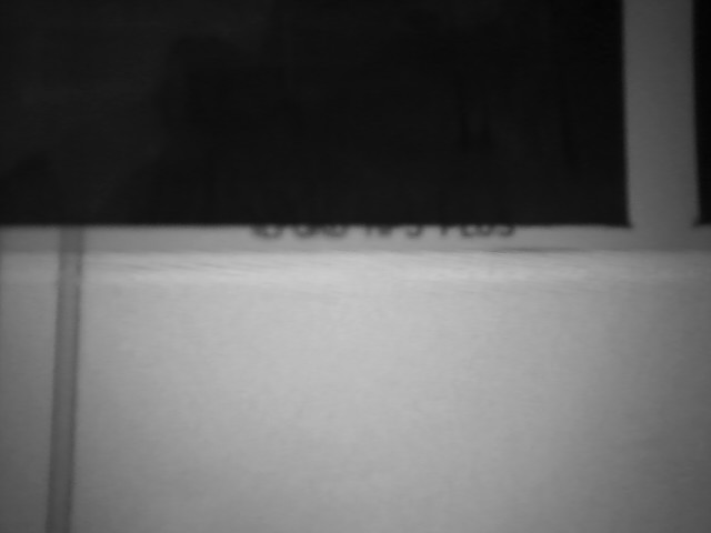

I've taken cell images against my monitor as requested. They are not ideal but show the placement of the image vs the lettering vs the edge of the film.
Image captions:
hp5rb67_1 and hp5rb67_2: were made using my RB67 (this has happened in both of my backs). Please note not only the overlap of the Ilford Logo onto the image area and the position of the image area BUT ALSO the distance of the Ilford Logo from the edge of the film.
hp5rolleiflex_1 and hp5rolleiflex_2: were made using my Rolleiflex T. Again, note not only the Ilford Logo / image overlap and image position BUT ALSO the distance of the Ilford Logo from the edge of the film.
hp5+rolleiflex_3: was made using my Rolleiflex T. This is toward the end of one off the affected rolls where it USUALLY works itself out as it had in this case.
The varying position of the ILFORD HP5+ logo against the edge of the film contributes to the worst cases but the varying position of the image area itself seems to be the biggest problem. When both are off is when it gets really bad.
After reviewing negatives made over the last year (about the extent of time I've used Ilford 120roll film (I've been using other brands of 120 roll film for well over a decade)), I have noted the following with ILFORD HP5+ 120 roll film:
The problem of overlap has ONLY occurred with Ilford HP5+. The problem started with film I bought in the fall of 2013. Before that my Ilford HP5+ would sometimes come CLOSE to the edge of the image area and occasionally touch the image area but barely - to the point that I did not and still do not consider it a problem.
The problem seems to be two fold. 1. The image area seems to move around on the film from the start of the roll to the end where it's position usually improves. 2. The Ilford HP5+ (and little number after it, ie 4130) moves in relation to the edge of the film itself. Sometimes it is stamped right on the edge, sometimes it's pushed quite a ways up into the film frame.
After reviewing negatives made over the last several years using Kodak films (mosly Tmax400 and some 125px and 400tx) I have noted the following:
I have NEVER had the image area overlap the Kodak Logo or frame numbers. Sometimes the image area is a little closer to one side than the other but not that much, and never enough to overlap.
Also, the Kodak Logo at the top and the frame numbers at the bottom are ALWAYS right against the edge of the film. Looking through years of negatives I could not find one example of the Kodak imprinting not being right on the edge of the frame.
I used my last two rolls of HP5+ over the weekend. I took a LONG time loading them and was as careful possible (I'm always careful...) I made sure everything was centered and the leader was secure... I used a roll in each of my two backs. I will develop them and see what happens. I've bought 10 rolls of TMY2 to follow them until / unless I can get this figured out.
Given the above, the only thing that makes sense to me is that:
1. I'm loading the film incorrectly... (if that is the case I'll be damned if I can figure out what I'm doing wrong and what I've changed since last summer.)
2. There is some difference between the Ilford 120 roll film I've used recently and the Kodak 120 roll film I've used for many years.
If you see any other options that make sense or have any other helpful thoughts PLEASE let me know.
Thanks again for your thoughts and help with this, everyone.
P.S. Incase you are new to this thread or did not read it fully... I HAVE USED KODAK FILM IN THE SAME BACKS / CAMERAS BEFORE, DURING AND AFTER HAVING THESE PROBLEMS WITH THE ILFORD FILM AND NOT HAD ANY ISSUES.
We can conclude that the imprint of the Ilford HP5+, arrows, and frame numbers, are not of equal distance to the edge of the film in your samples. It looks to fall roughly within the measured 1.42mm that Ian C measured as the difference between the film width and the backing paper width.
Judging by your attachments, it also looks as though the edge of the negative area is of consistent distance to the film edge.
The only conclusion I can draw is that the imprint is not always perfectly aligned with the edge of the film. It would be very interesting to know how the imprinting is done.
My Hasselblad makes a smaller negative area than both your RB67 and Rolleiflex, so I have never noticed the text of any 120 film enter the film area, be it Ilford, Kodak, or even Foma.
I have some HP5+ I shot back in 2004 using a Rolleiflex. When I get home I'll dig it out to see if there is any correlation to what you are showing, Shawn.
The pictures you showed do look like there's a lot of "wandering" in the image area, all right. Just to make sure, have you confirmed that if you got the *image* placement of the Kodak films, the larger imprint area on HP5+ would not overlap?---that is, in the worst case for Kodak image position, combined with the worst case for HP5+ imprint position, is there overlap or not?
The film gate isn't moving, so it follows that the film must be (sorry to belabor the obvious, but this is a weird enough result that I think it's worth questioning what we think we know). Have you tried placing the affected films against the gate, in room light, and seeing where they have to sit in order to account for the image position?
I'm just brainstorming here. It seems obvious that this shouldn't happen.
-NT

You must be identifying the film edge location incorrectly. The Ilford Logo varies in it's placement to the edge of the film. Sometimes it's right on the edge, sometimes it is moved considerably "up" into the film with a couple of mm in between the bottom of the lettering and the edge of the film.
The image area is NOT consistent with the edge of the film.
Everything else you gentlemen have written sounds correct. I apologize for the quality of those snapshots. It's the best I can muster right now. I have no access to a film scanner at the moment.
Just to reiterate : The Ilford Logo is NOT always consistent in it's placement AND the image area is not always consistent, it wanders as it runs through the length of the roll, USUALLY correcting itself by the end. When these two things are both off is when the overlap gets really bad.

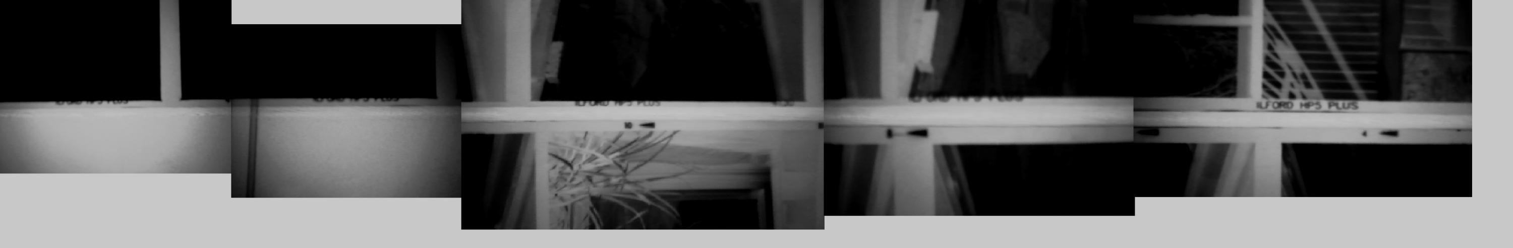

Shawn, I took your pictures and put them side by side on a single image.
You can clearly see that the distance of the text to the edge of the film is inconsistent.
-NT

I did check what you are asking in the first paragraph. The image area wanders A SMALL amount with the Kodak film, not very much. Not nearly as much as with the Ilford film. The Ilford imprint text is a little bit larger than the Kodak text. That is a good point, BUT, it's not much larger and that alone wouldn't solve the problem.
I am wondering whether Ilford (and Kodak and others) have a defined tolerance for the placement of the lettering, and if the movement you see of that lettering is within that tolerance.
It may be that your film gates are quite generous, in that they give you more image area than most. For most people, that wouldn't matter, because very few people make contact prints from 120 negatives in a situation where intrusion of the lettering into the extra image area would create a problem.
That is a good point as well, Matt. Maybe the RB67 backs and the Rolleiflex T both have larger image areas than most cameras... I don't know. I exposed a very large amount of film with Bronica systems over the years. Those negatives did not overlap but I have never checked to see if the image areas are the same size as my other cameras.
Even so, the amount of "wandering" of the image area with the HP5+ vs the Kodak seems strange to me.

Thomas, you are absolutely correct on that account. Both the distance of the text to the edge of the film AND the placement of the image area in relation to the edge of the film vary. And the problem is at it's worst when both of those things happen.
That said, the "snaps" I took were made handheld at different distances so lining them up isn't going to give accurate distances. BUT you are still correct, you can plainly see just looking at them that sometimes the logo is right on the film edge and sometimes the logo is moved up a good bit from the film edge.

When I look at various negatives made by my Hasselblad, the actual image area is offset from center slightly to either side on almost every roll. Very few are completely centered.
Strictly going off of memory, but I gotta agree. I can attest to how finicky film backs can be. Spacing issues, overlapping, slightly off center on the strip, etc etc. Also my images are slightly smaller than when taken with my Rollei and this is across the board for film used.
Regardless though, it does seem odd, that this was something the OP never noticed/witnessed with the same cameras/materials and then over the past few months started having this occur. Either something in the tolerances changed (although not sure what) or the camera is now resulting in slightly larger images or more off center than before? I mean the photos do help, but it seems there could be a myriad of options and reasons.

I just can't understand how it could be an equipment problem when everything is fine using Kodak film... As I've stated over and over, I've been shooting Kodak film before, during and after having this problem with Ilford and have never had an issue with Kodak film. I'm not talking 1 or two rolls, here. I'm talking about at least 20 rolls of each brand this year and I'm not sure how many in late fall.
The only things that makes sense to me thus far are:
1. I'm loading the Ilford film improperly (starting last fall...). I can't imagine what I'm doing wrong but I'm open to it.
2. There is a difference between Ilford and Kodak film. (obviously there is a difference in the precision of placement of the logo/#s themselves - but that is not the sole issue).
I still haven't heard anything else that makes sense.
Just to be clear Shawn.
Have you been making these small contact prints for a long time?
Because you may have encountered some variations in both image placement and edge printing placement before, but not been bothered by them if you weren't contact printing for final results.
Thanks, Matt.
I've been making them since 2006 or so. Even if I weren't contact printing them some of the logos intrude VERY far into the frame, so that a full half of the logo is into the image. That would be a problem with enlargements as well, at least for me.
Also, I've looked back through all my negatives since I've had the RB67 and the Rolleiflex. All Kodak 120 film back then I could not find one overlap nor one case of the Kodak logo / frame #s not being exactly on the edge of the film.

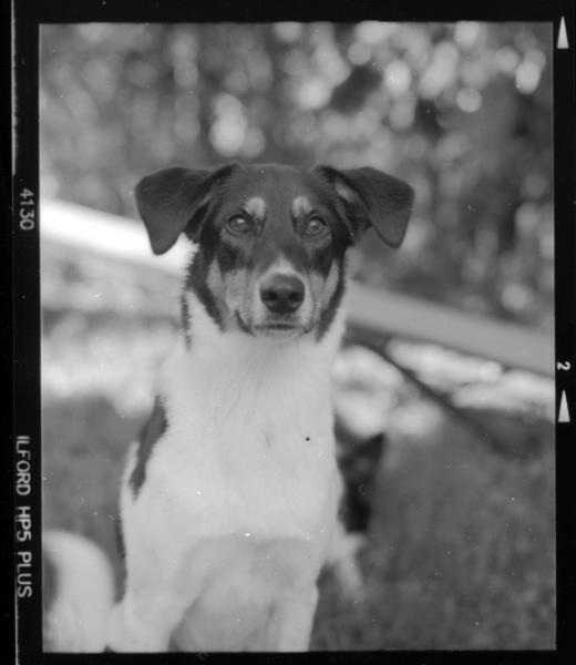

Just for comparison, a scan form a recent proof of a picture I took with my Rb67 and Hp5. (pint has some dust marks as it was done using a printfile page. The Ilford markings are rather large but still mostly in the area of the film allotted to them
Nice dog but you wouldn't want to tangle with him any more than tangle with Gary Cooper in High Noon. The Ilford film simply thought better of making trouble and stayed on the train :D
