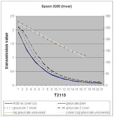

not sure if you're on for an experiement, but I've found two things which may be of use to you.
1) covering the calibration area with a neutral density gel (say 1 or 2 stops density) causes the scanner to turn up the gain a little. You can see my plots of this here.
2) adjusting the sliders in the histogram to nail more over into the dark area seems to also effect scan time with no other change. I have noticed better dark penetration there. You need to click on the histogram tool in Epson scan to access this and I think you must also be in "professional mode", with the right settings for colour management.
It is not linear in behaviour, but then neither is the way my Nikon behaves when doing multi-scanning or adjusting gain controls
I found that on a test 35mm slide I could get nearly the same shadow penetration from the Epson as my LS-4000 does.
I'll be interested to know how it goes if you try it.

bewdy ... wonder if anyone will ever find this stuff ... anyway ...
So for the 1st test, I just use a piece of unexposed developed film as my ND filter? What do you think would be better for this- 35mm film (FP4 which is quite a bit darker and purple)
I used some acetate sheet at first but then went to using one of my Cokin P nd filters. If your cover has irregularities it will make for an ugly scan. Dust will give streaks too.
For 2nd test, are you saying to just move the black slider over to the edge beyond the black end of the histogram and leave the white slider alone, or move them both over equally (If so, would this not clip the whites?)? You say sliders (plural), so I'm not exactly sure what to move where....
yeah, sorry about that ... firstly if you can get to see this stage in the scanner software
then what you need to to is select a specific colour channel (the radio button beside the colour) and then move the black slider at the bottom of the histogram to the left. I've found that moving the blue one alone will be enough. When you select each colour the histogram will then change to showing only that component of the scan (R G or B). Especially for negative film I tune this with good results. You can see most of my workflow here. You'll notice from that page the histogram of the Red and the blue are quite different. This is not unexpected as the density levels of each of the layers in C-41 are different. This is taken from a C-41 the makers spec sheet (Fuji I think)
and shows the density range of the film (with respect to its responce to exposure). As the chart shows, for a given range of luminance (light, brightness) the red density covers a greater range than the blue. This is reflected in the more compressed histogram of the blue light in the scanner software
So blue will always be denser.
Anway, I always put 0 in the output (bottom) section of the histogram adjustment area too ... I don't know if this is a significant component.
However, having only moved the dark end of the scale slider for the blue along to hard left (as in this image:smile:
that my scan times change ... instead of going "bzzzzzzzzzzz"
it goes "b er er er er er er er er er er er er er er er er er er" and takes longer by nearly double.
I can only assume this means that it is allowing a longer time to expose or perhaps even taking a second sample (I have no way of knowing which)
