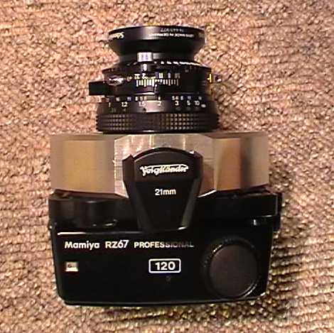

I was looking for something like you a few years ago, as I had sold my SWC, so I made myself a 6x9 Wide on a rainy Sunday, by repurposing a 58mm Omegon and a Mamiya 6x9 back. Lighter than the SWC, 1/10 the cost, 50% more real estate film-wise, focusses to 36cm (±1:7), ~ same width of field....superb image quality....I'm pretty stoked: I called it "Purple Haze V".

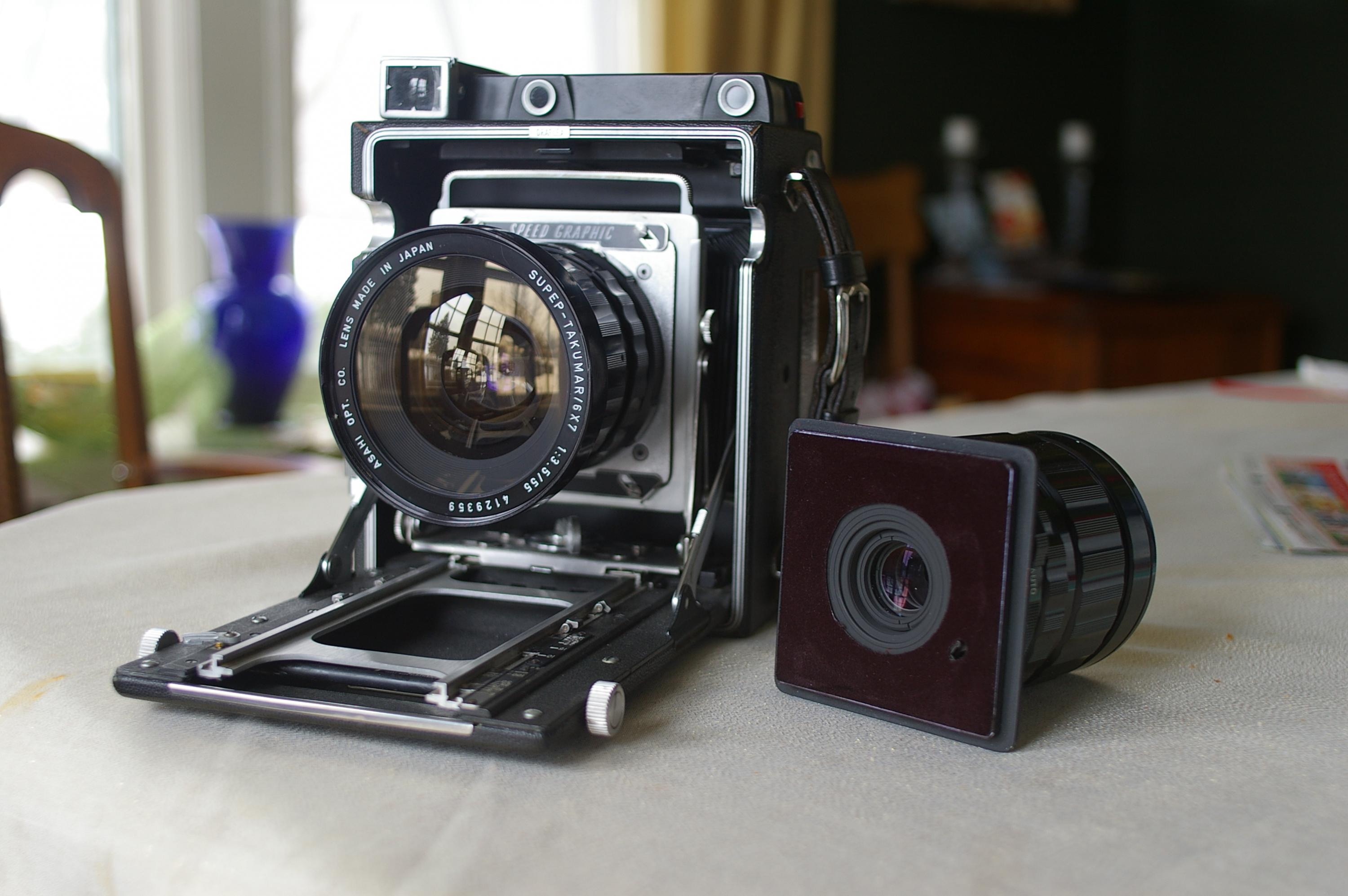

DIY 6x9 Grandagon 45mm
as i wanted to get wider than my 6x7 with a Schneider SA5.6/47, i got a lovely Grandagon 4.5/45 and attached it to a SuperRollex 6x9 from Linhof
-> affordable & quality is beyond reproach

Eh? Wot? The 47 SA covers 6x9, a 45 Apo Grandagon sees only 2.5 degrees wider on 6x9 than a 47 does. FWIW, I have a 47/5.6 SA and a 45/9 CZJ Goerz Dagor. And I shoot 2x3 (same thing as 6x9). The difference in angle of view between the two isn't worth the cost of a second lens.
Affordable? Apo Grandagons? I wish I were as rich as you.

rich? sold one of two selfmade bodies with SA47 for 100€ more than i had to spend on my Grandagon - increase of angle is caused by 20mm wider sensor ;o)
the old one:
