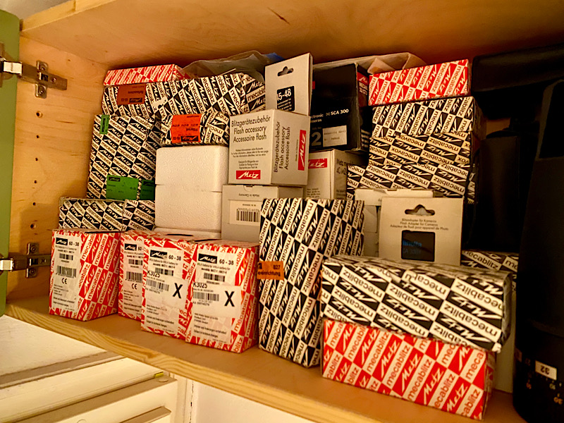

I was so fascinated by the Metz system with its SCA adapters for using the flash units with various camera manufacturers that years ago I collected.

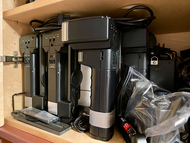

Another issue when storing flash units is the condition of the flash capacitor.
It is often recommended to fire the flash every month, which becomes difficult when you have a collection 😌
On the other hand, I have never seen flash units break after being left inactive for a long time.
How do you look after your electronic flash units?

I take them out every 6 months and plug them into a power source (Quantum Turbo battery pack) and turn on each and leave each turned on for one hour, to keep the capacitor formed. I have owned both 45CT units since the early 1990s and both are fully operational with no known issues. I have a Metz Mecablitz 45-46 so that I can put the 45CT into a 16" x 20" softbox (which obscures the view of the photosensor) and the 45-46 sees the scene to shut off light output at the proper level. I have owned the two 54MZ4 units since the mid-2000's and the 64AF-1 since about 2016, and all are fully functional. Metz flash units are superb flash units.

'long' time in this case, means a few decades. Modern capacitors don't die in a year or two. Weakened capacitors can be refreshed by charging the strobe until the ready light comes on and then leaving it that way for 20-30 minutes. Firing the strobe a few times once a quarter or so also helps keep them working as they should. Equipment maintenance is a boring and often time-consuming process with advantages, but there is no reason to turn it into an obsession.

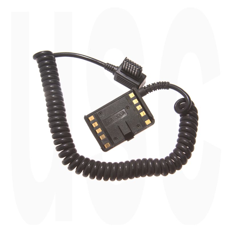

You would no happen to have an extra SCA 300-a cable? Paying $$$

At the time, I had collected everything I could find about the Metz system, as long as it was compatible with my cameras.
Should I look in the cupboard?
If you have the SCA-3000C cable and SCA-3402 I would want to buy. I have them both but they are bad now. I don't know why. Just not working any more and I don't know if it's the cable or the module. I haven't used it in a long time as it only support TTL for Nikon film camera and not digital.

Wanted to get an AC Mains adapter for my CT-4 and CL-3 units but they are Rare as Hen's teeth ! The one for CT-1 series does not fit -- the plug is DIFFERENT .
