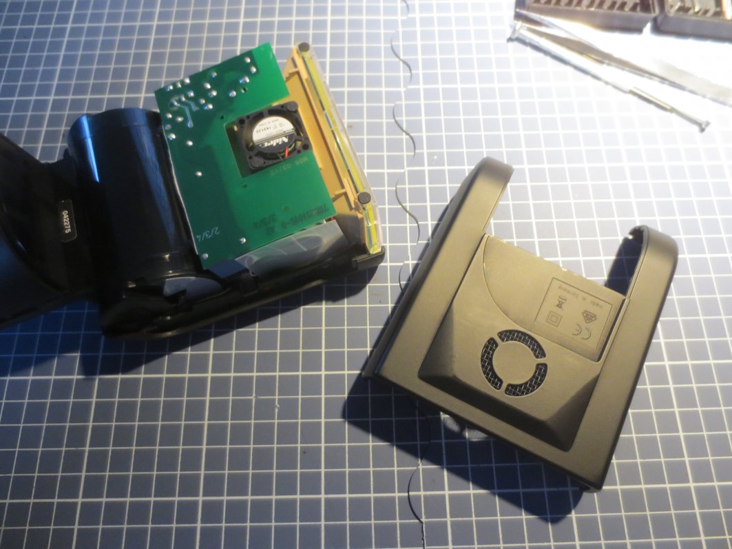

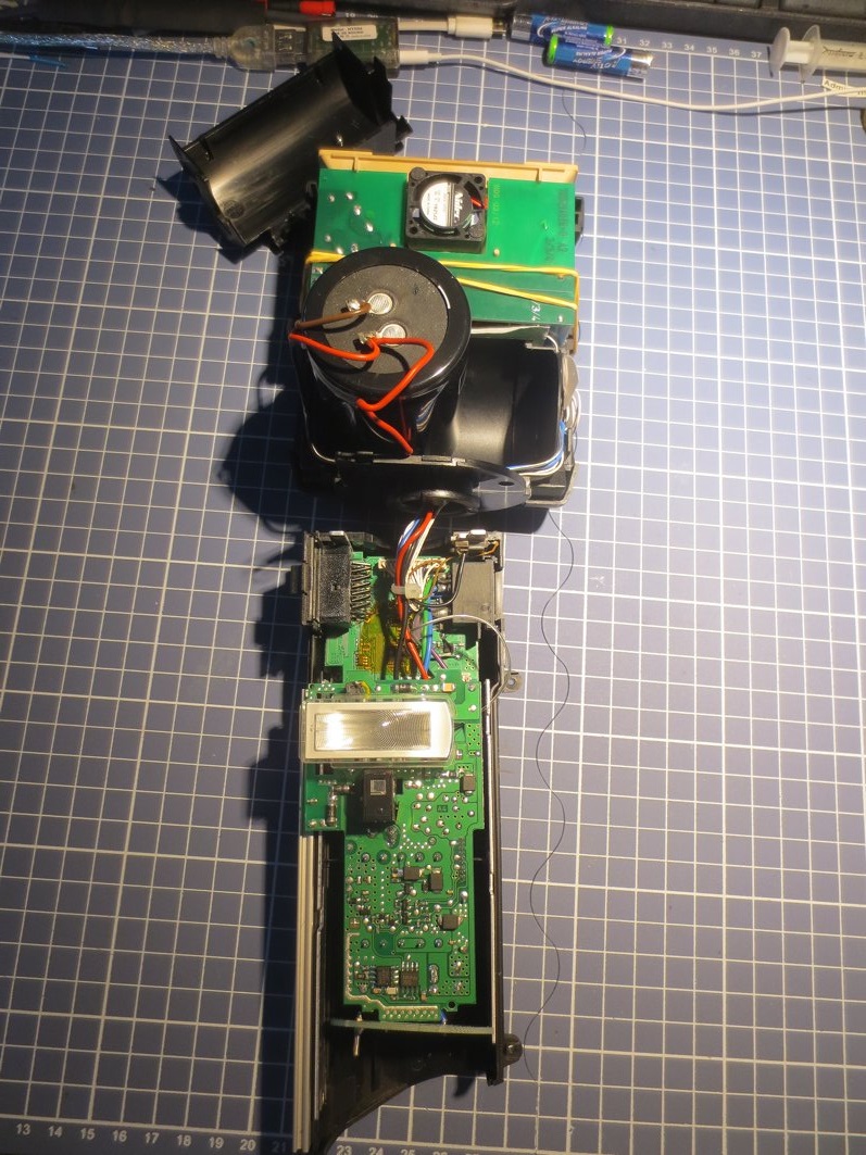

i managed to open the unit without damaging it ,
turns out the capacitor is in the head .
now to find out the way to get it out .
i have made numerous pictures , so if someone is interested download the zip .
  • metz 76mz-5 disassembly pt 1.ZIP
  • metz 76mz-5 disassembly pt 2.ZIP

Now , how to get to the capacitor ( which has NO load ) without damaging the plastic structure
Is there another hidden screw ??
again any help highly appreciated .

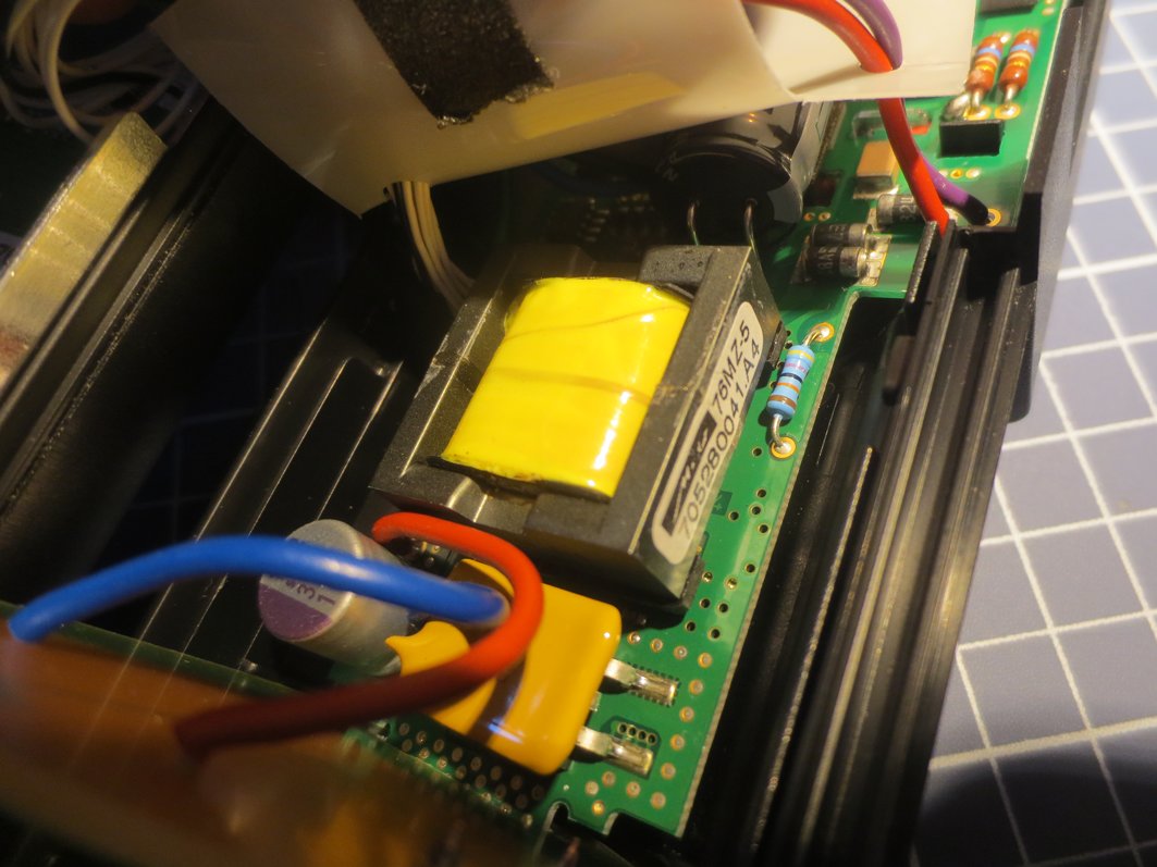

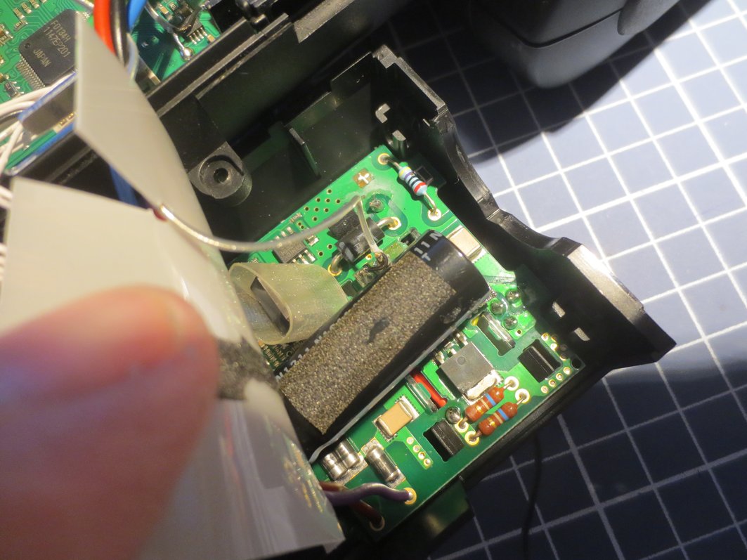

What's the capacity and rating of the electrolytic in this image?
If that's the case, you could do some elementary measurements on it without removing it. Just desolder one of its leads and perform a capacity measurement on it with an appropriate meter. I use a generic but relatively modern Chinese DMM for this.
However, in my experience with circuits like these, other parts are at least as likely to die. Especially the charging transistor, which I assume is probably a MOSFET given the relative modern electronics. If I were to hazard a guess, the TO-220 component sticking out of the PCB next to the long electrolytic I asked about before is probably the switching transistor that switches the primary side of the transformer. I'd pry off the insulation off of that one, see what type it is and do some measurements on it; especially check for a short between source and drain if it's a MOSFET. Also measure the resistance of the large, rectangular yellow PTC which likely protects the primary circuit from excess currents. These PTC's sometimes die with no apparent cause or side-effects.

the sticking up component is a ;
G4BC40W-L bipolar transistor specific for switch mode power applications
the similar component on the other side of the capacitor is a ;
8G103 bipolar transistor specific for flash applications
The ptc is an ;
RGEF800 resettable fuse
- no resistance measurable

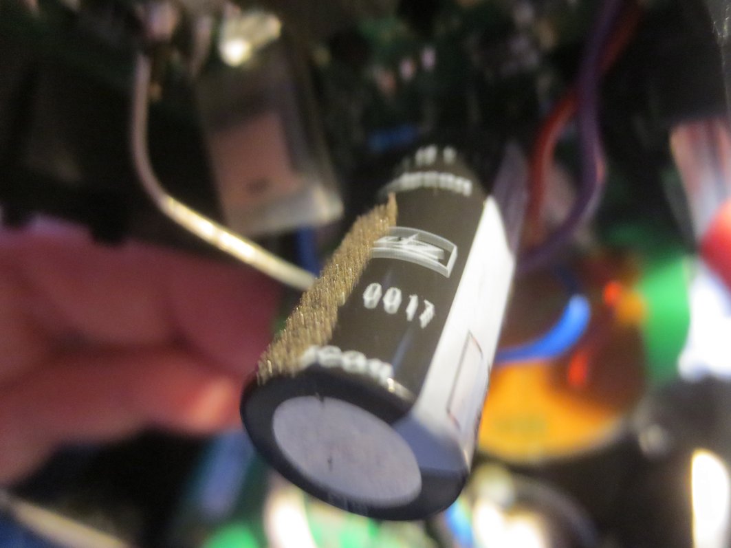

long capacitor next to bipolar transistor ;
metz 331 48 0017
measures around 145 uF

Sounds plausible; what does the text on the capacitor say? You might have to bend it upwards to read the text that's on the PCB side. Caps like these will always have uF and voltage ratings printed onto them as well as a polarity mark.
Btw, upon consulting the user manual for this unit I suspect this particular cap is probably for the auxiliary reflector/flash tube that's in the handle underneath the swiveling head. It's evidently too small for the main flash cap.

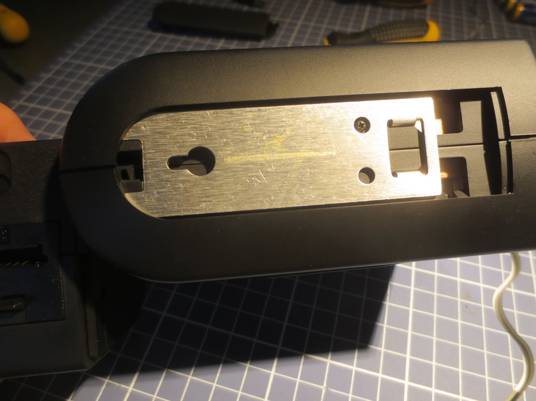

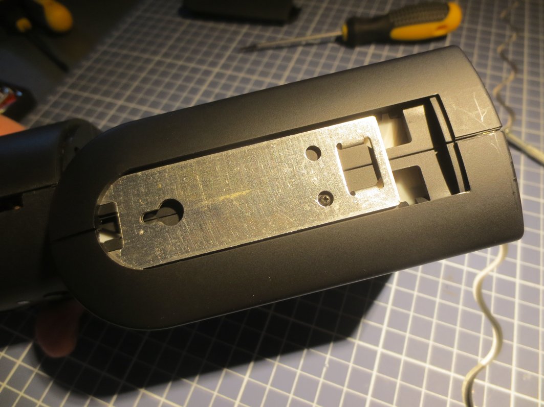

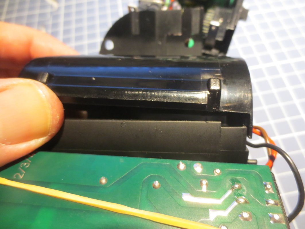

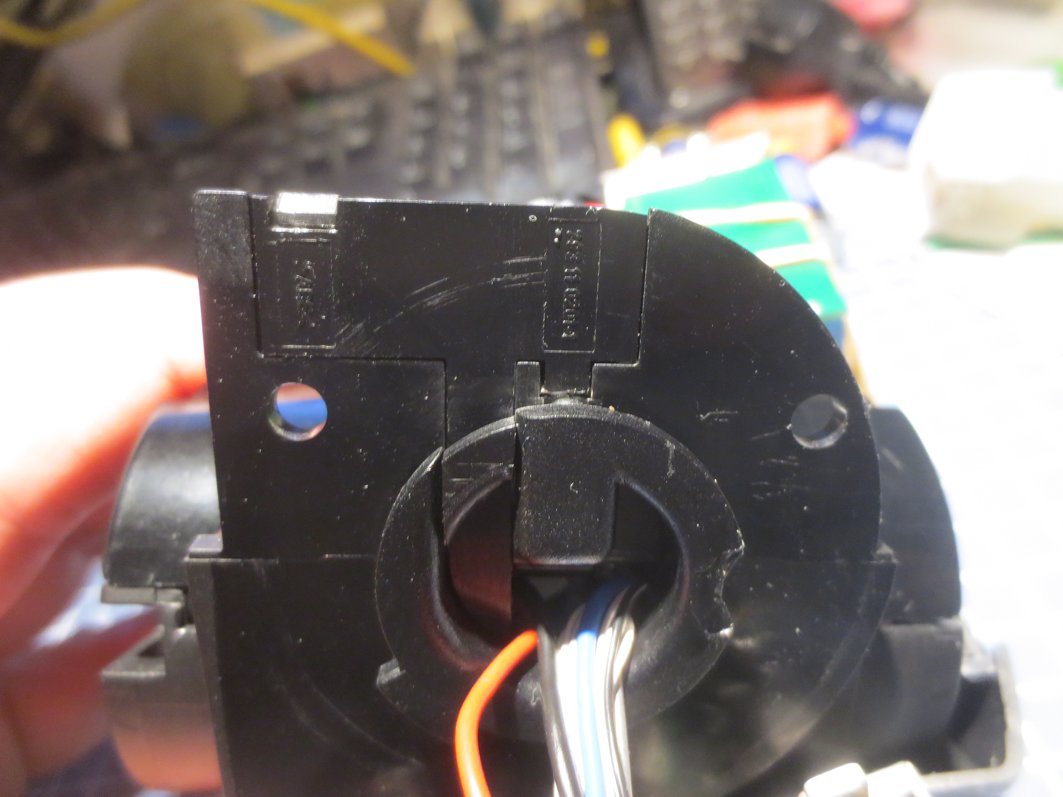

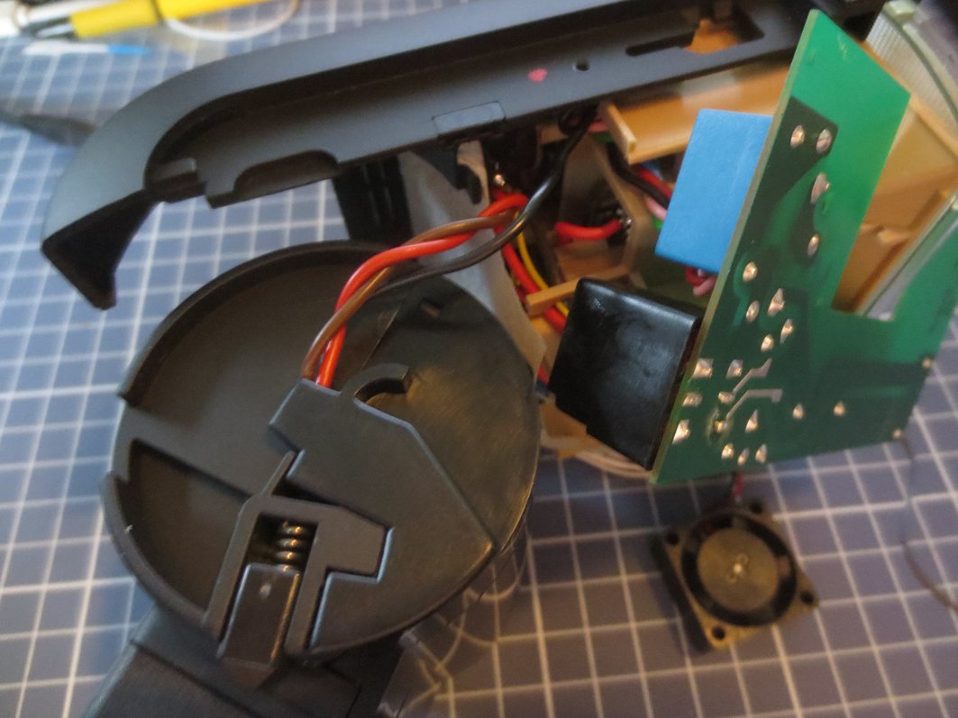

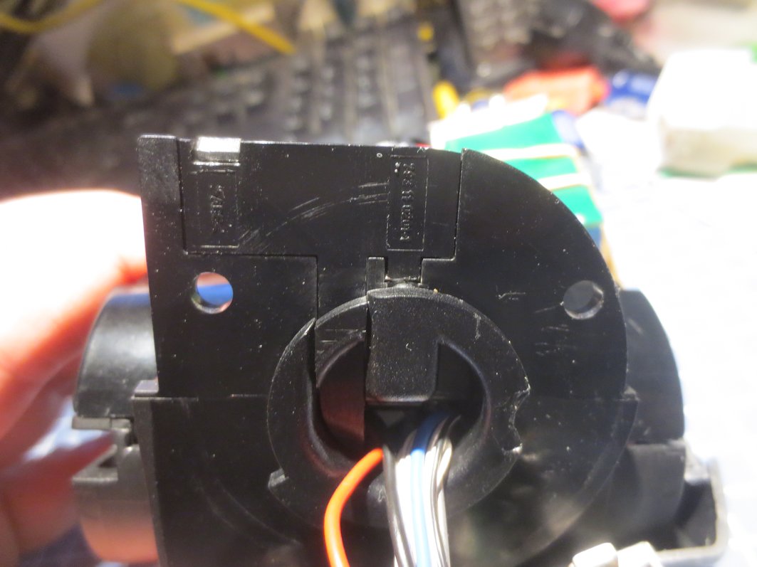

i would like to get access to the main cap .
that part of the disassembly is rather unclear and it interlocks in a rather specific way ( unfortunately ) .
if i could open its compartment it would be possible to measure .
helaas niet open te krijgen
koraks
Nov 29, 2018
26,134
Europe
Yeah, that's annoying. I don't have one of these at hand either so I can't help with that bit. I usually try to pry along the different seams of the components and see where they start to separate, and then figure out from there how it's supposed to go apart.
But I think you should be able to measure the main cap without prying open that compartment provided that the red and brown leads are the ones to go to the main cap. The polarity one should be able to deduce from the PCB connection; it's either marked explicitly or it can be deduced from the circuit. Do you have a photo of where red & brown go into the PCB?

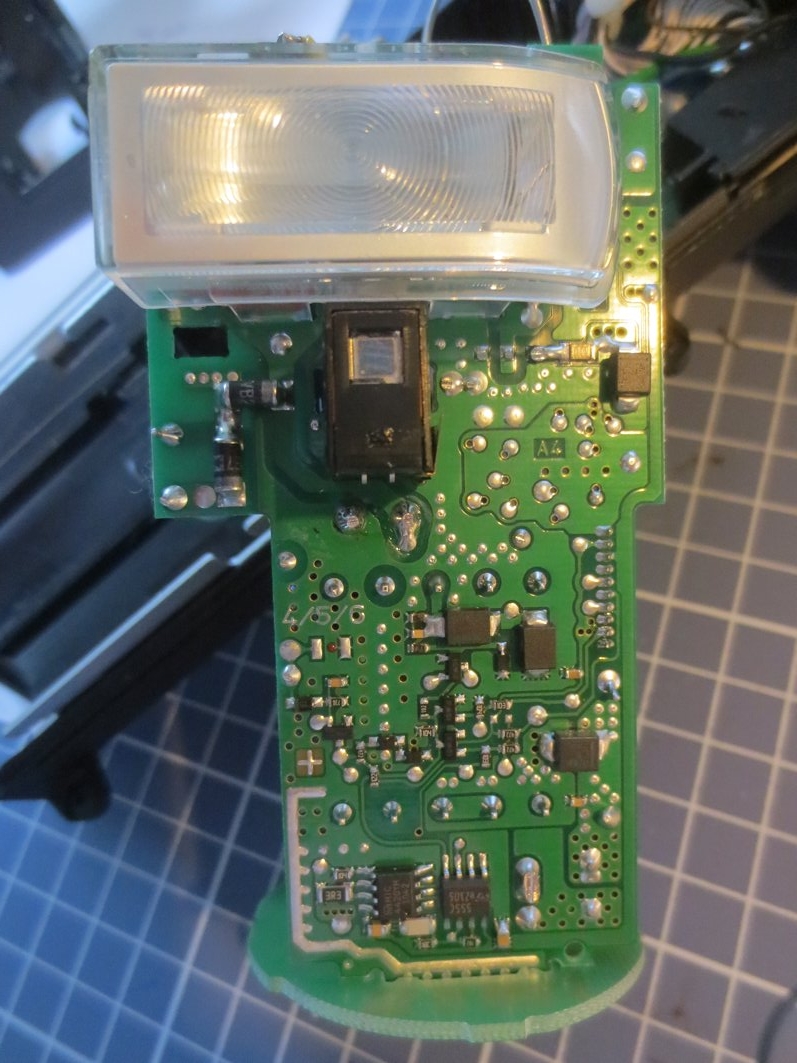

Btw, it shouldn't be too difficult to draft a schematic for (most of) the charging circuit. It seems to be localized mostly on that single PCB, which appears to be only doublesided (no hidden layers) with relatively few components. I'd be tempted if I had it in my hand...

In a parallel track I'd inspect that charging PCB to figure out what kind of active safety they use to control the charging process. Some insight into that would help to verify it's a dead cap or a different malfunction.

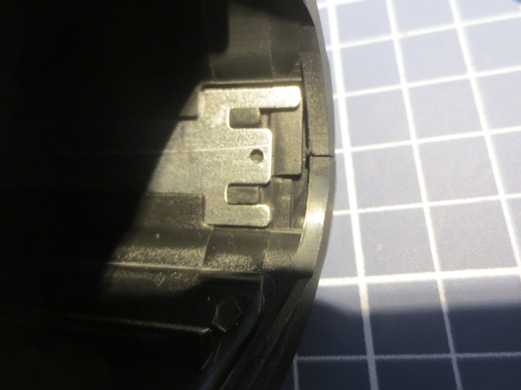

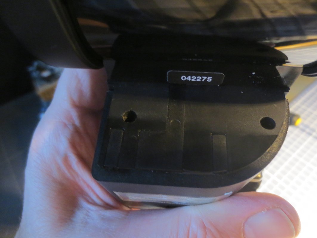

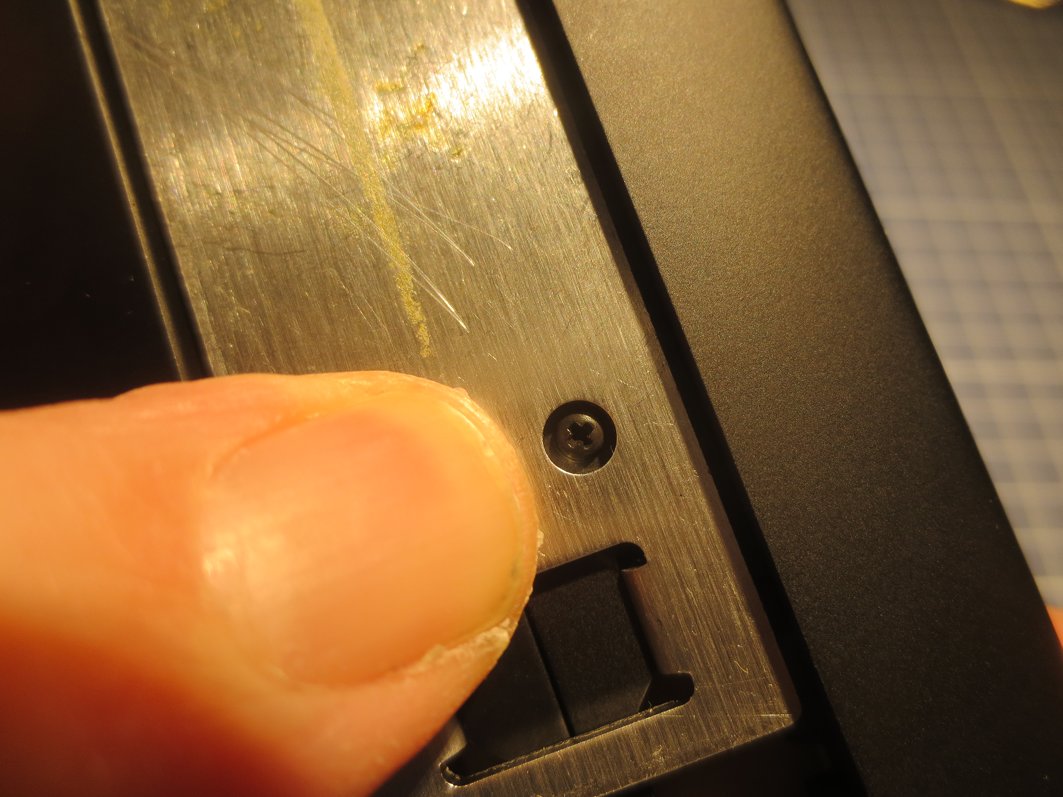

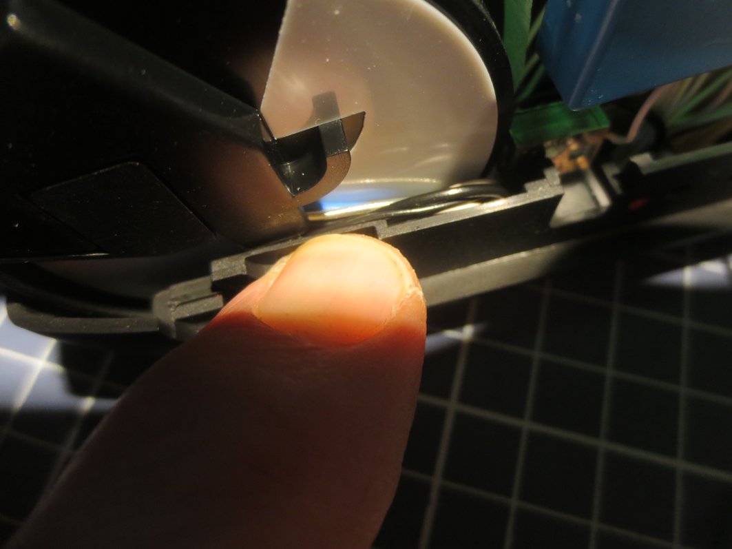

the problem now ;
how to get to the capacitor ,
i can open its holder a wee bit , but it certainly is not the correct way to open it as i need to put on much more force that is good for the design .
i think the turning-mechanism of the head has a clever design to take away a part so the locked bit of the cap-holder can be removed .
as my aim is to repair the flash i need to be gentle here .

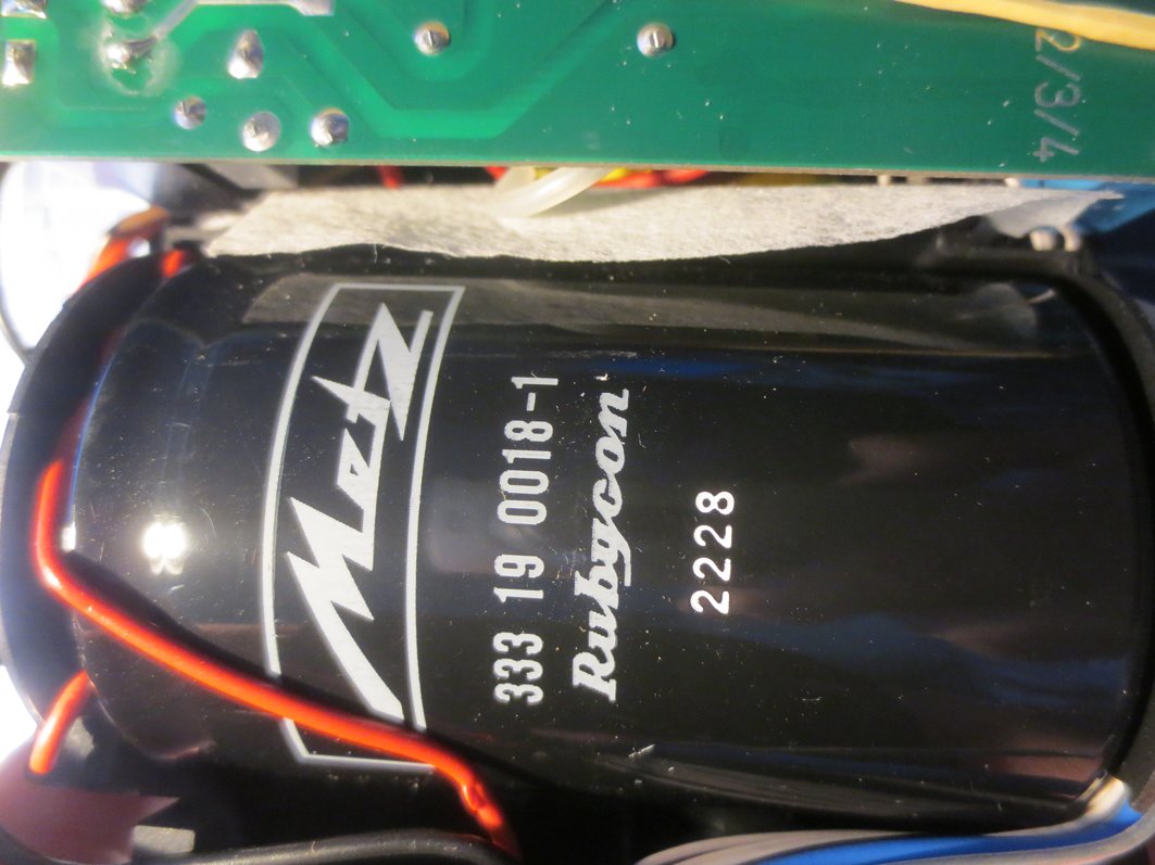

unfortunately the part of the cap i can see does not have any marking on it ................
sadmetz76
Dec 27, 2022
15
europe
Digital

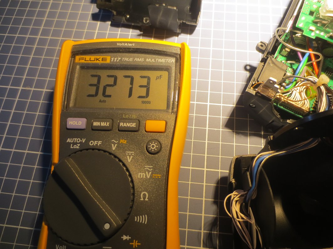

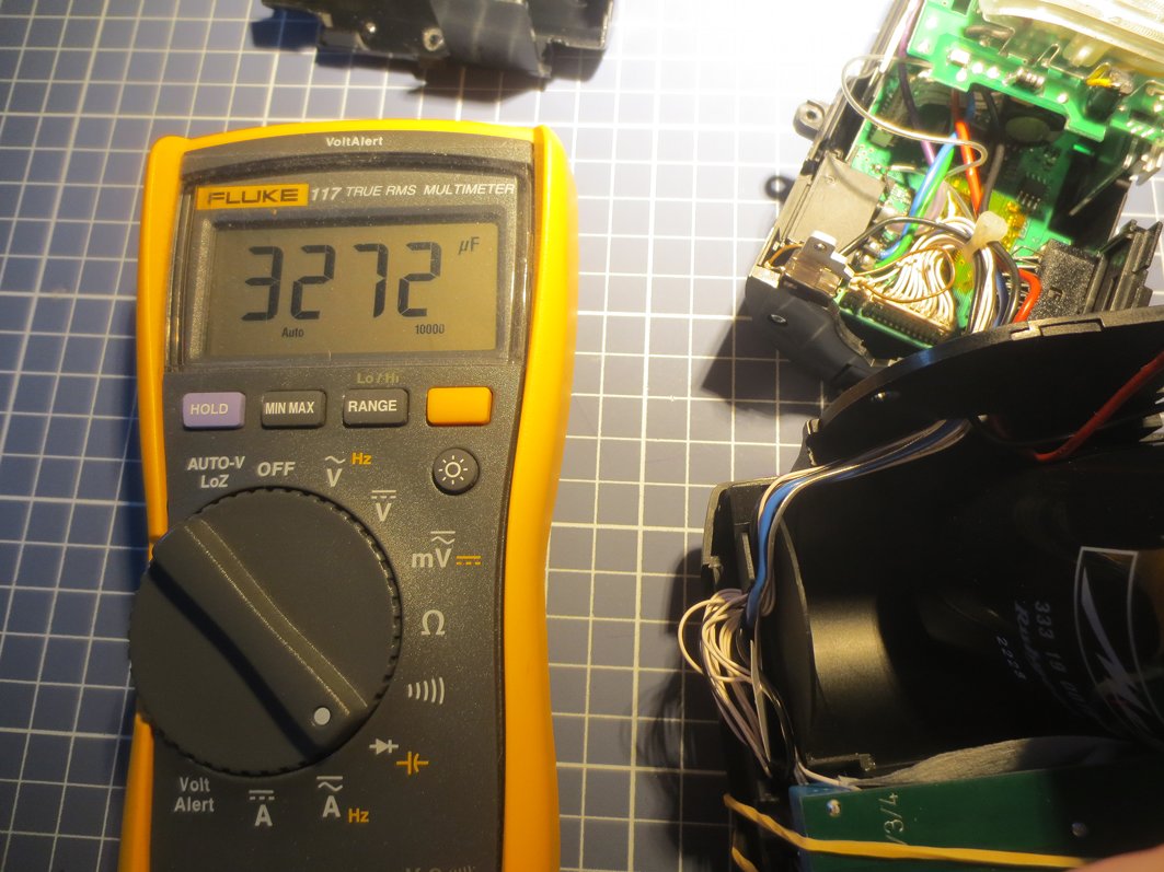

Hi forum ,
so i finally managed to open the cap holder ,
so , as i can only see the cap looks okay at 3300 uf , it was 0 Volts .
what will repair this flash ??

Yes, looks OK, but there's a slight chance it doesn't perform the same under high voltage. However, given the measurement you've got, I wouldn't prioritize a goose chase in this direction at this point.
Have you scoped the charging behavior? And performed some measurements on the switching FET at the primary side of that HF charge transformer?
