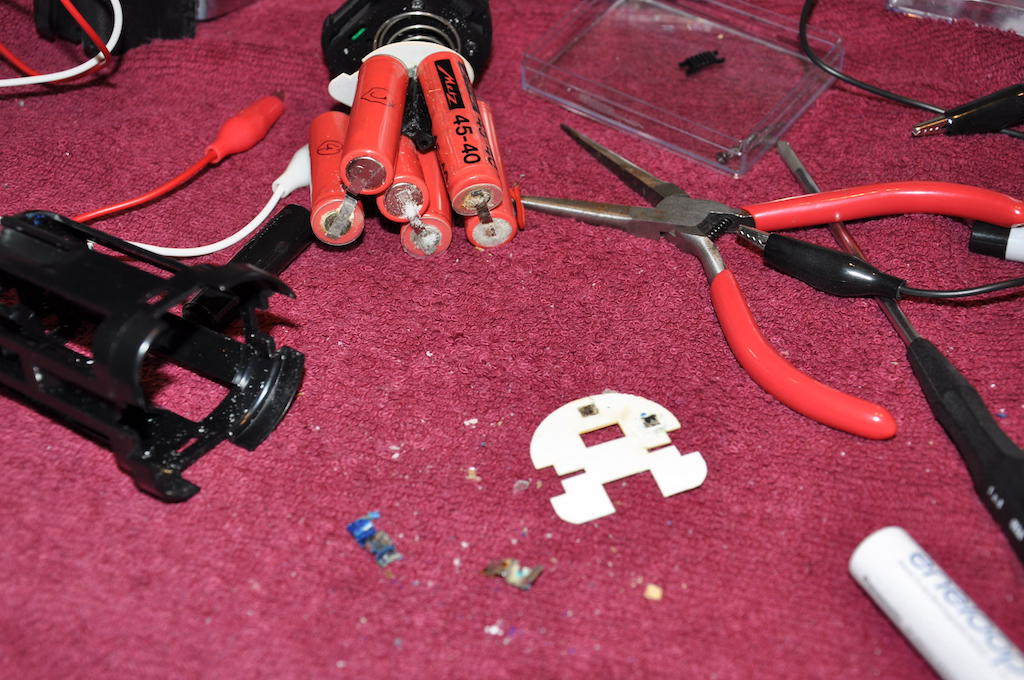

It came with the Nicad pack that was leaking and corroded. Even the negative wire (blue) corroded through and broke.
They did make a five AA pack but they are not easy to find. One on ebay for $50.
I think I'll replace the cells in this one.

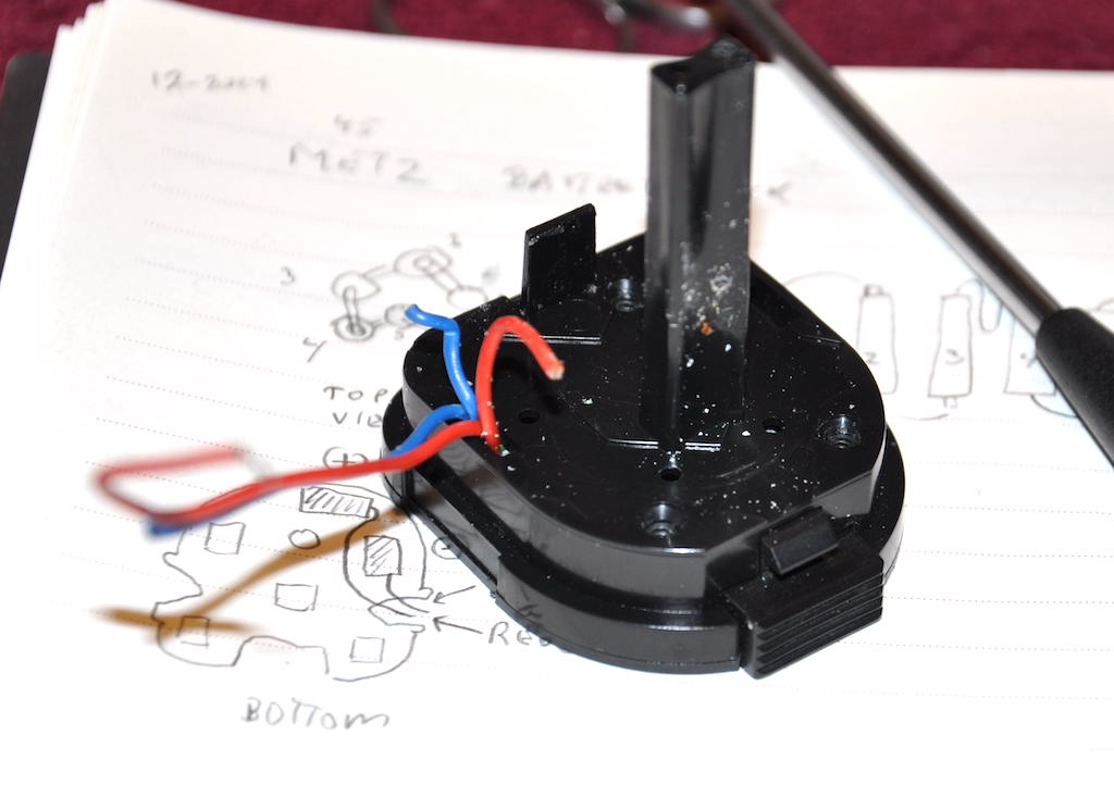

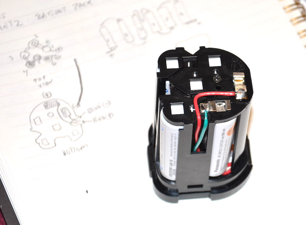

I took the pack apart and made notes on the battery orientation, wiring and location of the insulating pads.

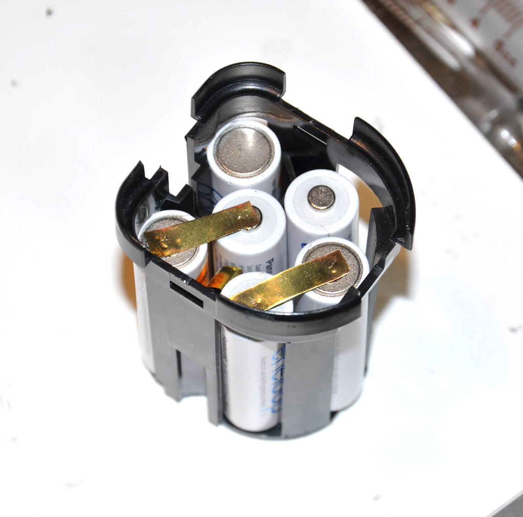

I soldered five Eneloop batteries together in the same configuration. The Eneloop batteries are a little bit longer so it was a tight squeeze.

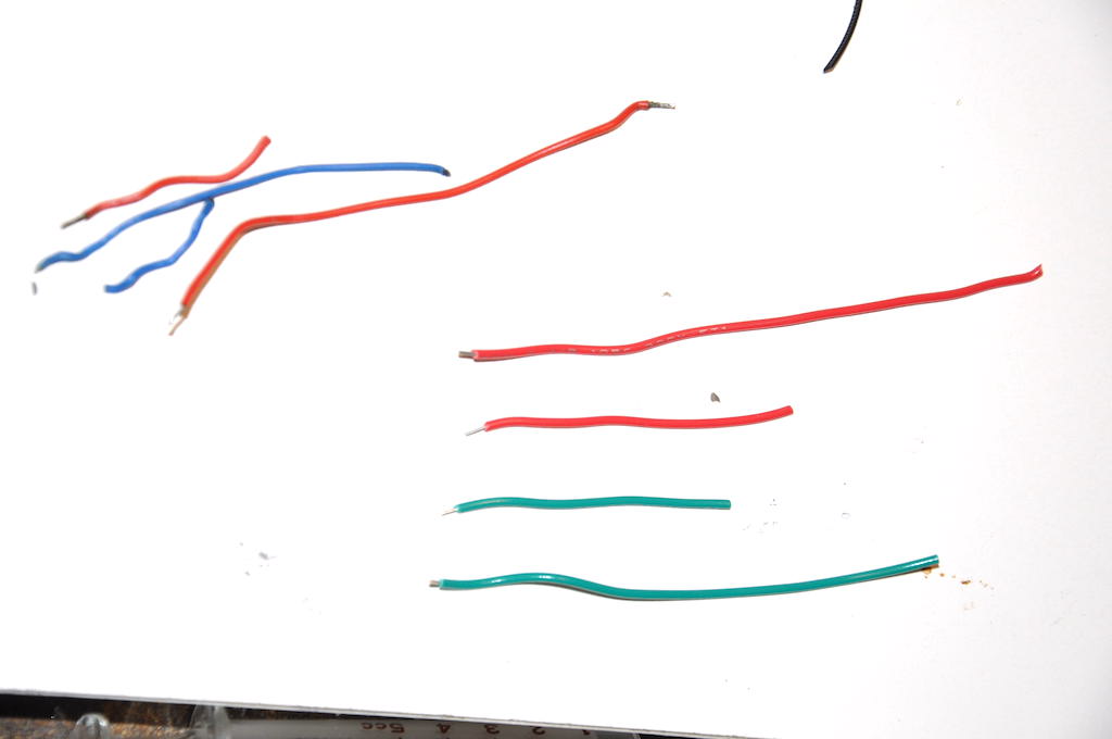

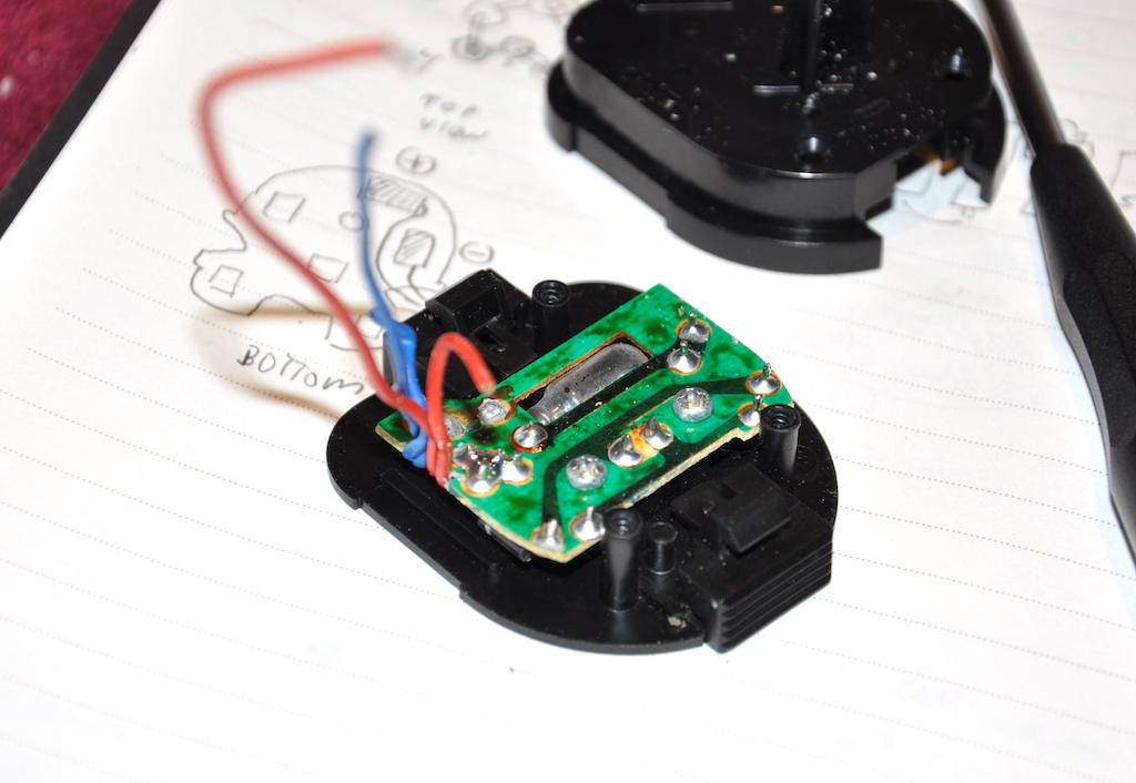

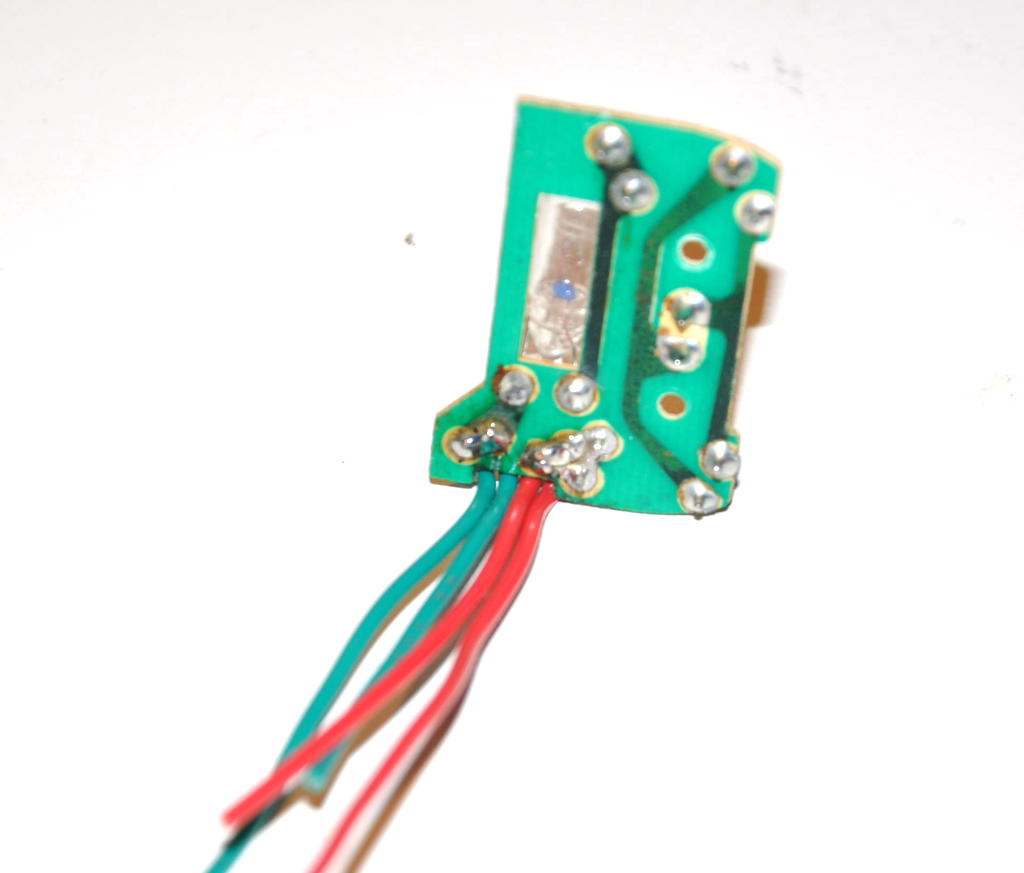

The wires are too short and need to be replaced. They originate in the charging circuit in the base of the pack.
New wires cut to length longer than the old ones. Then soldered on to the charging circuit board.

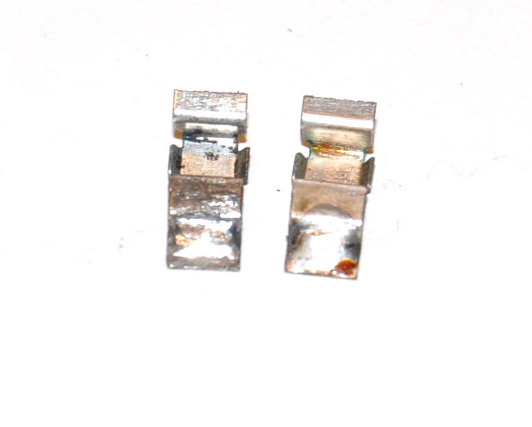

Contacts cleaned, ready to be re-installed in the housing.

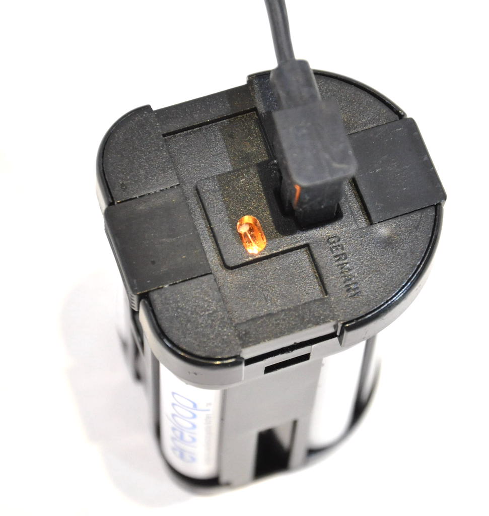

Housing with the new batteries and new wires:
Charging circuit works. Basically just a lamp and a rectifier circuit for the AC power supply with an incandescent indicator lamp. When current stops flowing (the pack is charged) the light has no current through it and it no longer illuminates.

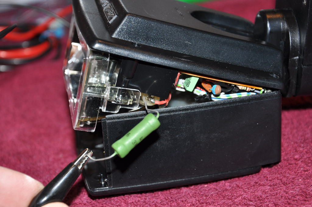

I did take the head unit apart for inspection. Nothing wrong with it.
When working on flash units, be sure to discharge the capacitor through a resistor. This unit had about 300v when I opened it.
In this case the other end of the jumper wire is clamped on the other end of the flash tube. The resistor is touched and held to the end of the flash tube (red wire). After a minute or so it is down to about 20 v.

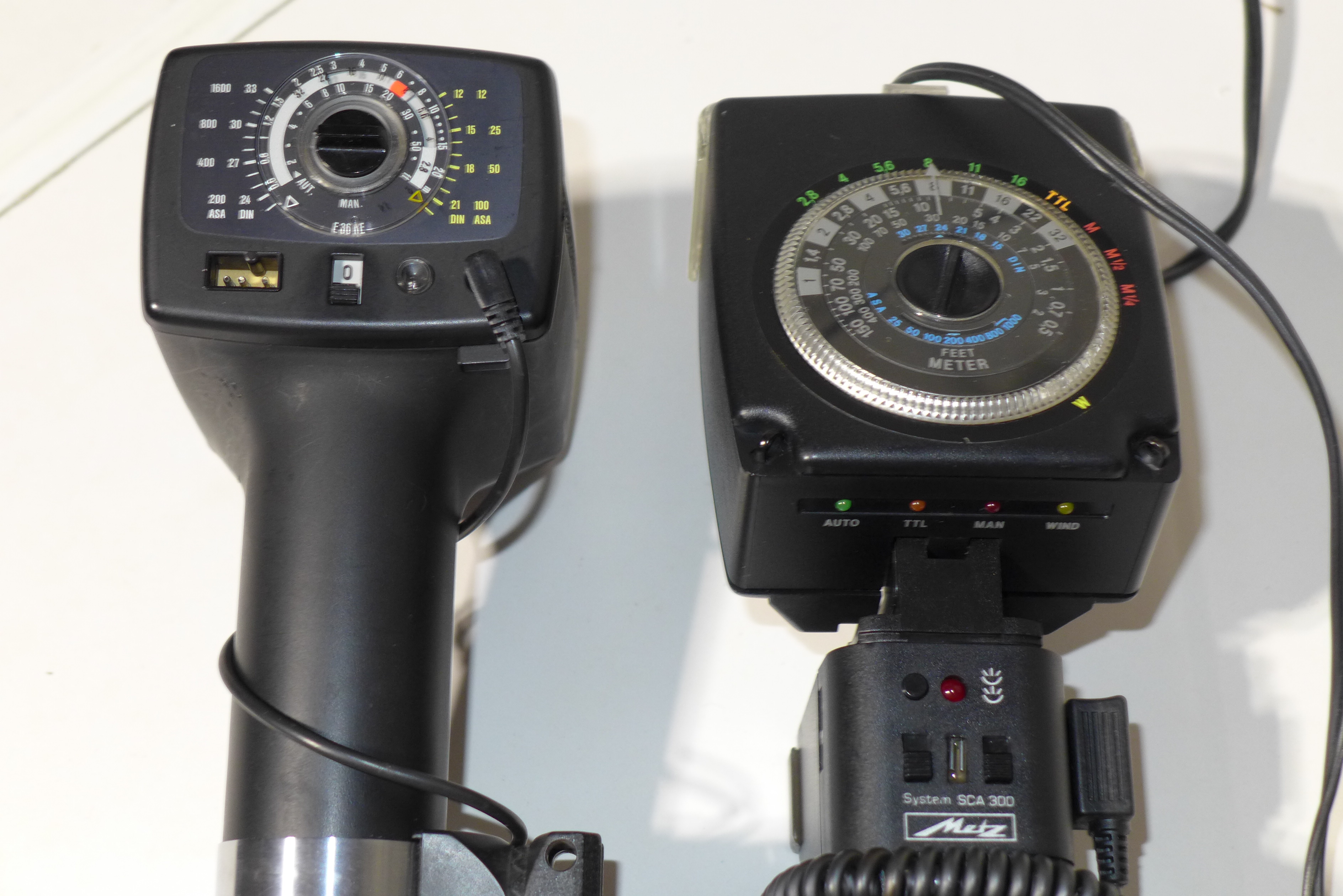

Of note: I took the head apart because the ASA/DIN dial would not turn.
It happens because when the accessory diffuser is in place, the ASA/DIN gets locked in place one stop lower via an automated mechanical connection. This is not really explained at all in the manual.
So, you need to make sure the accessory diffuser is off before setting the ASA/DIN dial.

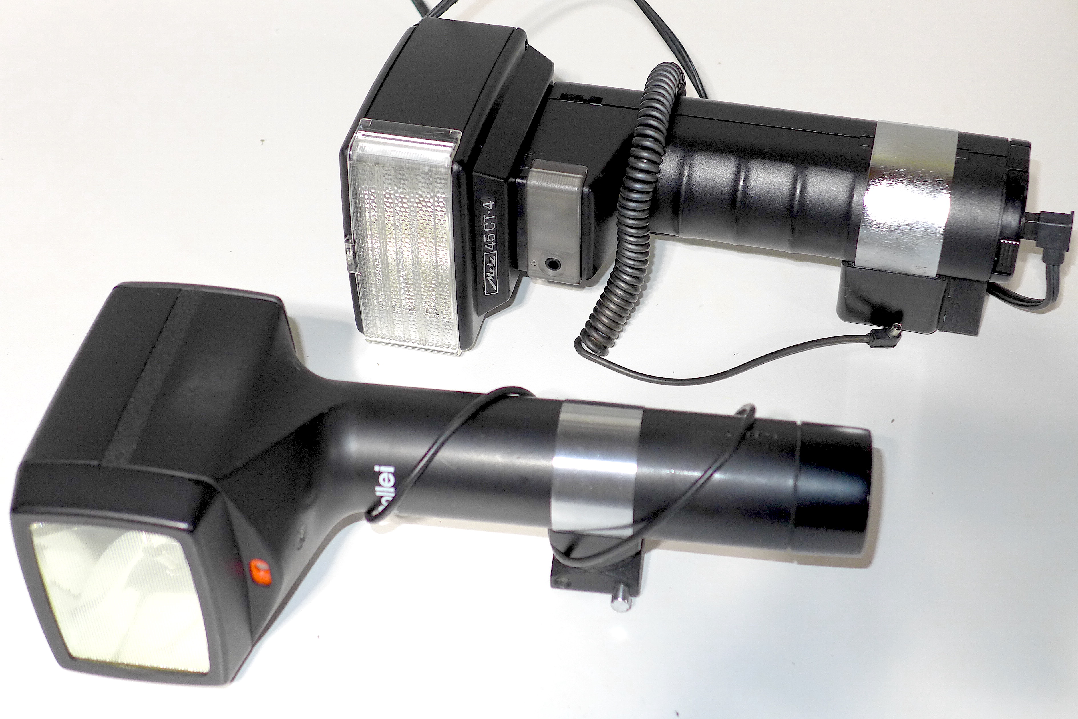

The picture at the beginning of the thread shows the accessory diffuser in place.

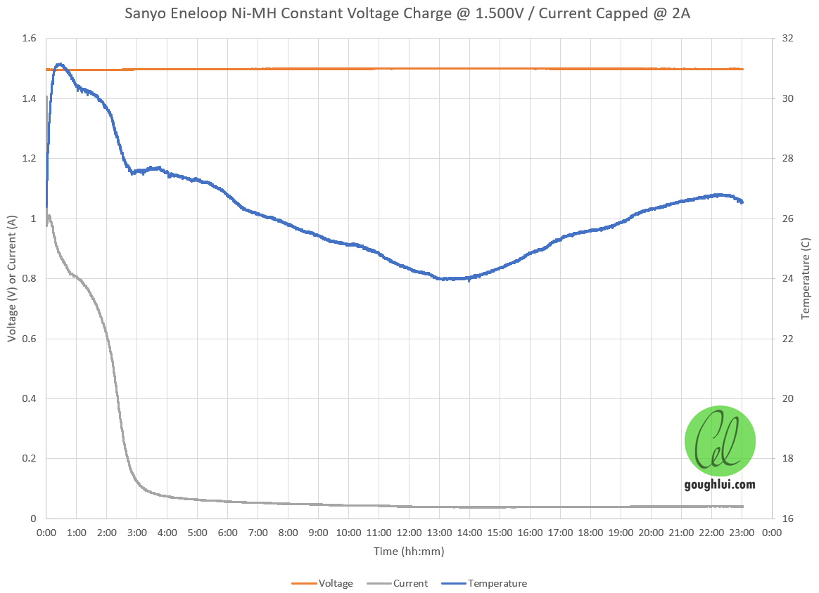

Charging: due to the way Metz designed the system, the charging pegs on the pack only accept an AC 'float' charger that is supplied. Sure one could re-deisgn the pack to accept a proper Nimh charger, but not on this busy Sat AM.
I was more interested in seeing how the Eneloops would behave whith this supplied Metz charger. Seems, someone already did the experiment and it seems like it should work fine.
See here (from https://goughlui.com/2019/04/14/experiment-charging-ni-mh-batteries-with-constant-voltage/)
