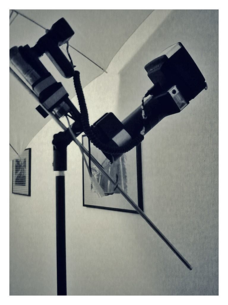

Thanks. I tried to connect NimH rc battery pack 7.2v 4500mAh with pins inside the battery, just beneath the big capacitor.
For reference, I took the below reference.
http://www.pbase.com/dvas/metz_45cl4_battery_pack_conversion
I did not resolder anything like as shown in the above link.
Note: Positive is common for both alkali and NimH and Negative is close to positive for NimH and far for the alkali.
It works great. At full-manual the recycle time is just below 5 seconds.
What is the purpose of avoiding the use of a Quantum? With a Turbo, I could fire my 45CT4 at full power about once each second at a wedding (I didn't fire more than a burst of 2-3 shots, for thermal considerations of heat disspation in the flash).
Well, it costed me Euro 50(Battery + Charger) and 30mins of time. I shoot mostly at home events with metz as main flash with an umbrella and 430Ex II to lit the back ground.
