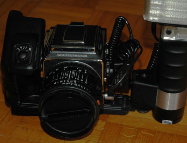

Ok, so I got the SCA 300A (the greek store apparently -did- have atleast one in stock -typical), but is this the way it supposed to go?
I never seen anything more awkward and kludge in my whole life!
If you put the adaptor in the rail with the wires facing the lens, it refuses to go all the way in unless you give it space by turning the ISO dial down and thus locking the ISO at 3200 or 64 (can't see which). If you put it the other way with the label facing front, it goes in but the cabling is all messed up.
