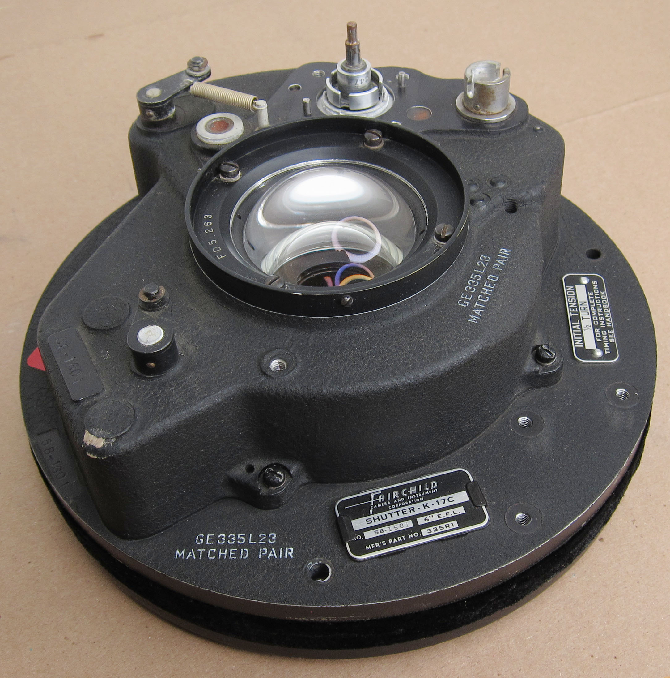

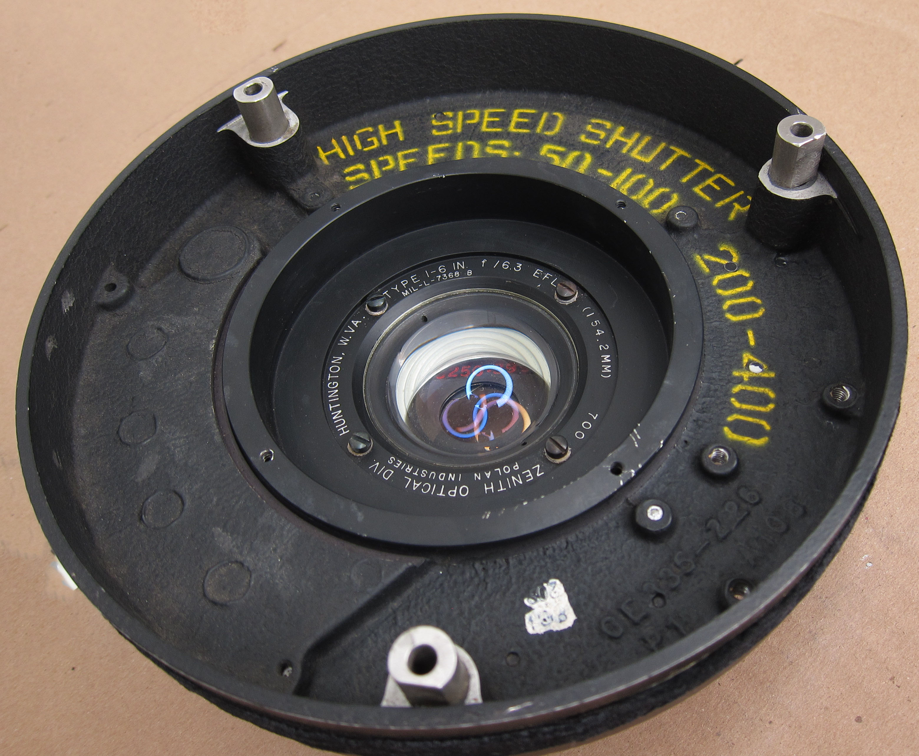

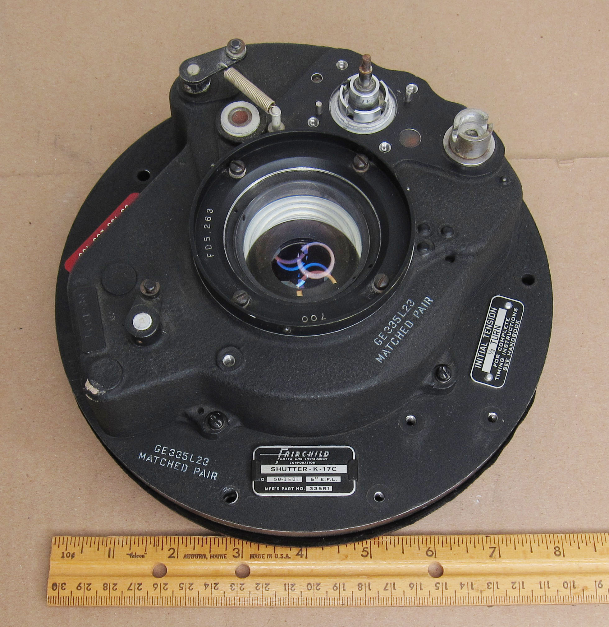

This is a super wide angle 6 inch lens (154mm) in high speed shutter for 9 x 9 inch Fairchild camera.
This lens and shutter assembly weighs about 4 lbs and 8 inches in diameter. The lens is about 2.25 inches in diameter.
I was not able to find out much about this lens, but found a photo of the camera it goes to (last photo).
I don't know if the shutter is working or not. I can open and close the shutter by turning one of the couplings, and also the aperture.
The glass is in pretty good shape with minor scratches and some dust inside. Also small scrape on front lens.

It looks like the shutter spring winder has been removed.
I'm referring to the middle shaft with three concentric cylindrical diameters. I'll call it the shutter 'drive shaft' because I don't know what it's actually called.
To the left of that, the rotary lever with the spring operates the retard mechanism. The degree to which it is rotated from the inward spring-retracted position determines the (slower) variable speeds possible in a normal complete shutter.
With the shutter spring absent, and the retard lever pulled all the way in the opposite direction and held there, the torque required to open the shutter is at its minimum. With those actions taken, you should be able to easily rotate the triple-diameter shaft half a turn to open the 4-blade shutter fully, or at least 95%. Some seem to rely on velocity to overshoot the blade opening on the way to reversing direction.
In that condition, I found with a Torq-Watch that only 0.5-1 oz.-in was required on one Fairchild K-17 specimen I have.
In comparison, a K-18 with 24" Aero-Ektar that has a much larger shutter with more blades, and a different design, a maximum of 9 oz.-in. was needed. On that shutter the retard mechanism is operated by a plunger. With it fully depressed, closed-open-closed motion was accomplished with a full rotation of the 'drive shaft'.
On the K-18, there are a couple ways to make it cycle, one with the double-notched shaft which originally was the shutter firing (discharging) actuator, and without. I was trying to find the simplest way with minimal substitute linkage involvement (without the original motors). IIRC, the K-18 can operate with unidirectional rotation.
In the pictured-here K-17, the simplest least-energy way to make it 'work' is half a rotation to open the shutter, and half a rotation in the opposite direction to close the shutter, without using the slotted firing/discharging shaft.
I am going to try some motor drive ideas with vibration control, now that I (recently) figured out the minimum torque (for smallest motor) for both shutter types.

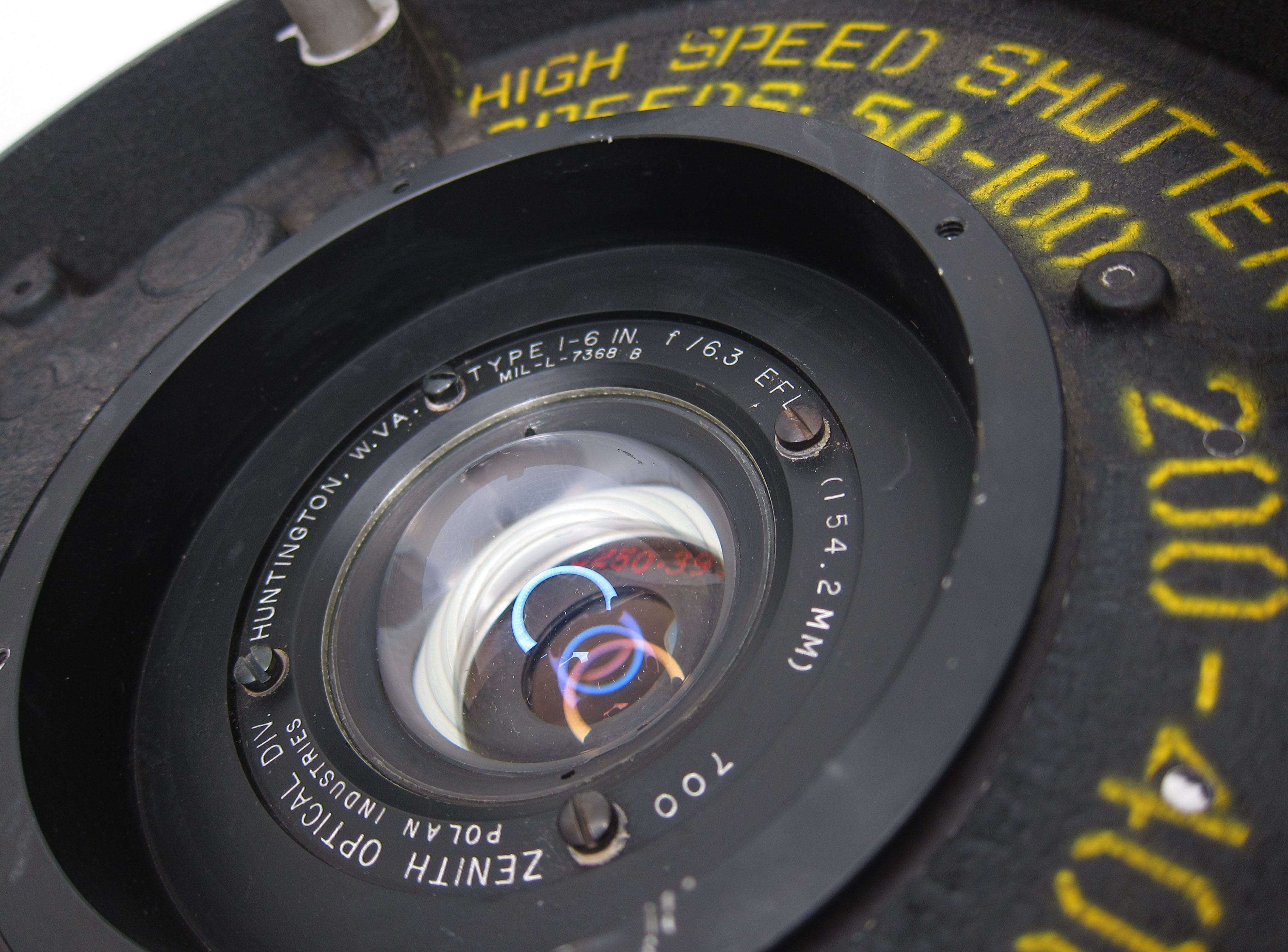

The yellow and red filters used with these for b & w film have a vapor-deposited ND 'central spot' coating to equalize the significant light falloff at wide angles (cos^2, cos^4 or both...I don't remember). That is what the bulb-propelled fan on the Hypergon design achieved...the non stationary blades reduced the intensity of light at small angles off-axis.
I have read of people using Metrogons without such filters. The results are not as-intended, but that doesn't matter for artists who aren't making aerial maps or interpreting the brightness of foliage.
The 6" Metrogon was used to make 9"x9" negatives on 9.5" rollfilm. Previous terrestrial users have been able to expose 8x10 film, with reports of minimal or no movements possible. Box camera sounds good. It's a rectilinear wide-angle lens.
Metrogon glass never used Thorium (great basement project for the winter, right?). It's f/6.3 wide open, so there was no need for (aperture) speed like with the Aero-Ektars.
