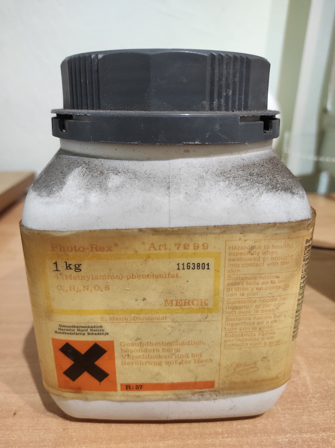

I've accidentally got a 1kg jar of Metol. What kind of film developer can I make with it (not counting other ingredients) if my developers of choice are FX-39 and Rodinal? Beutler's maybe?

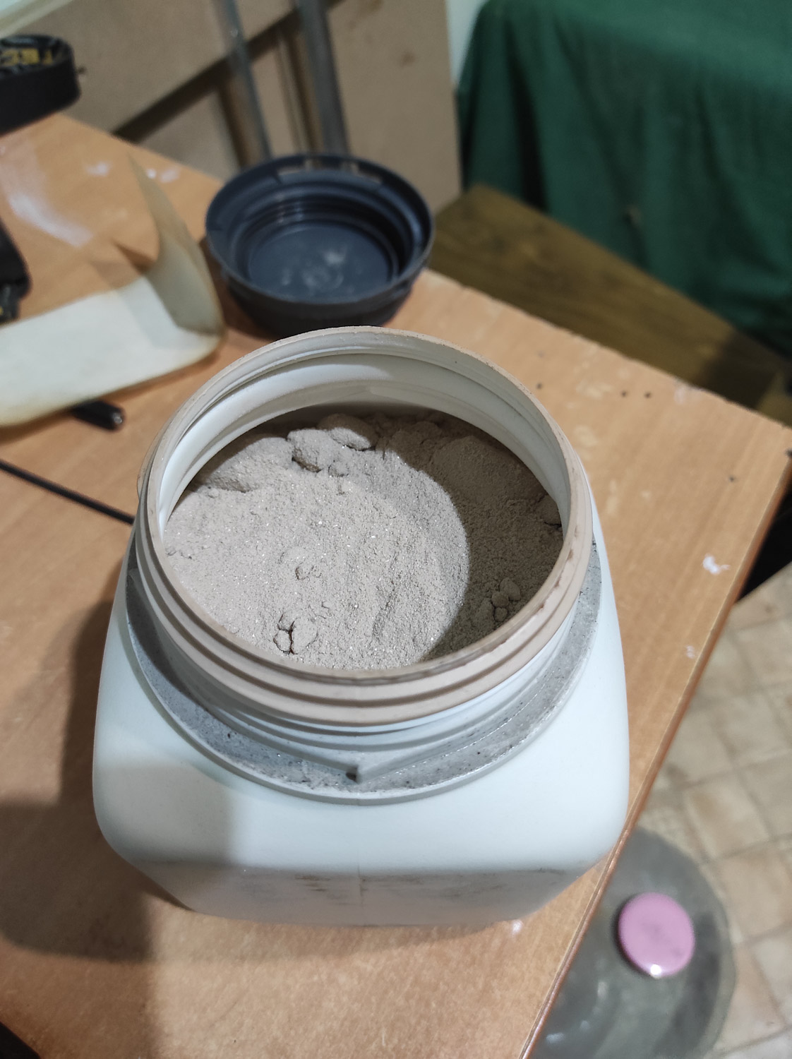

How old i
How old is the Metol?
There is no expiration date on the jar. It was probably prepackaged at some point. I suspect it's decades old. I haven't open it yet to at least check the color

The powder looks warm grey.
It's looking not-great but possibly fine. A kg of metol would last nigh on forever. It took my 6 years to use 100 grams, constantly mixing my own film and paper developer.

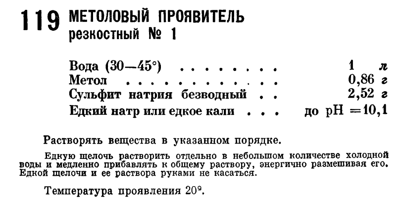

Also there is a recipe I found in a Russian book from 70s
It's called simply "Metol-based acutance developer No 1"
  • Water (30-45ºC) — 1l
  • Metol — 0.86g
  • Sodium sulfite anhydrous — 2.52g
  • Sodium or potassium hydroxide — to pH = 10.1
Dissolve lye in a small amount of cold water then slowly add it to the main solution stirring vigorously.

Also there is a recipe I found in a Russian book from 70sView attachment 353320
  • Metol — 0.86g
What sort of development time would this require? 0.86g/litre is ten or more times more dilute than many other metol developers, so presumably we'd be looking at something approaching an hour?
Well, FX-1 for comparison contains 5g of Metol per litre of concentrate which gets diluted ten times so you'll get 0.5g per litre.
Good point; and actually on reflection I have no idea what concentration of metol exists in bath 2 of a two-bath formulation, because it's limited to what the emulsion can soak up and carry over.
