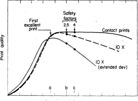

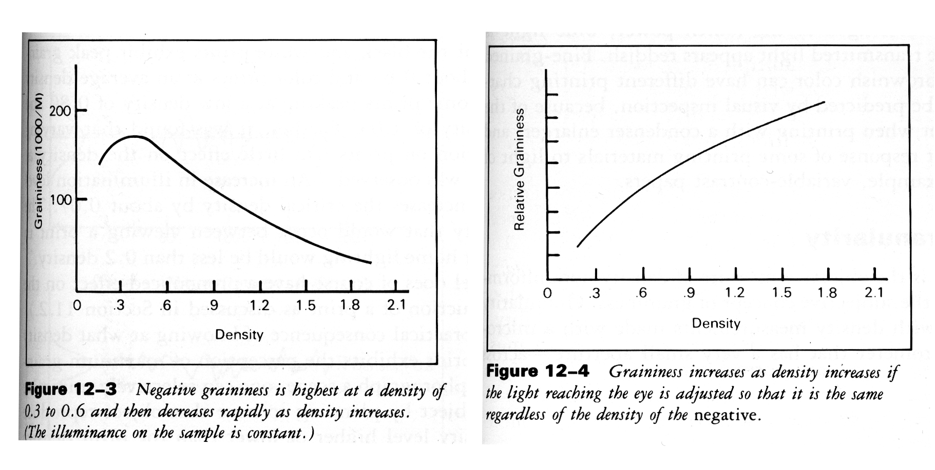

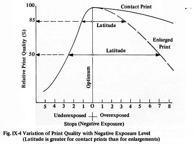

Just an FYI. Below are four graphs. The first two are comparisons of exposure vs image quality. The graph on the top has three situations: contact print, 10x enlargement, and a 10x enlargement of a negative with extended development. The other two graphs are on density and graininess.

markbarendt
May 18, 2008
9,422
Beaverton, OR
Thanks Stephen.
12-3 is interesting.

Thanks Stephen. From the third graph I infer that grain doesn't appear "more evident" in the high-midtones. There actually is more grain to be seen. What is the reason for this behaviour? Is it the fact that the "grains" overlap, with increasing density, thus somehow hiding each other or assuming a more coherent appearance?
baachitraka
Apr 6, 2011
3,651
Bremen, Germany.
3a is obvious. Less the exposure is more the grain not taking the developer and printing into account.
But I don't understand 3b though,.
Diapositivo
Nov 1, 2009
3,257
Rome, Italy
If I get it right, 3 (or 3a) means same light under which you look at the microscope the developed negative when you "count" the grain (which is expressed as a numeric value on the vertical axis). That exemplifies what the enlarger (or the human eye, or the scanner) sees when you look at a certain negative, which has regions of different density. The grain is more present in that interval of density. In denser areas there actually is less grain.
3b (or 4) illustrates the case of placing the same scene in two different regions of the film curve, in two different shots with different exposure. The enlarger has to throw more light at the denser negative in order to obtain the same print (the same light passing through it) and the denser negative gives a grainier print.
(yes the description counts the grain that reaches "the eye" not the paper, that's probably counted with a microscope).
markbarendt
May 18, 2008
9,422
Beaverton, OR
The perception or subjective sense of grain ("graininess") in a print is supposed to peak at reflection densities around 0.4.
So 0.4 means that it's in the highlight half of the curve, so probably one reason people complain about grainy skies more than grainy lakes.
So is this specific effect more about the paper's response or the negative's higher density at the corresponding spot there.
Granularity (the objective measure of graininess) in a silver negative increases with increasing density.
In figure 12-4 that Stephen provided above the grain is measured with a variable light source, given that we don't print that way (where the light reaching the paper/eye would be the same and produce a one tone print) I don't understand the practical value of that test. Is this the objective measure of graininess you speak of? Does this really translate into a difference in the print?

fig IX.4 doesn't tell us anything becasue it doesn't tell us how much neg exposure produces optimal quality. Is it ISO standard exposure for a particular film type or is it some other exposure value. Or to put it another way, does ISO standard expsoure mean optimal negative quality or does it mean film speed which may not be optimal quality.
fig 13.3 is just saying human visual resolution decreases with a constrast decrease.
fig 12.4 is just saying human visual resolution increases with a contrast increase.
Stephen Benskin
Jan 7, 2005
2,745
Los Angeles
Fig IX 4 is just a simplified version of the first graph (from the paper Safety Factors in Camera Exposures). It appeared in Todd & Zakia Photographic Sensitometry. I wanted to include it because it used easy to understand + and - stops from the optimum exposure. It's not necessary to know what optimum is in order for the graph to make its point.
fig 12.3 and 12.4 are from Photographic Materials and Processes. Figure 12.3 is about physical graininess and 12.4 perceptual. As the text explains 0.30 corresponds to a transmittance of 1/2, which represents equal amounts of clear and opaque areas.
