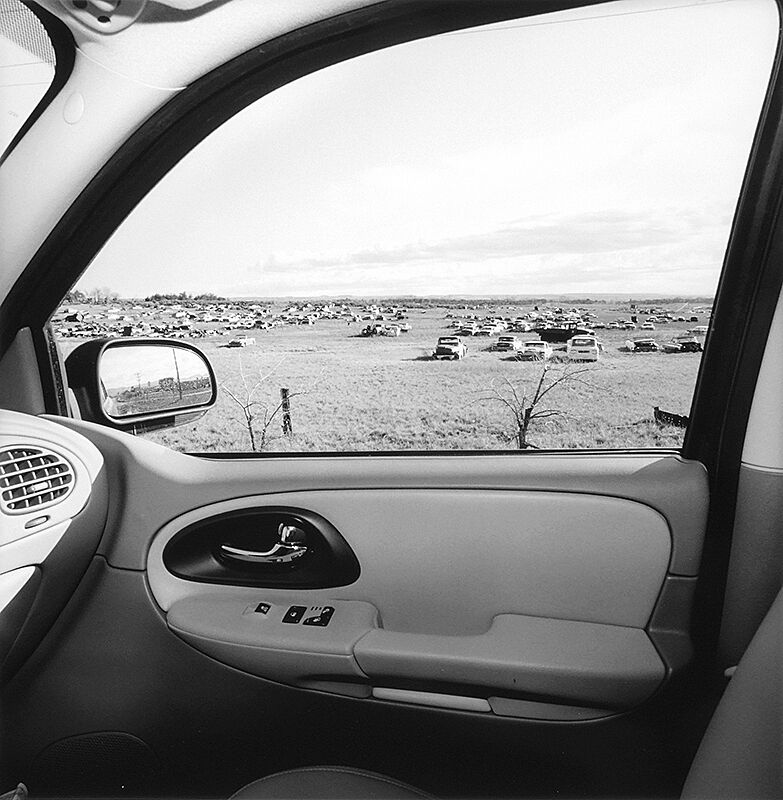

For example, this Friedlander image was made with flash on the camera inside the car. Without that the car interior will be nearly black when making a print to show the outside window with appropriate density. In this case the metering is only out side the window and you have to use experience to get the fill flash correctly. Friedlander is the master of this. I don't think he carries a meter.

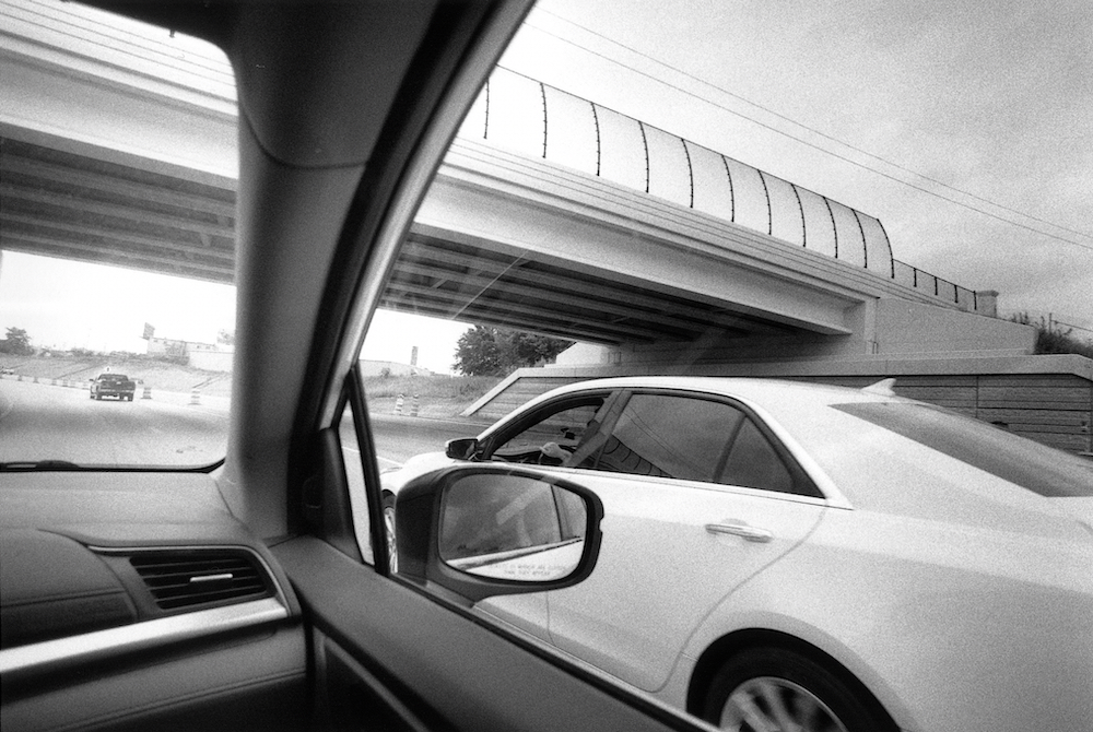

This one was done with N75 and its built-in flash, again with Nikons TTL Matrix metering:

Yes, he photographed non ferocious abandoned cars. Fortunately, no lions. :wink: Actually using a flash like that requires setting it on "Fill Flash". That's similar to the shots where a person has the sun at their back and their face is in a shadow and black. You just want enough fill light to expose his face or the car interior in this case. The window must be rolled down. You can't use flash though the window or it will reflect the flash and ruin the shot.

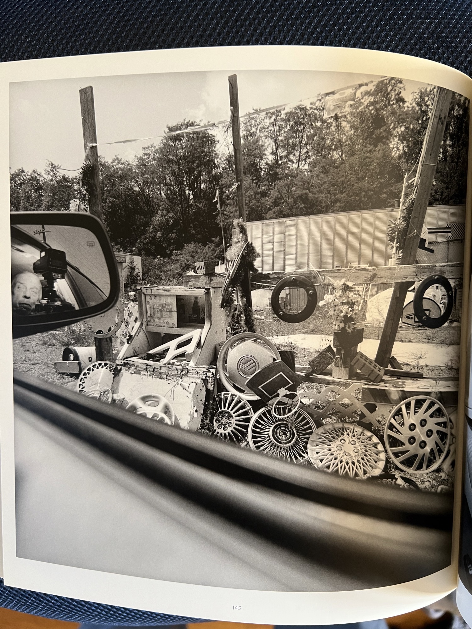

Here's just one (clever) example of his use of flash to illuminate the car interior and/or its contents.

Looks like he bounced the flash off the car roof interior liner. Not sure why, there is very little interior showing.cAnd it looks like it's blasting him in the face. too! But I am jealous you have the book. It is expensive nowadays.
