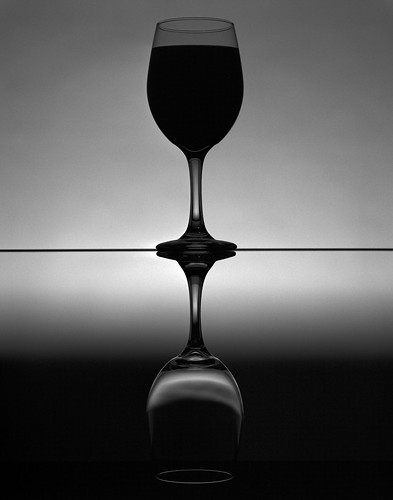

I've been "cheating" on my studio shots recently. I would shoot the setup with digital until I got the results I liked and then use the exposure settings to get the real (film) shot. This time I was determined to use only careful metering and light arangement. Here is the result:
There's a complete description of the setup on the flickr page:
http://www.flickr.com/photos/17555839@N03/4069940644/
Tell me what you think. Any ideas for improvement?
Thanks for any comments.

I like the shot...but "Congrats" are only in order if you managed to get what you visualized in your head before hand. If it was, well done and it was skill that got you there.

Nicely done, but the table edge isn't quite invisible, if that was what you were trying to achieve. One way to do that might be to use a darker background paper, like neutral gray instead of white, and be careful to control spillover from the strobe in all directions, particularly if you're working in a small studio with light colored walls and ceiling.

I just went and scrutinized the print. I don't see the table edge. It's down by the rim of the lower glass. The lower glass is less than 1/4" from the edge because that gave me more working room for the gradient. I wonder if the gradient has sort of a hard edge that looks like a table edge because of having the black bounce too close to the background. I'll have to work on that.

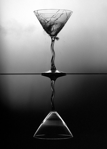

I've tried the gray paper for this shot before. I like the refraction in the glass better with the white background. Here's a shot from my days using a digital camera as a light meter:
The thing that I didn't like about this shot was the inconsistent gradient in the background lighting. It's lopsided. I was going to try this audio trigger shot again now that I like the background lighing method.

Both are great shots.
Would you feel differently if you used a digital light meter?

It could be that the contrast adjustment in the scan is revealing the table edge, which is better concealed on the print. I can see it on my calibrated monitor. Try looking at the print under brighter light.
Are you looking just above the rim of the lower glass?
By the way, thanks for the comments. I'm not just looking for compliments here. I really want to find ways to improve.
Yes, that's where I see it.

Thanks David. I'll take a look on photoshop. I'm sure I'll see it there. It may also be time to calibrate my monitor. I haven't done that yet on the new Mac.

Now that I think about it, another way to conceal the table's edge would be to move the setup forward a bit and use a wider aperture to blur the edge and the background more. That may involve repositioning the camera and lighting somewhat, so maybe just a wider aperture would be sufficient.
It's fairly subtle, and I think most people wouldn't notice it, but I only mention it, because you said that you were trying to conceal the edge of the table.
That's a pretty good idea David. The only limitation to that would be the field that I have to work with on the gradient levels. If I move the glass away from the table edge then the horizon would be higher in the frame.
I'm pretty happy with the way it is now but it would be nice to spread it out a little more consistently. Perfection would be zone 0 on the background at the table horizon and zone VII at the dividing glass with an even, linear gradient between. I considered using a ND grad filter but then it would effect the refraction in the glass.
When I was setting this up I was planning on exposing f11. The background shots were ranging from f22 at the dividing glass to f5.6 about half way between there and the table horizon. My meter wouldn't read anything lower than 5.6. I'm not sure why. Perhaps I should try hot lights instead of flash.
