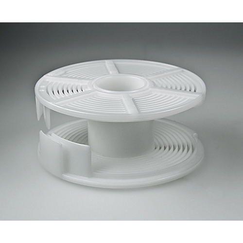

For those that don't like plastic reels - what do you find problematic? Did you had some negative experiences, or just don't like them? So far only problems I hear are from metal ones...
I supposed you could say "negative" experiences, lol.
After I learned to properly use steel, I found it was faster (for me) than plastic. Also steel tanks take less fluid, being wet when loading isn't so much an issue, and they look cooler :smile:
You just have to look up all of the threads about people having issues loading plastic ones. Mine was film getting stuck and not wanting to move up. That was 120 film, I had to use the pencil trick. 35mm would just load half way and get stuck, again pencil trick. Issue with the pencil trick I had to redo the reels every 3 rolls or so. And it's just too much effort to clean the reels, pencil the links etc. I don't need to do it any more and they load much faster. I have LPL reels, for 120 it takes 30sec to load and 35mm in 1min. That's in changing bag too. I have some Hewes 35mm reels coming in, since I bent one and I want to process more reels at the same time.
And like mentioned above, steel reels take less liquid. In my case, 2 x 120 reels use 810ml vs paterson's 1000ml. 4 x 35mm reels use 900ml vs paterson's 1200ml. If you use non replenishing developer, it adds up. Especially in place like Australia, where some chems cost an arm and a leg.
Darko, where I live it gets extremely humid in the summer. 90-95% relative humidity is not uncommon. When it's that humid the film sticks to the plastic of the reels and won't load. Air conditioning? Yes, I have a whole house AC unit, but I don't want to run it more than necessary to save energy.
