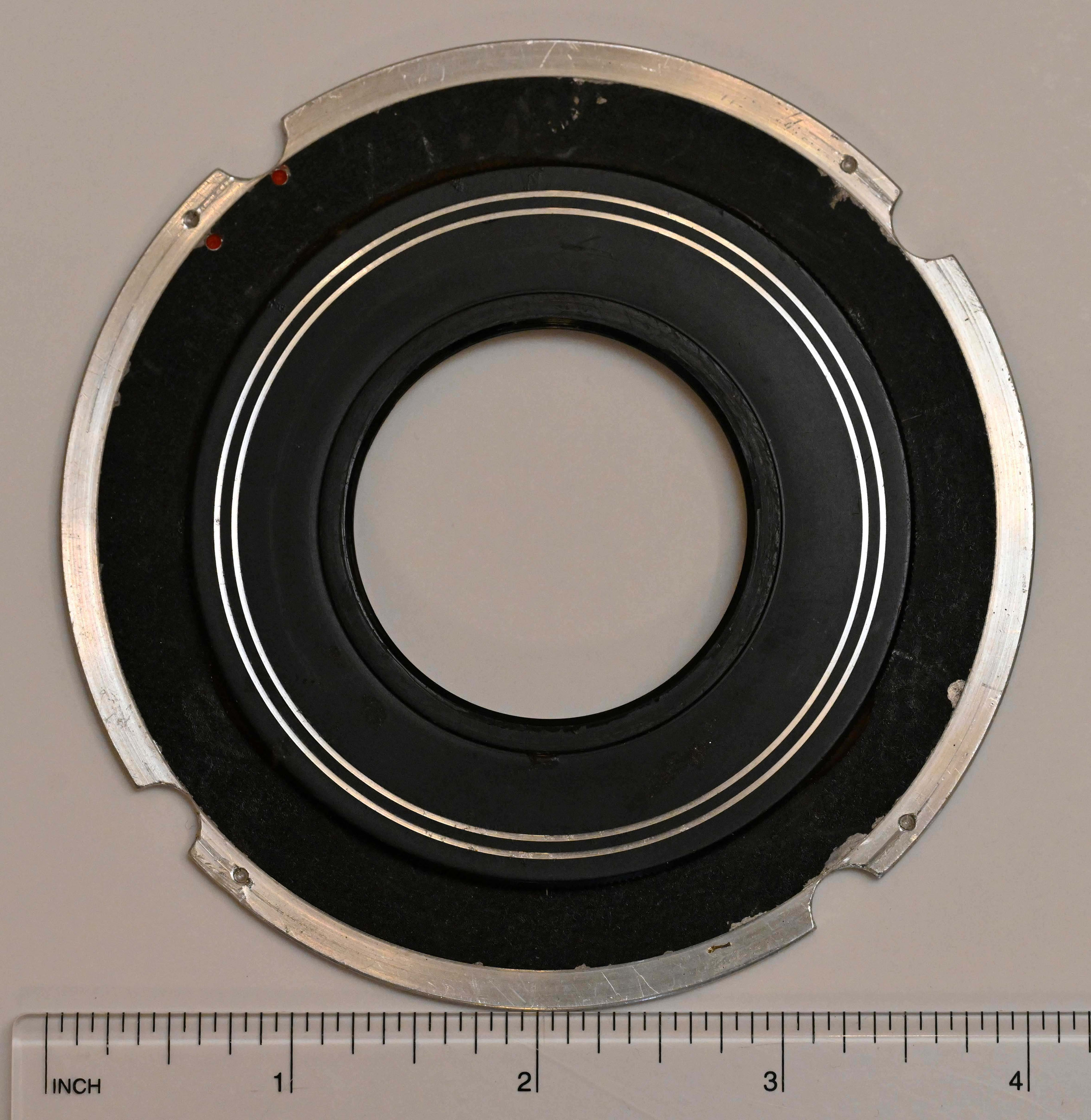

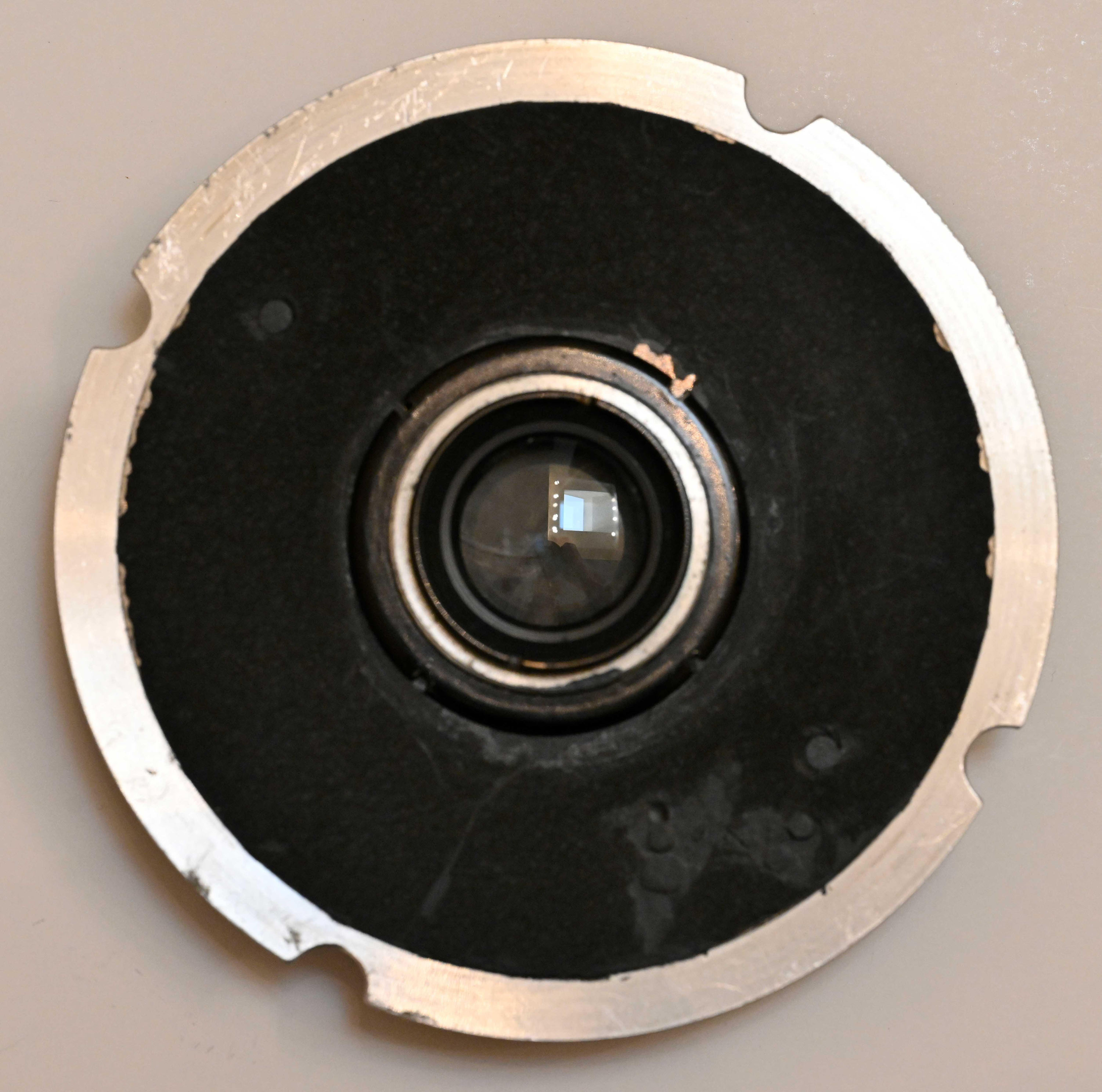

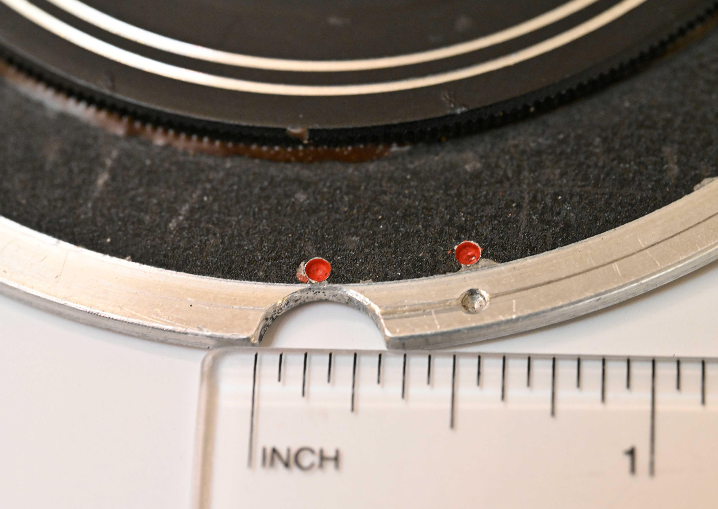

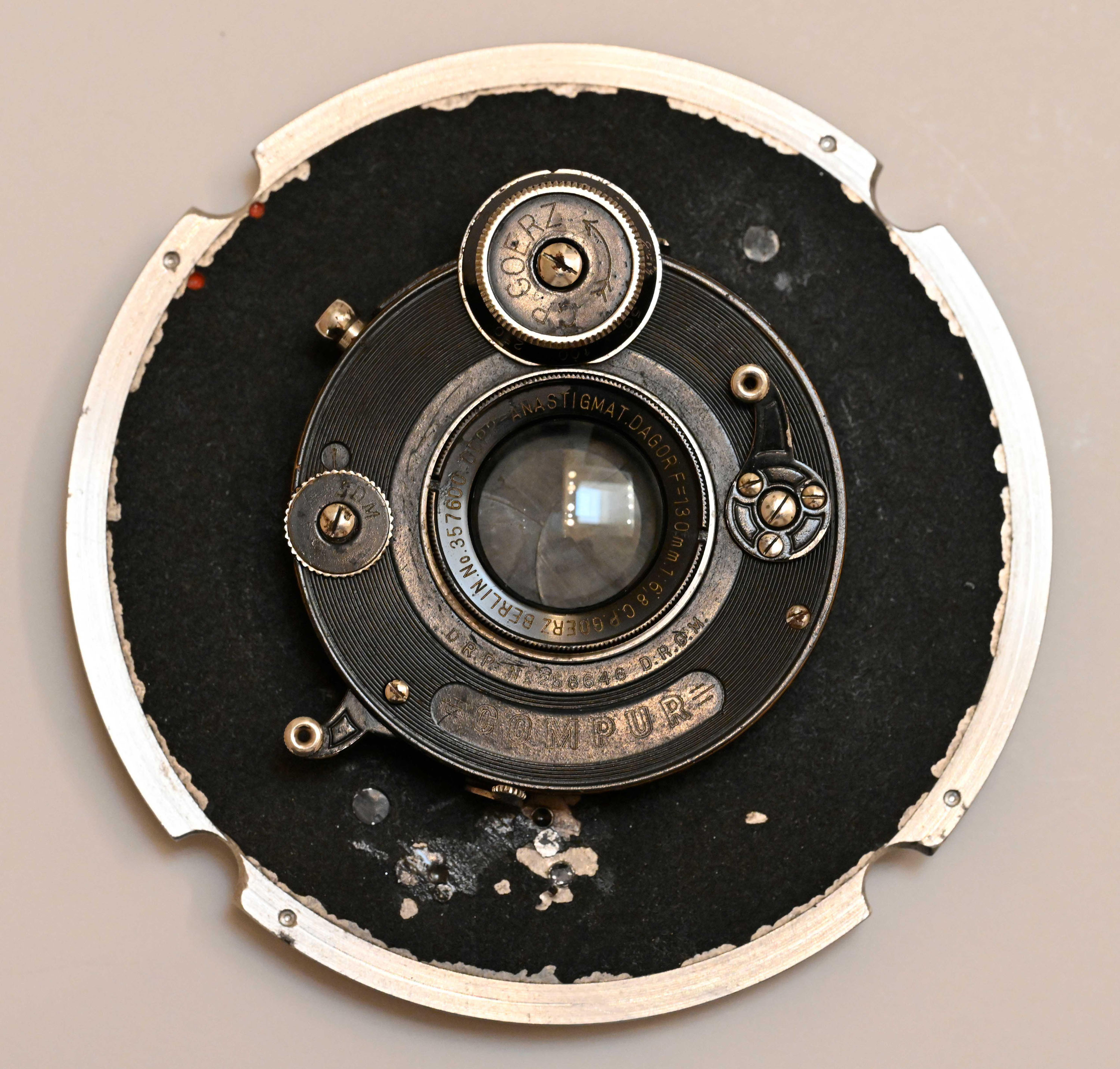

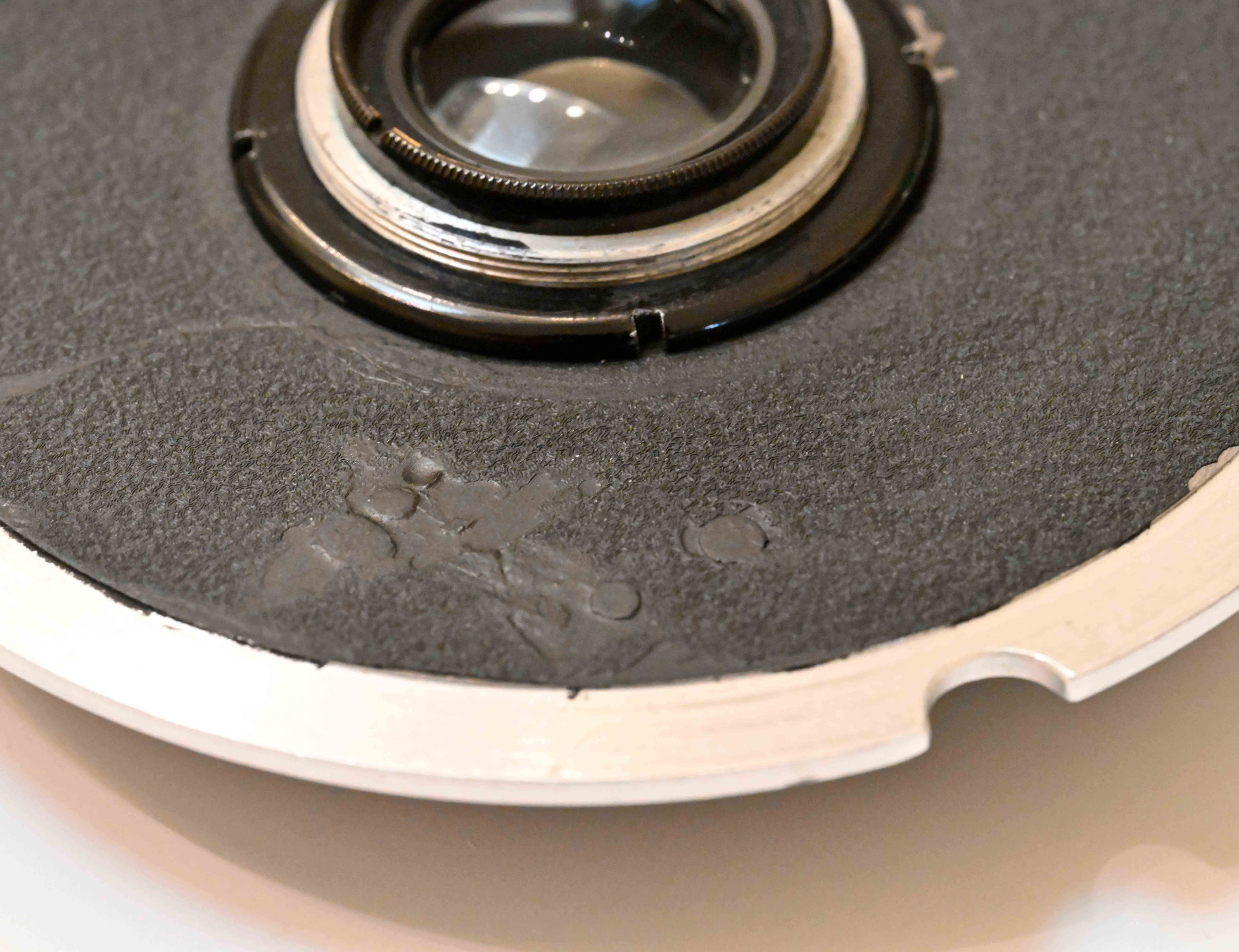

The two examples that I have are basically identical. Both are made of an alloy that looks like Aluminum or something similar. Both sides are generally flat and coated with a black crinkle (or wrinkle) paint texture. This center portion is just a hint higher (thicker) than the outer bare metal area. This may or may not be easily seen in the photos. Each cut out has a detent space.
Overall Diameter: 4 inches
Thickness (at the edges): 1/16 inch (0.0625")
The one that came with my camera suffers from a rather shoddy DIY epoxied threaded-flange monstrosity for who knows what lens/shutter combo. The epoxy is harder than the surrounding material so I doubt I would ever get this thing off without destroying the board. I happened to have just one lens that would fit the hole on the only other lens board I've found so far. It mounted nicely after I filled five or six holes someone drilled in that board for various other flanges.
If I were to attempt a DIY replacement, I'd probably start with an aluminum disc given how thin the material is along the outer rim (locking surface?)
Hope that helps!
~ Tre
