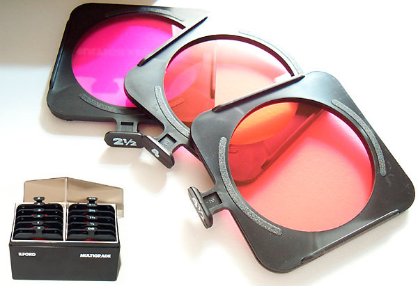

The filters are these:
here we can see the holder.
I thought that the holder and universal or almost universal. I got the filter set from a old lab that was deactivated but the holder was on the enlarger (a durst 1000) that I couldn't buy since I was property of the University and they don't sell and it still rotting in a corner...

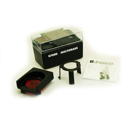

i didn't realize you had the filter set with the plastic frame, sorry for the misunderstanding. Part of the set is normally a holder that is attached to the enlarging lens and allows inserting the filter disks. It is part of the package, maybe you can recheck with the place where you bought the filters if it is still there. See the picture below.
One more thing, as you bought the filters used, make sure they have not bleached, because they do bleach when used a lot. I assume it is possible to replace the sheets in these holders, so open them carefully and check if color in the middle has bleached compared to the color in the part that is usually covered by the plastic rim. The filters will not bleach by themselves but from the light of the enlarger, so the filter grade that are used most (#2-#3) are most likely to have bleached. If yes, the filter has to be replaced, unfortunately they are not cheap and AFAIK only available as complete sets.

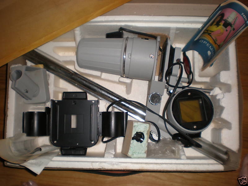

The Meokolor adapter for the Opemus is mean to allow using color correction filters with the III and a couple Axomat enlargers. It has a heat filter and a drawer that'll take 7x7cm filters but not the Ilford or Kodak set with the tab handles. You can see one in the set photo below.
Aside from making your own holder (a little cardboard and double-sided sticky tape would work), you could adapt a swing away holder from another enlarger to replace the red filter on the Opemus. The holder for the Beseler 23C looks like a good candidate. There are a couple on ebay right now for about $10.
