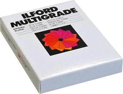

Hi I was wonderingif anyone might be able to help me I have a Meopta Opemus iii Enlarger. I amusing Ilford Multigrade IV RC Deluxe paper am i meant touse a filter in my enlargerto go with the paper and if yes where would i getone from that would fit the enlarger i have .at the moment my pictures don't seem tocome out correctly ever to light or to dark. I do use a Kodak Enlarger scaleHope you can help

The way I use the MG filters in my Opemus enlarger is I have a set of above the lens filters which I had to cut to the size of the filter draw, Master the art of the test strip, and remember that with the MG filters grades 00 to 3 1/2 use the same exposure and 4 to 5 increase the exposure by a stop, as far as the makes of MG filter, the widest available are made by Ilford, and you can get sets for above the lens in 2 sizes, get the smallest size and cut to the size of the filter draw, or get a set of below the lens MG filters, which are much more expensive, and fit in a holder mounted on the red filter spigot, I find the above the lens works fine for me.

I had a Opemus IIa for many years, and I used Ilford below the lens filters. This worked very well. As mentioned above, the Ilford website contains a lot of good information.

not sure if you can help me as i have bought and received Ilford Multigrade Filter Set, 8.9cm, Below Lens filter set but i cant get it to fit my lens the enlarger i have is a Meopta Opemus 3 and the lens it uses is a Meopta belar 4,5/75 234238

You may find these ones easier to use.They can be found for very little money and just need some small trimming to fit in the draw.I tried the under lens filter on my meopta 6 and found that it did not fit well.
