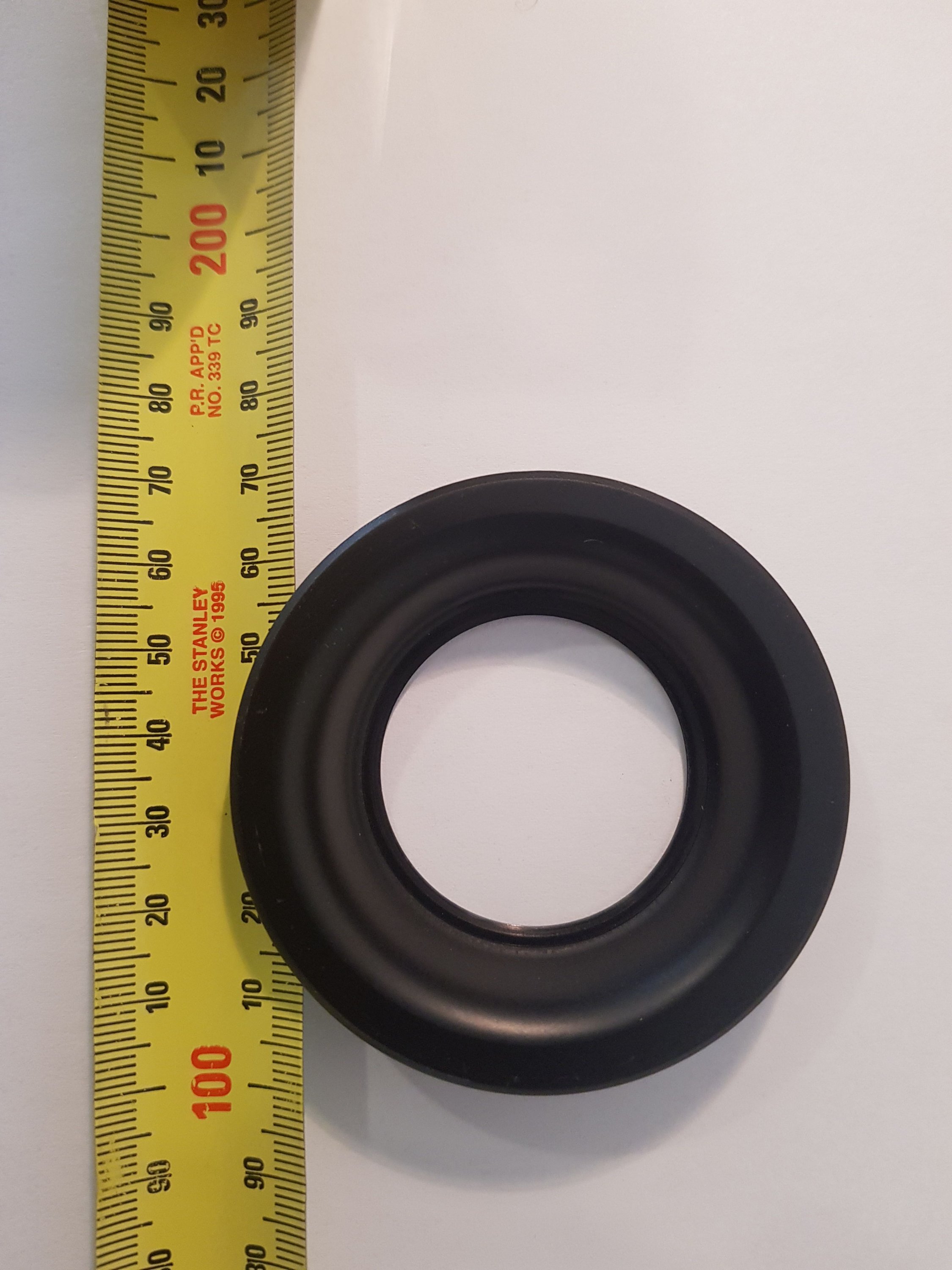

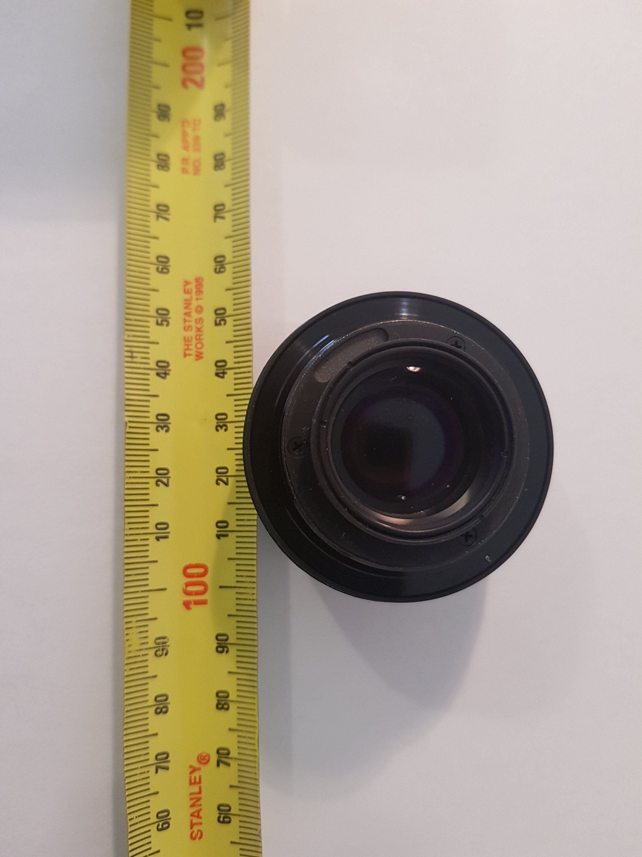

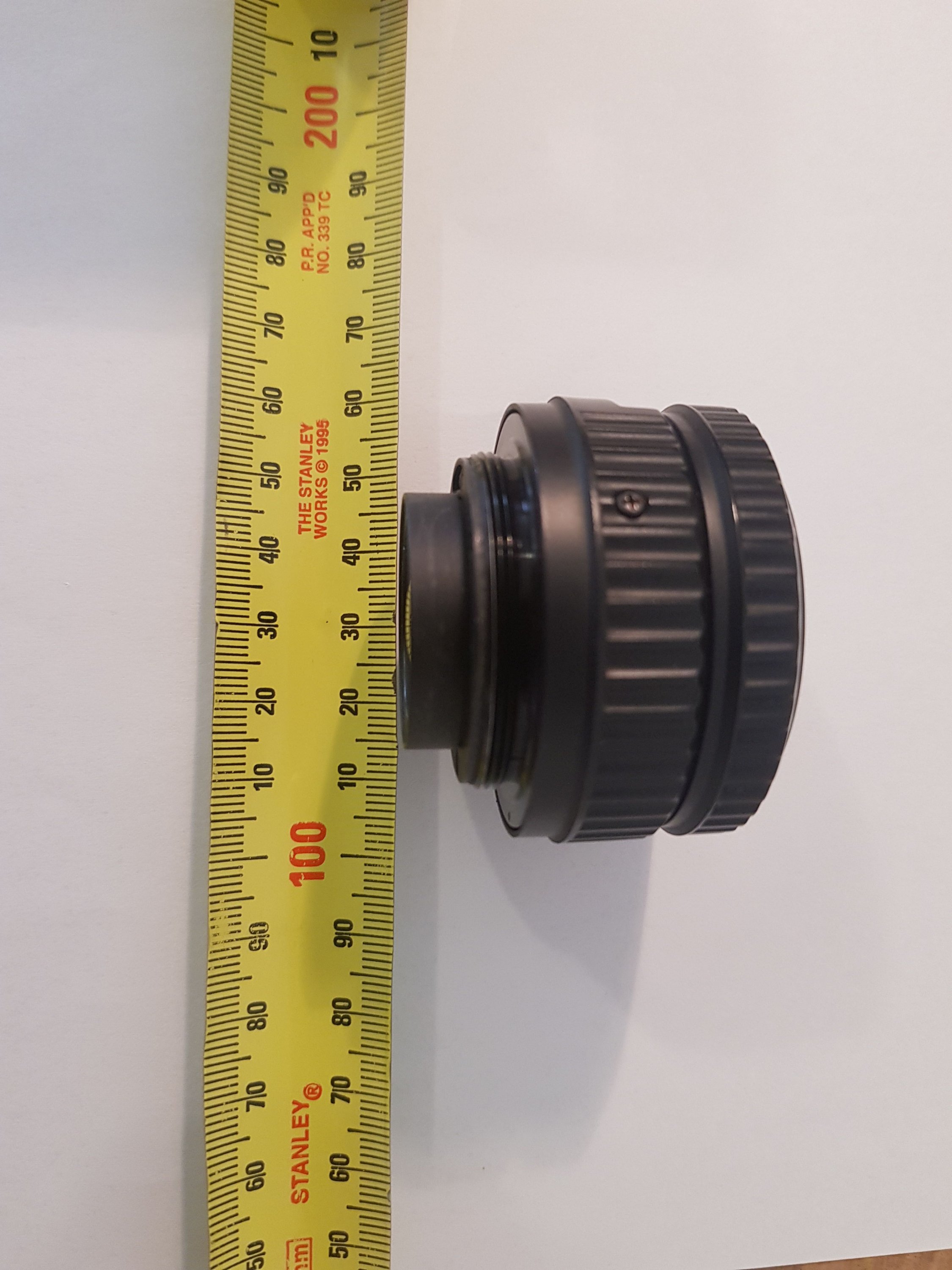

Aug 17, 2020
25
Australia
My Rokkor lens has an OD of about 55 mm.
Hmmm... mine has an OD of 50mm, but that is only 5mm from the top of the lens thread. I've upload photos of the lens and my lens mount. Perhaps it's the profile of the lens.
Dec 24, 2016
390
Asturias, Spain
Aug 17, 2020
25
Australia
That's really strange that you have trouble fitting it inside the lens carrier. My Rokkor CE has a similar profile, is 10% wider and gives me no problems. ???
Thanks Martin for the providing a comparison. The threads on lens need to reach about 3mm further into the dish of the lens carrier. I am wondering what it would cost to get a another lens carrier machined up. They're not exactly complicated.
