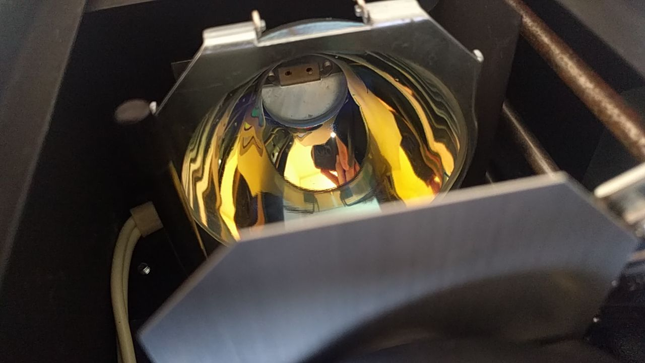

Hi Tom, good to know that 3400K lamps are fine. My head takes lamps without reflector-though it is possible to take out the head's reflector and I suppose you can put lamps with reflector in it. Attached a photo of the lamp house.

I see. I'd be tempted to keep the head as is, at least for the time being. RK Photographic in the UK might know as they distributed the Meopta products for a long time - www.thedarkroom.co.uk

Good news - the materials I bought seem to work, and the enlarger is now powering on and shining light!
I have two new problems arise now:
- The light takes quite a while to come on and power off. I think this is due to self induction in the transformer and I can probably work around it.
- The light that comes out of the enlarger is tinted distinctly yellow. This seems to be a repeat of [this] problem with exactly the same color head that came up a number of years ago. This mainly affects my ability to get blue light out of the enlarger; it stops at a rather weak and muddy blue light. I don't know how big this issue actually is all things considered but I have enough pointers to try and work it out myself should it cause problems.
For now I'm happy to know it actually powers on.
Summing up: A GY6.35 bulb fits, but felt a bit tight. Maybe G6.35 is better. For the transformer, I took a regular 105W 220v - 12v transformer and that seems to work but the light comes on and turns off slowly.
Thanks everyone who replied! See you around.
A 220V > 12V transfomer has too high voltage output with 230V mains of today,
The transformer says 220-240V; if anything the voltage is lower, I measured it and my (very cheap) multimeter told me it's about 8V under load.
It should be 12V under load.
There is no need for discussing colour-temperature of a certain type of lamp if the feed voltage is wrong.
I get typically 230V (today though 228V)
The 5% voltage rise I hinted at above in general is nothing to worry about, but with lamps that already are overated such can further strongly reduce longevity, thus rare lamps I only feed via a preceeding variac.
