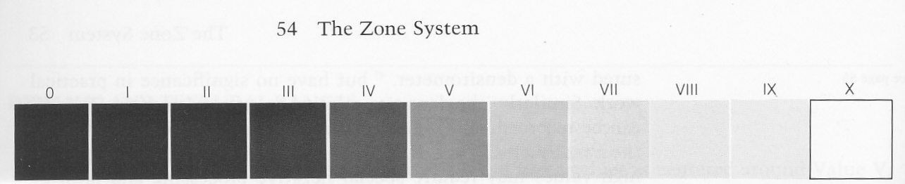

Looking at a tonal scale in a book about the Zone System, it is the center of the range of tones between white and black, what is referred to as Zone V in a range of zones from zero to 10. In luminance units Zone X has 512 luminance units while zone I has 1 luminance unit (zone 0 has 1/2 luminance unit) Zone V would have 16 luminance units. Each zone is said to be separated by 1EV difference from the adjacent zone, or double the previous zone's number of luminance units. The 'dynamic range' lies from Zone 1 thru IX, not 0 thru X.

Here's an interesting thought about medium gray. Some people say it should be 18% reflectance. Some say it should be 12.5%. How does this map onto the zone system? If we put it 18% reflectance at zone 5, then we get zone six at 36%, zone 7 at 72%, and zone 8 at 144% reflectance. This means that (assuming one limits the discussion to diffuse reflections), the most you can get is zone 7.5 in a scene, and that would be for a perfectly white diffuse reflector. Anything higher is a physical impossibility, that is unless one brings specular reflections into the scene.
If one picks 12.5% as medium gray then in the absence of specular reflections the most one can get in a scene is zone 8 unless one brings in the possibility of specular reflections.

Uh-oh, we have a blurring of two different concepts! 1) tonal range in reproduction vs. 2) density upon which reflected light meters are calibrated
  1. In the Zone System, it is Zone V which is 'middle gray' which is the midpoint between absolute (detailess) white and absolute (detailless) black -- 18% density is the midpoint between 0% and 100%.
  2. If one looks at the ANSI standards for calibration of reflected light meters vs. calibration of incident light meters, one can equate 12.5% as the reflectivity target which will result in 'same exposure' from either type of meter
But even THAT (#2) is debatable because the ANSI standards themselves allow the meter companies to choose a VARIABLE value to use in the equations. As a result, 'your results may vary'. For example, my Minolta Autometer Vf incident meter gives an identical reading to what i get if I aim my Minolta Spotmeter F or my Canon 40D at the same 18% gray card! So what happened to 12.5% here?!?!?!
