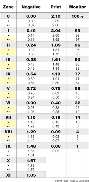

I aim for 0.75 density for Zone V in a print. See attached:

Let's see the numbers. What reflectance are we calling zone VIII for instance?
Look at the table in post #26 and use the following equation to calculate the print reflectance:
R = 1/10^D
where D is the reflection density. For example, Zone VIII has a reflection density of 0.09.
R = 1/10^0.09
R = 1/1.2303
R = 0.81283
R = 81%
Thanks for posting that Ralph.
What I'd say is that print may look too dark to me (based on how I have been printing lately). If the Dmax is 2.10 and Zone I is 2.04 with my print viewing lighting, those will probably look the same to me.
Another interesting thing your chart brings out is the ambiguity as to if the zone's reflected density is defined at the junction between the zones or in the middle of the zone. In your case the 0.5 density is in the middle of zone V.

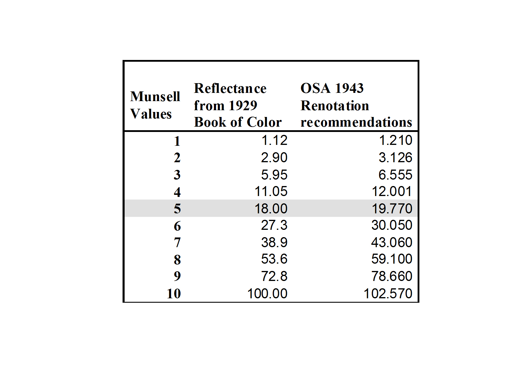

Color is a psychophysical phenomenon. We don't see tones in a linear way as Ralph's reference to Fechner describes. Munsell found that 18% was the perceived middle gray using a 10 step scale. In the early 1940s, the Optical Society of America's Committee on Colorimetry, chaired by Loyd Jones, found it to be 19.7%. They published their findings as a book sometime in the fifties under the title The Science of Color. I've attached a comparison of both scales.
Ralph, am I correct in assuming your equation comes from CIE? Could you break it down more and define the source of the variables?
