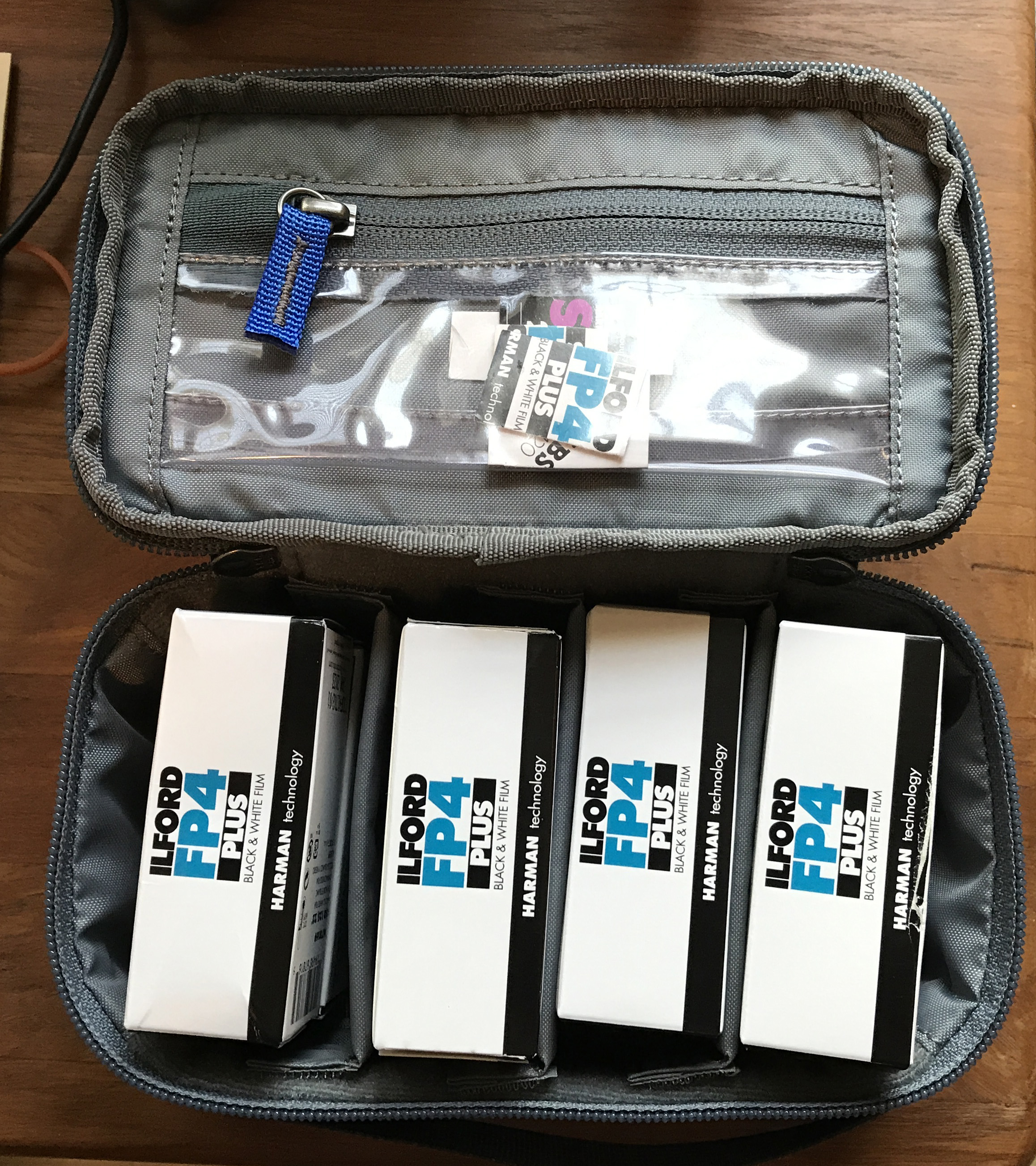

Super8
I find this case from MindShift, meant for a GoPro, is quite handy while traveling. It holds 8 rolls of film boxed or not.
