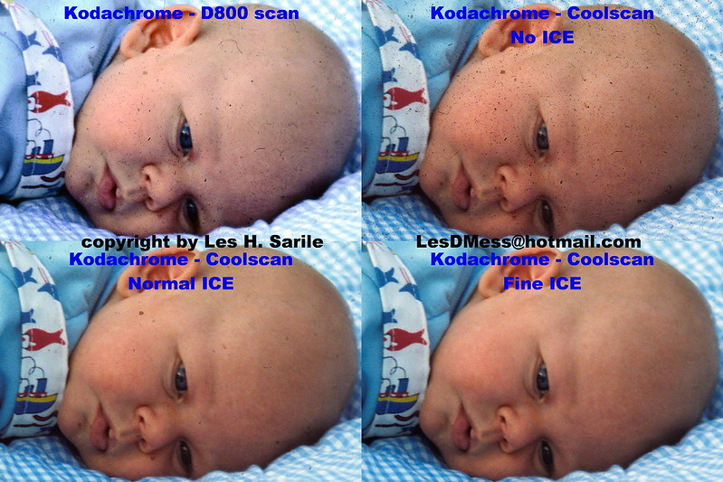

Is ICE worse or better than cloning out spots in Lightroom?
@_T_ makes a good point. There's a practical reason for why a $15K Flextight offers "only" 8,000x8,000px for 6x6 scans. Sure, you won't be able to enjoy the intricate details of the grain character 10 inches away from a 32x32" print. But if you're into that flavor of pixel peeping, maybe you shouldn't be shooting medium format to begin with? :smile:
Not all ICE is created equal. But I remember Nikon's implementation to be pretty good. Either way, I had to spend 10-30 seconds per scan to carefully review everything to make sure ICE didn't go haywire destroying detail anywhere. That reviewing time was comparable to the time it takes for light Photoshop healing, so there's no time savings. The other scanner I had, maybe it was Plustek, was much worse.
But my big point regarding ICE is that if you need it, you're doing something wrong. You shouldn't have any dust on your negatives to begin with. It's not hard to maintain film handling hygiene that removes the need for this. In fact, I would argue that most scanners are dust magnets themselves, especially flatbeds. So they create the dust problem to begin with, and then use ICE to mitigate it. Camera scanning is much cleaner, it doesn't add any dust on its own (my film holder is metal, with anti-static cloth on both sides)
But when scanning archived films, ICE is a GODSEND. At least the Nikon's implementation, as it took care not only of dust but also scratches.
Here are my two best examples of very scratched and ingrained dirty film. The first is 60's Kodachrome scanned with a D800 and Coolscan 9000 with no ICE, Normal ICE and Fine ICE. The second is a frame of Kodak 160VC color negative that I scanned with a Pentax K20D (with my attempt of color negative conversion) as well as the Coolscan with no ICE, Normal ICE and Fine ICE.
Kodachrome D800-Coolscan by Les DMess, on Flickr
Kodak 160VC-06-36 K20D vs 9K ICE by Les DMess, on Flickr
The Coolscan 9000 + Nikonscan of 35mm adds about 30 seconds of overhead when ICE is enabled. So if you have the option, would you manually spot in post or enable ICE?
