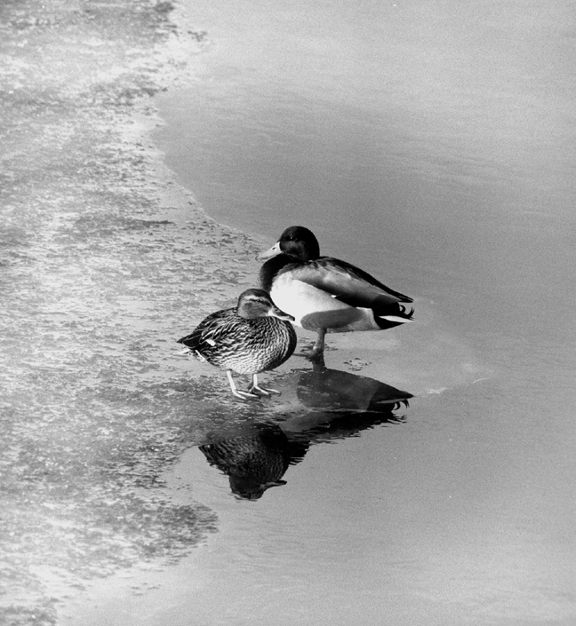

I used a exakta 66 camera 300mm Sonnar 2x teleconverter f5.6.
Jamie
